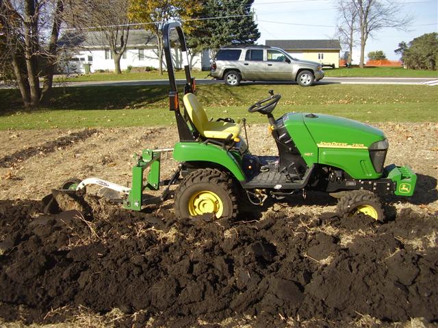

If any of you have more pictures showing some of the tuff work these things sub compact tractors can do, I would love to see. You look at all the brochures from the dealers and all it shows is a few bags of potting soil in the loader and a few potted plants. I see that and think, is this really going to be enough of a tractor? Looking at the one picture of the 2305 with that large rock in the FL really says allot about what these little tractors are capable of. Most of my rocks are not nearly that size.

OK, here are some pics that I saved of 2305's in action...... hope the original posters don't mind:
