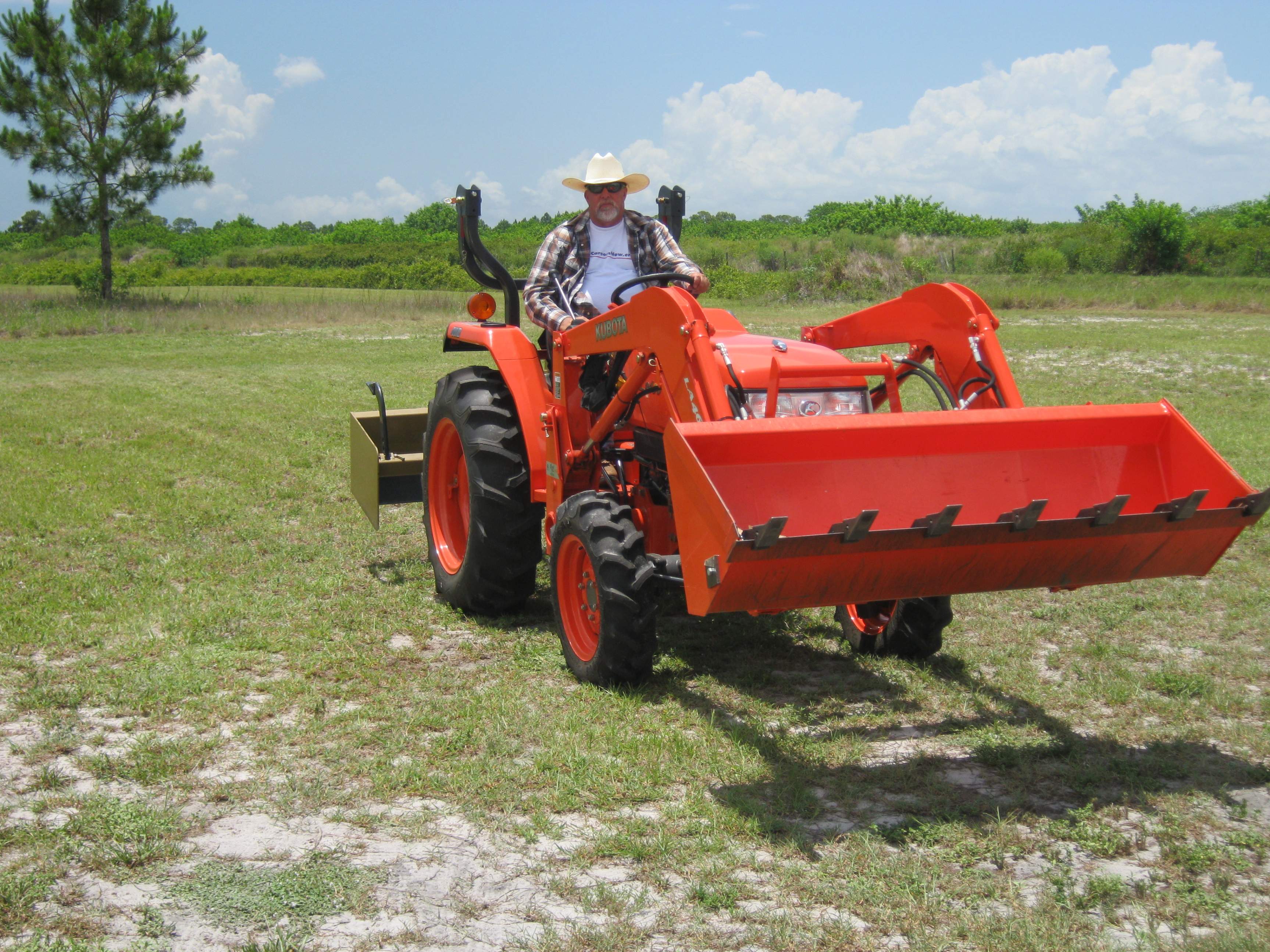

/ What Year is It??? #10
Hank :
Teg explained it better than I could have !
The extra sight glass I keep was a little under $13.
I have yet to replace mine makes me feel good to know I have an extra.Also it was the only one my Bota dealer had left in stock at time of purchase.
Boone
