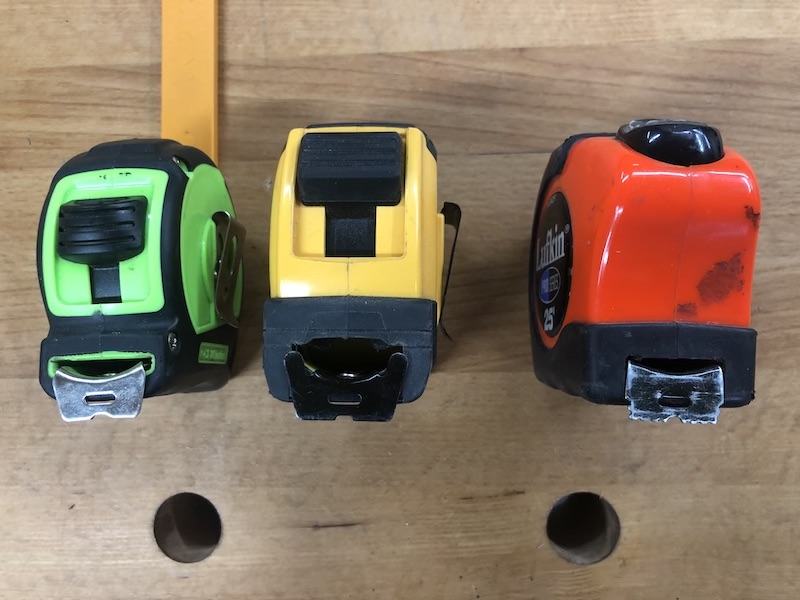

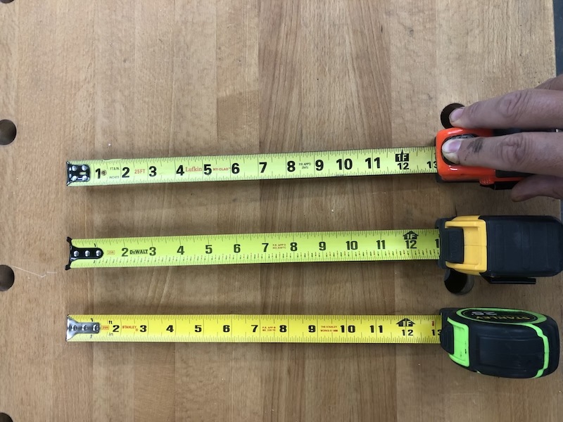

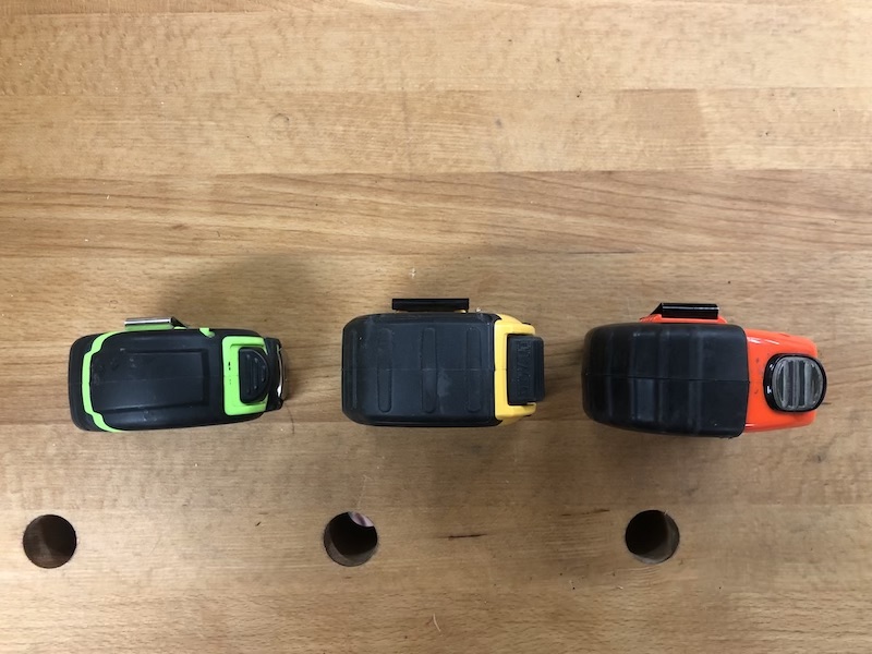

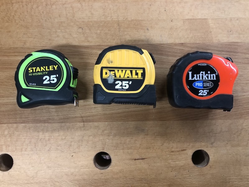

This thread made go out to my shop and look at three of my 25ft tapes. The Stanley and Lufkin measured 0.90in wide and the Dewalt 1.0in wide. Extension without breaking being as careful as reasonable netted me 8ft for both the Stanley and Lufkin and the Dewalt got me 10ft.
The thinnest body was the Stanley along with a more yellow tape color. The Dewalt has a labeled fractions scale as well as the standard rule and the biggest tape 'hook'. The Lufkin lock needs to be continually be pressed to keep it from retracting and has been that way. since day one... don't know if that is by design. I find myself grabbing the yellow one if there is more than one within reach.
If I go to the store or other places where I might use a tape, these all stay home. I use an old Stanley 12ft that I keep in my truck center console that is easy to slip in my pocket.

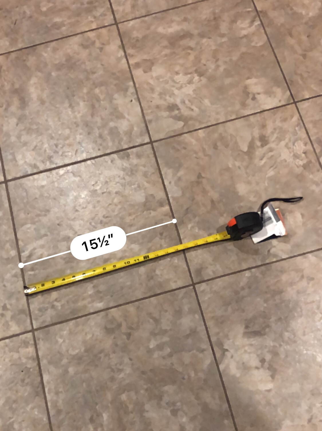

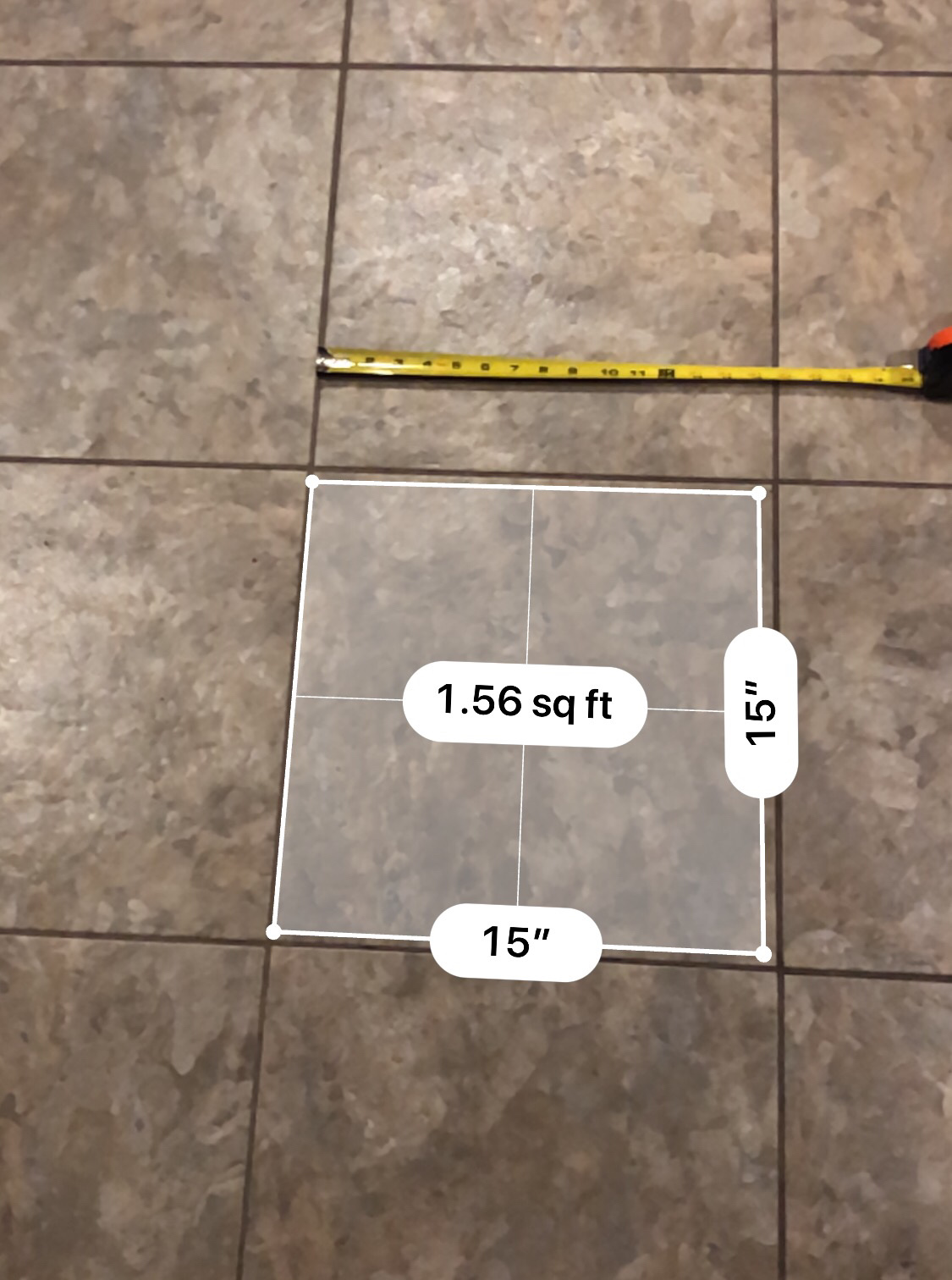

Another handy on the go app for your iPhone is called 'Measure'
Also has a built in one way and surface bubble level.
