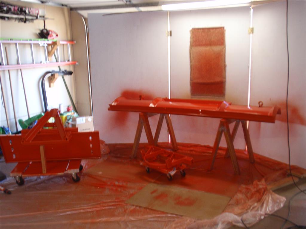

What does the turbine do?
It's a different system. You have a blower unit that is self-contained and usually runs off of regular 120V electric. It is a lot cheaper to buy a good turbine unit than it is to get a compressor big enough to supply true HVLP air quantities. Most HVLP run off compressors (except major industrial setups) are only pseudo HVLP as it takes a very large compressor to keep up with the volumes needed (even stepping down the pressure). I picked up a FUJI turbine a few years back. I run it in my garage with a pseudo spray booth I rigged up with a fan, so I can only do it in decent weather. Here is a shot of it below. The brown patch is the spray booth filter, and the fan is mounted behind it.
http://www.fujispray.com/hvlp-systems/
