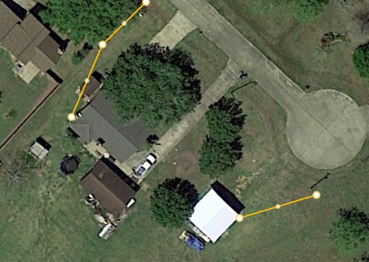

I understand better what your challenges are. With the wire as high as you're putting it, I would think you should be able to just run SE cable (Service Entrance cable) I'm not a licensed electrician, but I think the SE cable is rated for UV exposure and you wouldn't need any conduit for it, just tie it to the carrier and it'd turn the corners how ever they need to be. I've never used that black poly pipe, but that sounds like a soloution for the water. For an air line there is a product from Rapid Air Compressed Air Distribution System | Rapidair | Engineered Specialties where you can get up to a 300' coil that appears to be outdoor rated (I've not checked it out). But do you really need an air line? Why not use 2 compressors or a portable compressor? It might be cheaper.
Yes That's what I plan on. SER cable, no conduit. Sorry for being unclear. No conduit is/was planned for the electrical.

I've set a pole and stretched a carrier wire from my house to my barn in anticipation of running power from the house to the barn. On the same wire I'd like to run an air line from the barn to the house (for convenient tire air in the driveway) and a water line from the house back to the barn for a sink. I thought PEX tubing would be perfect as it's semi-flexible so as to follow the catenary droop but rigid enough not to kink or be choked off by the straps holding it to the carrier wire. But unfortunately I just learned that it's not UV resistant and therefore a bad choice for outdoor use. So what else is there? I suppose I could use plain garden hose for the water but what about the air?

Remember, he already has air in the barn that will run from the new power line from the house. The water goes toward the barn and the air goes toward the house, opposite directions. The new air line is to get air to the house without the noise of a compressor at the house. Or the cost of a second compressor for the house.
As I understand it: Water and a new power line to the barn. Air back toward the house.
Too bad it can't be underground, but that seems to be out of the question because of the septic. So the overhead makes sense if the right materials can be found.
I don't know how to mount the electrical cable with three conductors, a water line and an air line, such that they don't chafe on each other or against the mounting system over time. Maybe all of them bundled in a 2" poly pipe?
That's an option. The phone company uses a spiral wrap to attach their multi conductor cables to the carrier wire with a special machine that travels and rotates. I would think that zip ties every 6 to 12" would work. They're cheap from HF and can be done one at a time and replace individual ones if needed.

For wire I would use aluminum, they sell 4 wire twisted cable that gets used for mobile home installation above or below ground. About 1/3 of copper!
Also semi's us a plastic 1/2" air line that handles all types of weather. One brand is "Synflex" .
Your understanding is correct.
As for chafing and bundling I am still working on that. The 2" poly pipe idea is intriguing, I'll look into the cost. I would like to keep it accessible for if I need to access the bundle to replace a pipe or add a cable or something. I was thinking some velcro straps every foot or so, but I don't know how effective that would be in preventing chafing as the wind blows and the cables/tubes rub against each other. Zip ties would be better in that regard.
