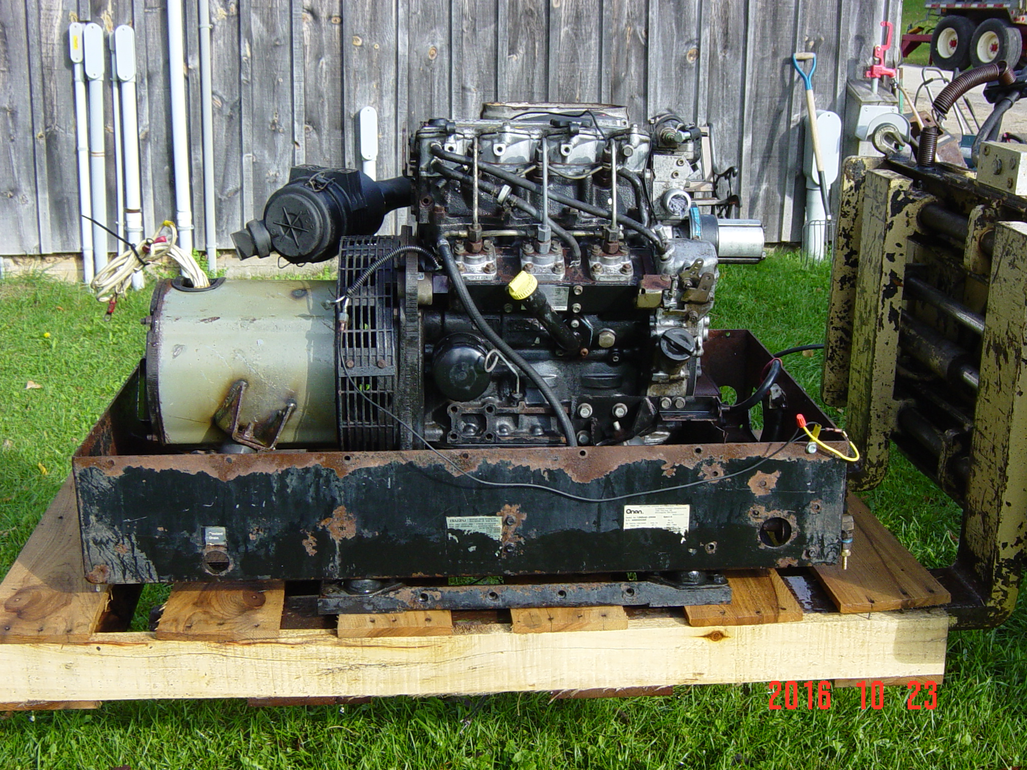

Not meaning to hijack, but I am in a pickle because my 4" LB that houses my airline in the picture with the fork leaning up against it, has ripped away from the building, either from frost or settling and I don't know what to do about it. DSC04384.JPG
