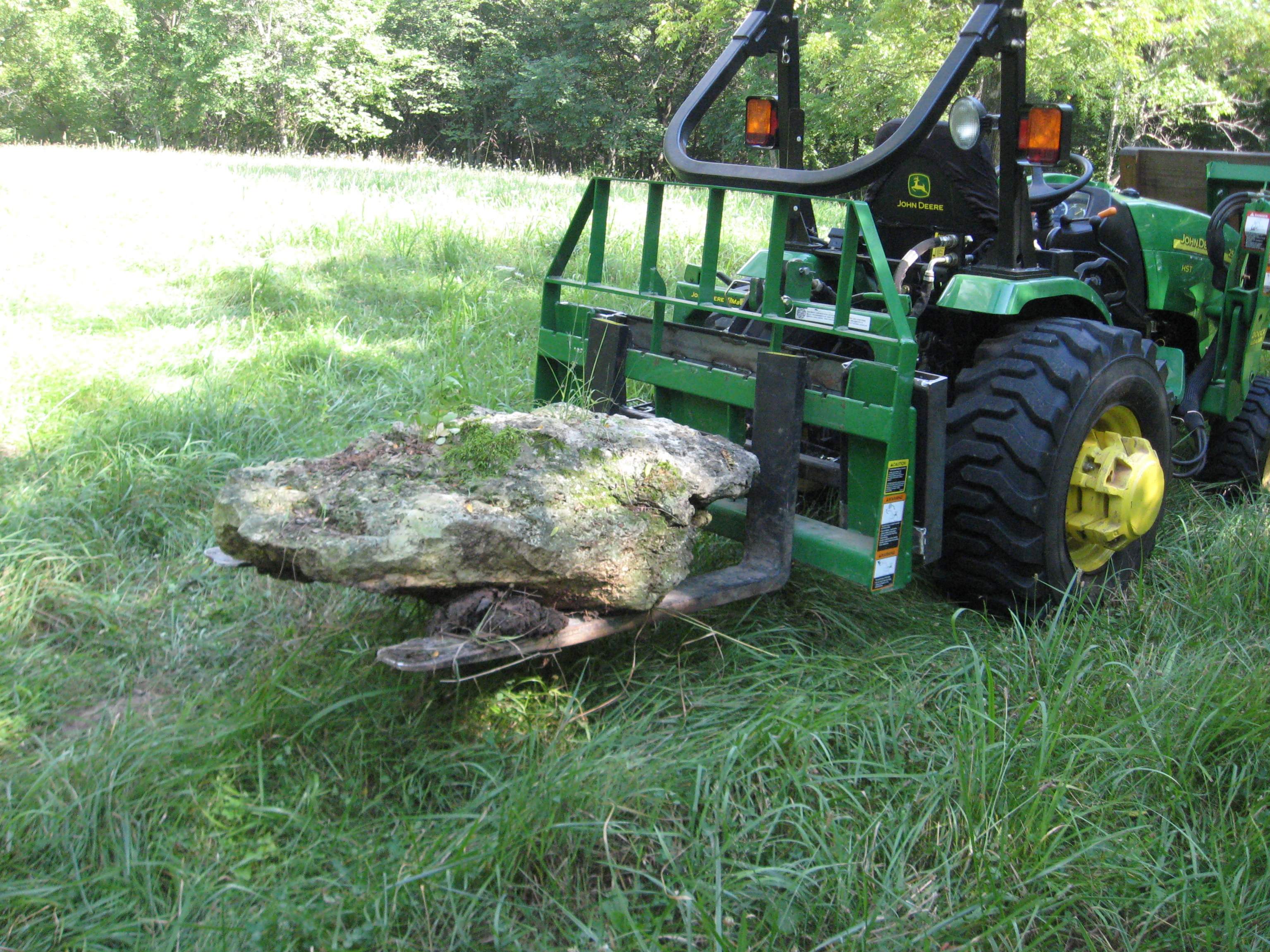

   / What's a good way to scoop up large stones? #28
I use my pallet forks. For the really large rocks, I mount them on the three-point hitch.
   / What's a good way to scoop up large stones? #29
Runner
That looks like a great way to move rocks. And with the HTL, you can even dig them out.
I've used my forks for rocks too, and have one now that the FEL won't lift that I plan to move soon with the forks on the 3 ph. It is a big flat one that I've only been able to skoot out of the way for now.
