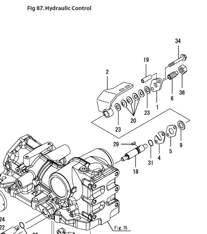

I have the rear remotes and the levers work more naturally and I don't think you will want to do anything to them unless it is for some little refinement that you personally like. On the other hand I really need to do something with the 3ph lever. Every time I get time to do something with the tractor I need to be working it not working on it. But the lever is getting stiffer to operate and I need to check into freeing it up a bit or change the leverage.
Does anyone know if the lever retention friction is adjustable or if it needs lubing or something. Only when it got a bit stiffer did I seriously think I have got to change the leverage and quit thinking that a change in leverage would be nice.

The lever assembly does include a Friction bolt, which is represented as #6 in the attached figure. Perhaps the friction can be adjusted by backing it off the nut (#36) a little? I'm not near my LX at the moment, but I'll take a closer look later...
