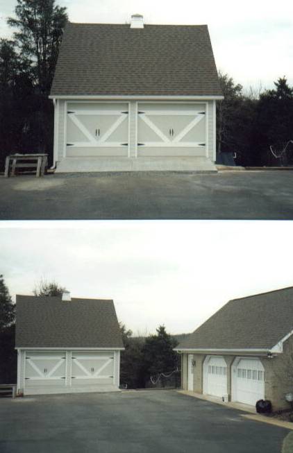

We built what we call our carriage house for $40,000 about 4 years ago. Contractor now says it would cost probably around $100,000. It's a 2 bay garage on top of a drive-out basement (where my JD is) with pool cabanas in the walk-out/drive-out end corners to each side of the double doors. Above, is a fixed stair access attic for storage.
I did the electrical and plumbing myself. Only regret is not putting in a "people" door in place of one of the windows on the main garage level.
Attached is a picture.
