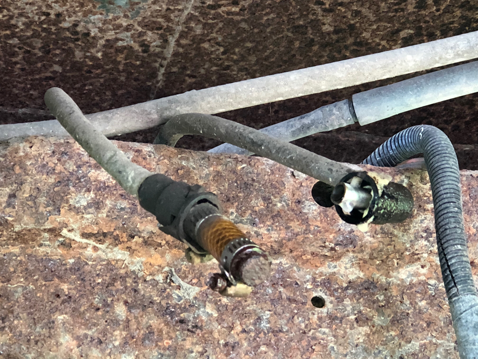

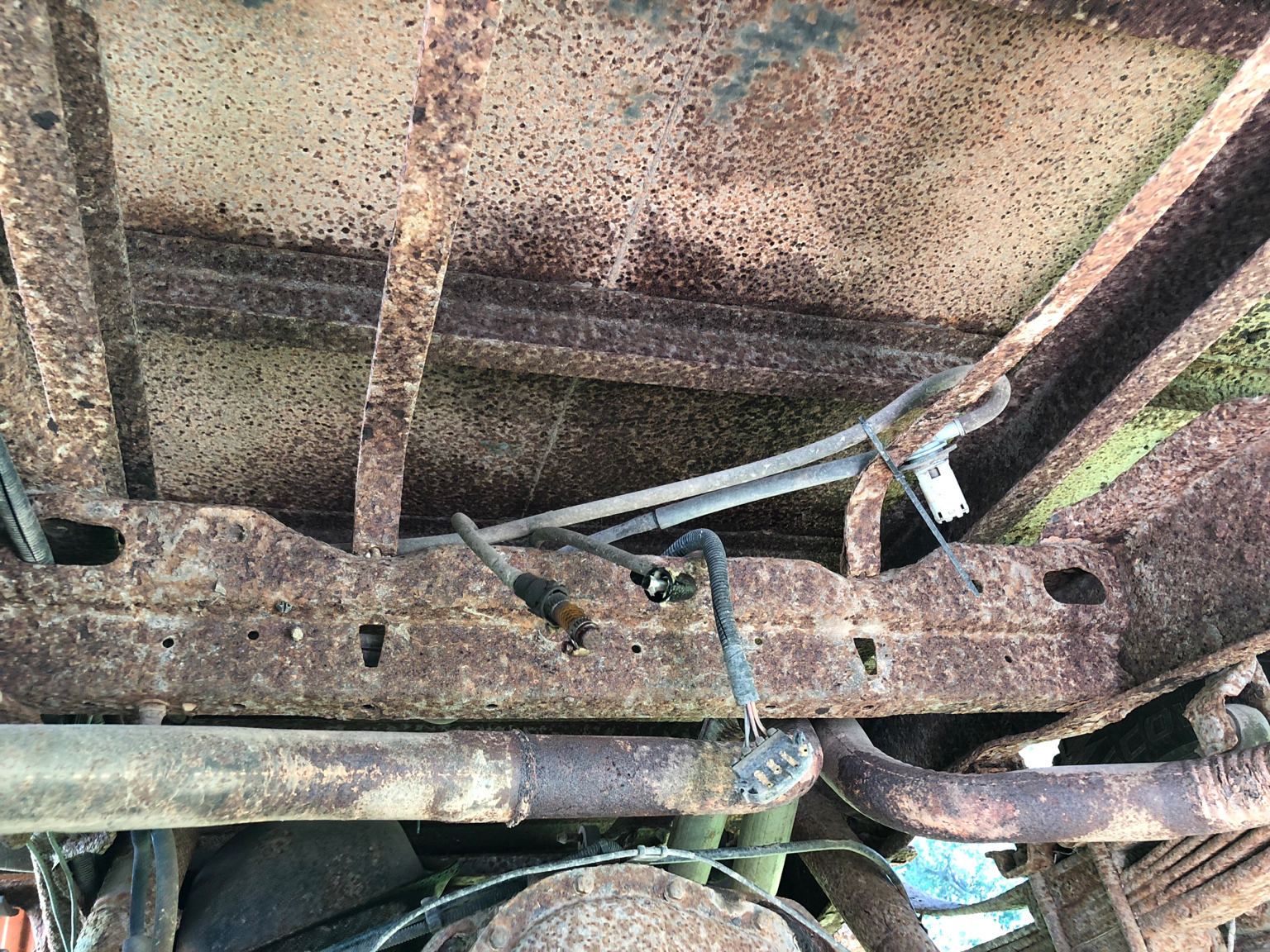

I didn’t see this issue the first time I looked at the truck but the truck had duel gas tanks at one time, someone took the rear tank out for whatever reason, left the fuel pump and all the lines tied up in the rear.
They had two other lines blocked off and one of those plugs blew off. IMG_8656.JPGIMG_8655.JPG
I cut both lines back after buying a few things from the auto parts store: IMG_8659.JPG
I spliced both lines together, fired up the truck and it ran rough, give it gas and it cut out so I redid it by using the barbed union and took some 5/16th gas line I happened to have in the barn on the other end of that brass union and a bolt in the end of the rubber gas line, truck runs good now and doesn’t leak any gas, I’m confident that this set up won’t ever blow off.
That gas line in the truck is a 5/16th rubber coated nylon and no matter what bolt or screw I stuck in there with a band clap around it, it just sprayed gas out, so I had to pick up the barbed union.
I may see about isolating the front tank better in the future, I have no plans on putting another tank in the rear but all the plumbing is there and the transfer switch in the cab works I guess.

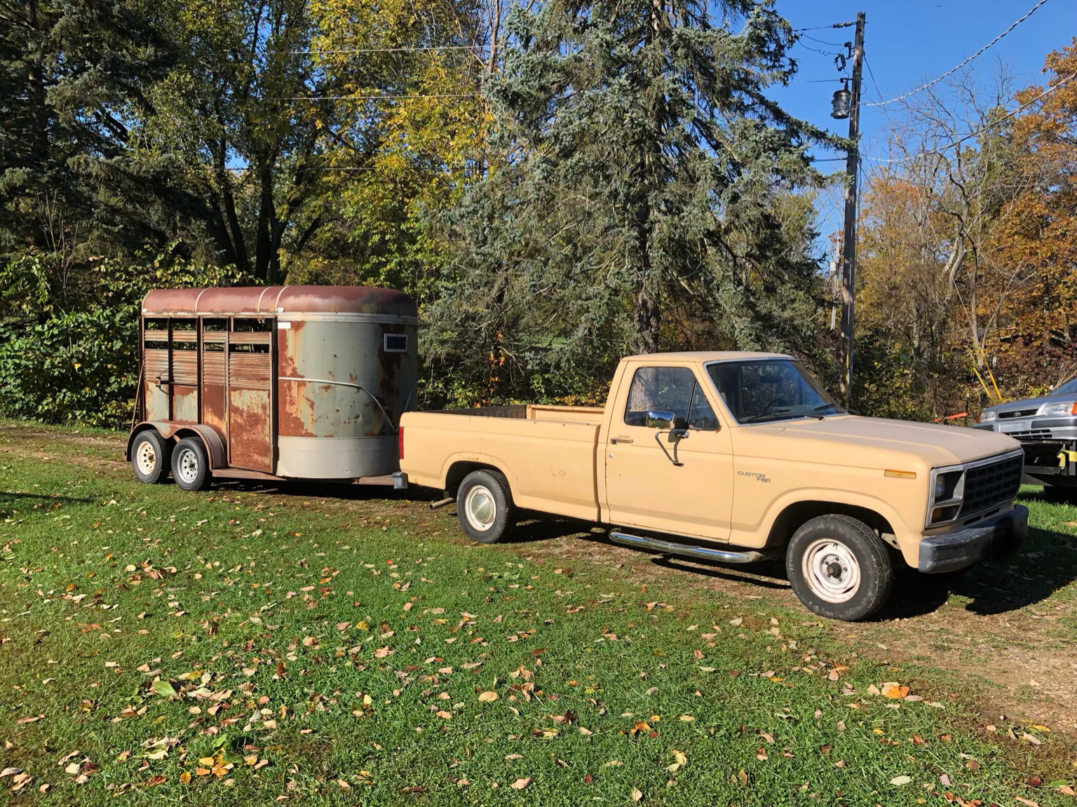

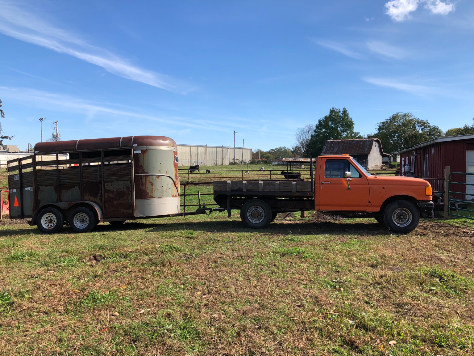

So much of an improvement over the F150, manual kinda sucks hooking up trailers though vs auto.
