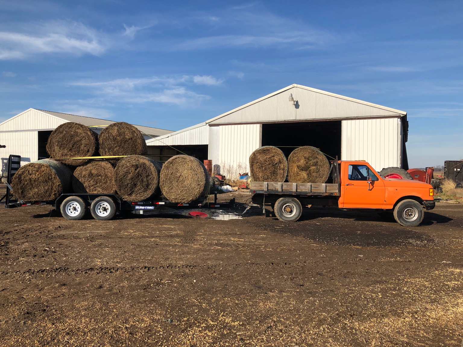

I got this truck with brake issues, a clutch issue, going down the road it was making crazy noises, had a few lighting issues and it broke down coming home.
I put a new serpentine belt, upper and lower radiator hoses, new oil cap, new radiator cap, two new knobs in the cab (lights and windshield wipers), new LED reverse and break/ turn lights, cleaned up wiring and redid a bunch of connectors, made my own bushing out of copper for the clutch peddle which solved all that prob, found a inner hub seal leaking on the axle, changed that out, got all the bleeders loose without breaking one off and bled the breaks and a master cylinder will be next weekend which will solve the break issue.
All this cost me like $250 and the truck will be mechanically sound. And I’ll be $1200 in a 2wd F350 flatbed with 148k miles, has the 10.25 sterling full floating 4.11 rear, 5 speed that runs like a top. Heck I’ll get more than that for the truck it’s replacing, my 81 F150. If the guy kept up on the small stuff he could have gotten a lot more money for the truck.
Truck has been super easy to work on so far, all the shoes and pads look new, rotors are in great shape, truck is mechanically in good shape just a bunch of small stuff that made it look worse than it was so the guy sold the truck.

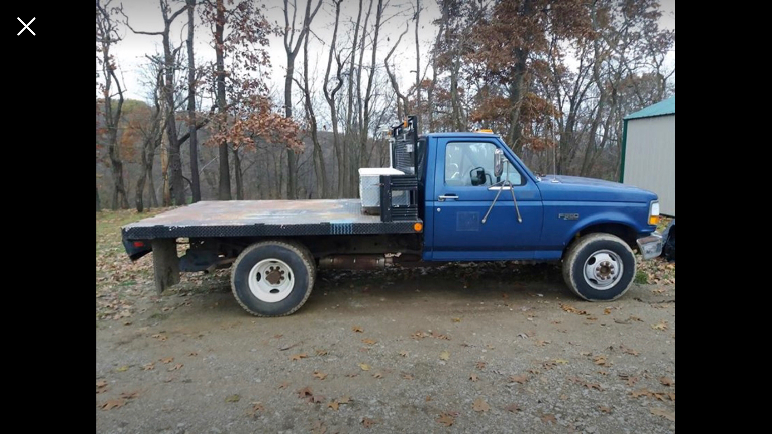

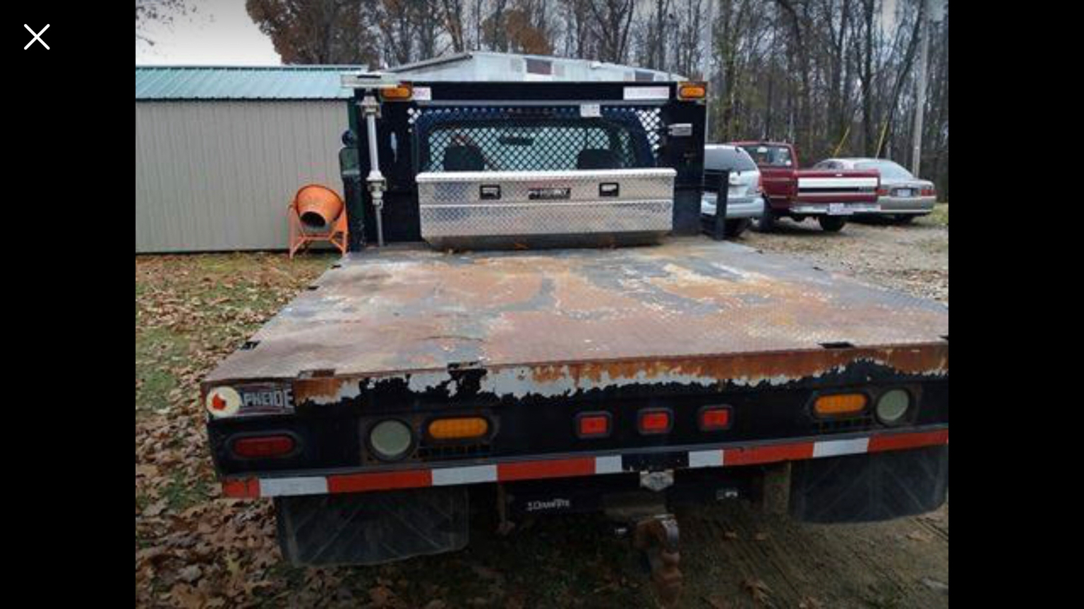

Went from way overloaded at 4 bales to hauling 11 bales and staying legal lol.
But turns out another truck drove itself to my house to replace the orange one IMG_9251.JPGIMG_9253.JPG
1995 F350 dully, 460 v8 with the 10.25 sterling with working limited slip rear, truck gets around SO much nicer than the orange truck, it won’t spin rear wheels for nothing. IMG_9271.JPG

Nice, 5-speed or auto?
Orange truck is a 5 speed with no parking brake lol.
Blue truck is automatic with working AC and the hottest heater I have ever felt in a truck lol. It was a city truck, has a hour meter on the truck also.
I have a hill in my back yard, my orange truck spins a wheel all the way up it no matter how hard you try not to, the blue truck didn’t even spin a wheel, it does a good job.
I’m into the orange truck $1400 as it sits, it’s now mechanically sound. I bought the blue truck for $1800, it’s got a few minor things but nothing to the extent of what I fixed on the orange truck. Hopefully I can sell the orange truck for around 2k or a little more.
