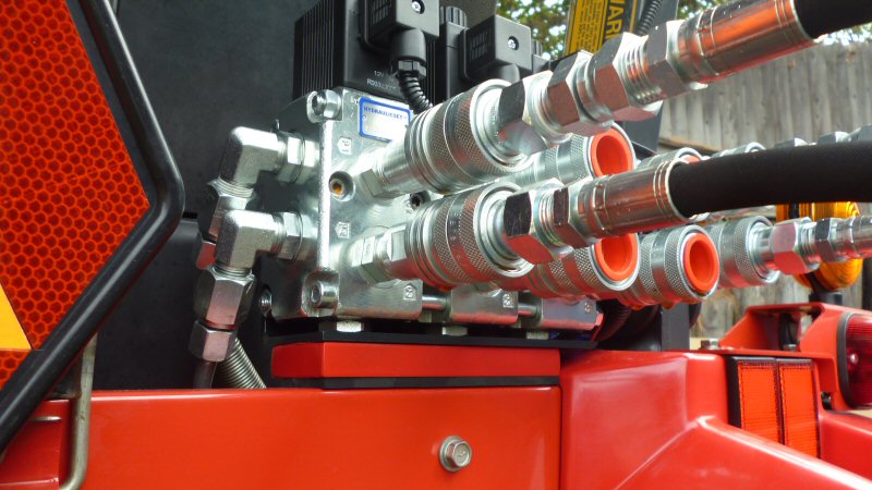

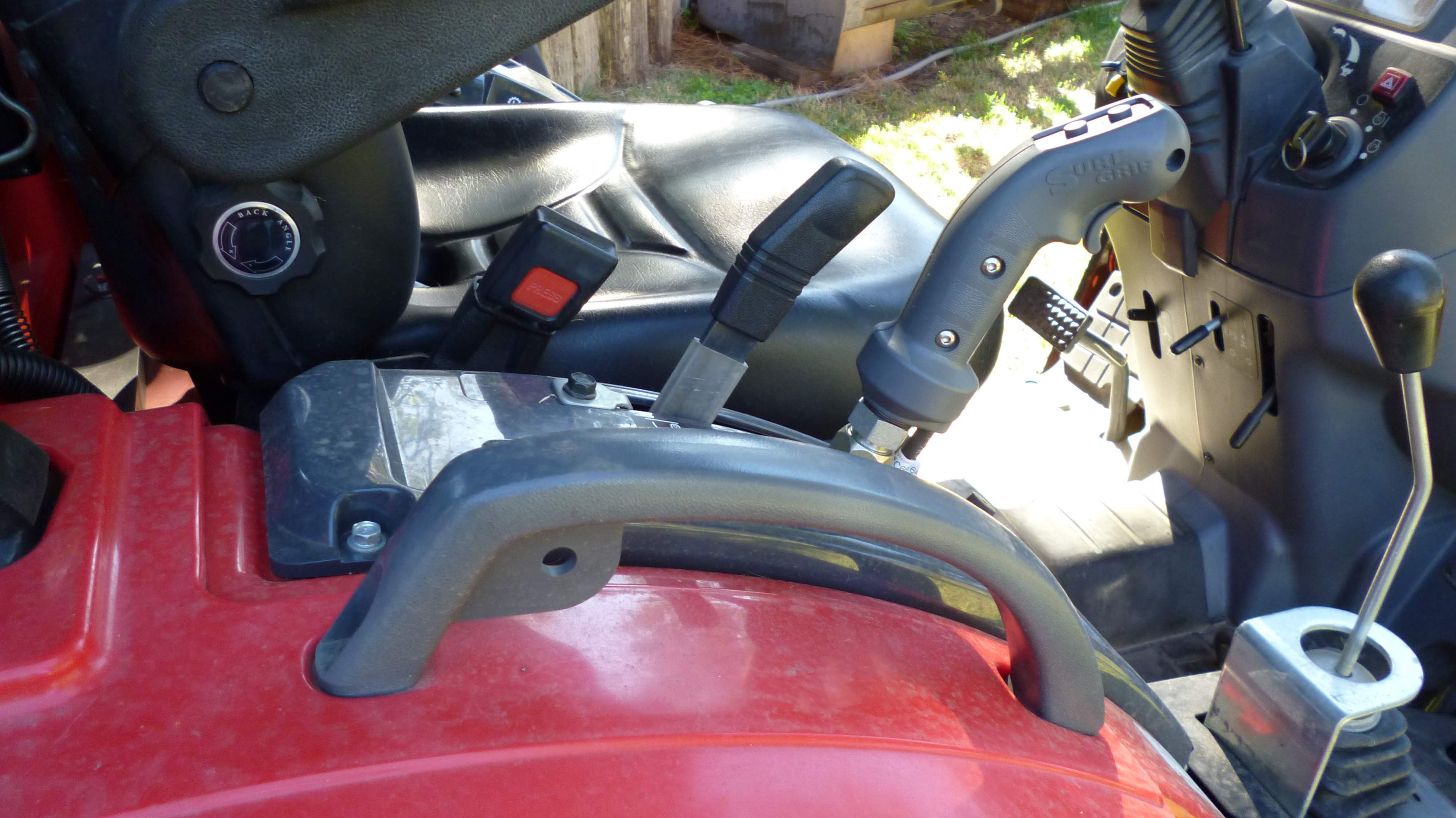

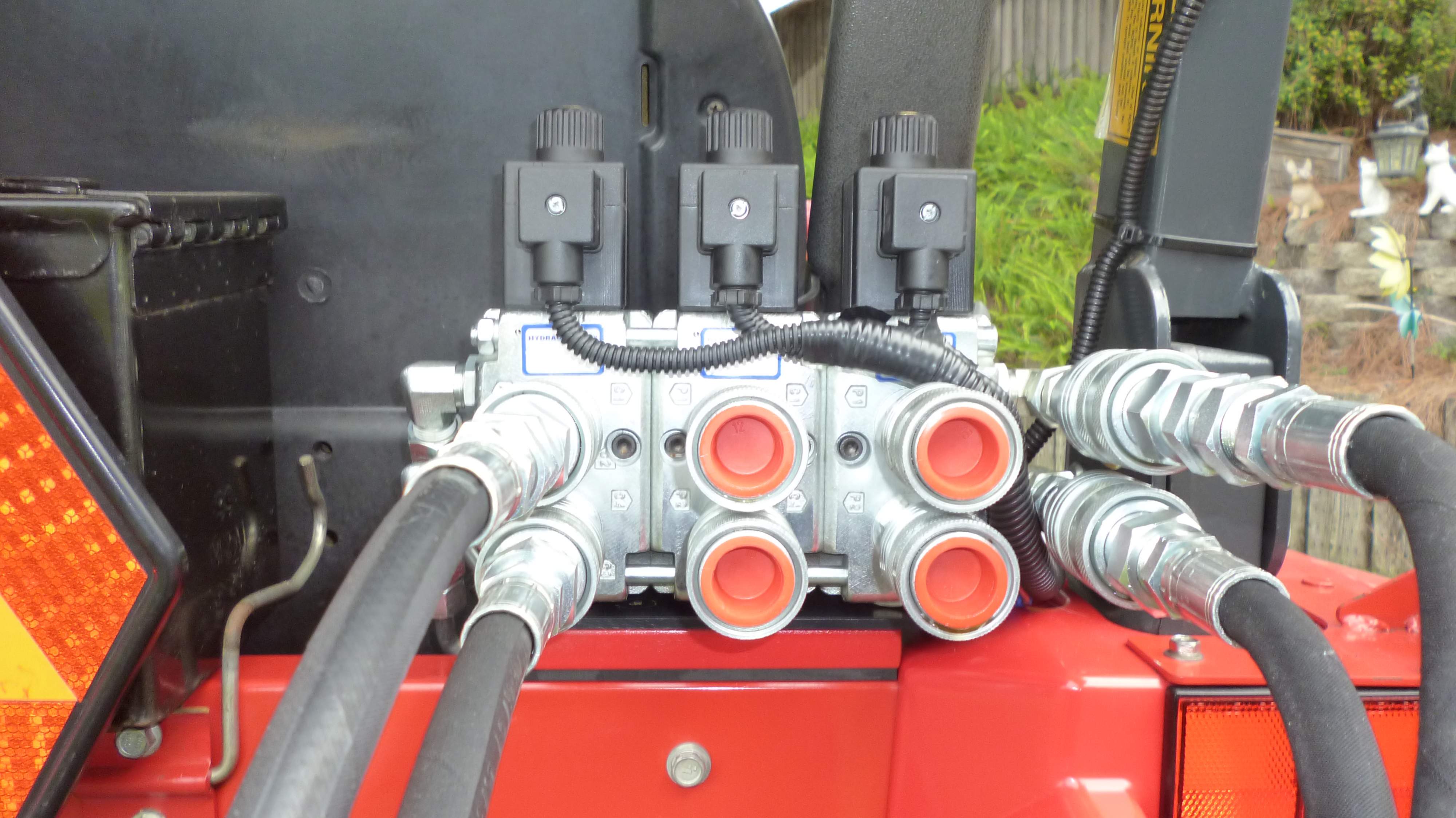

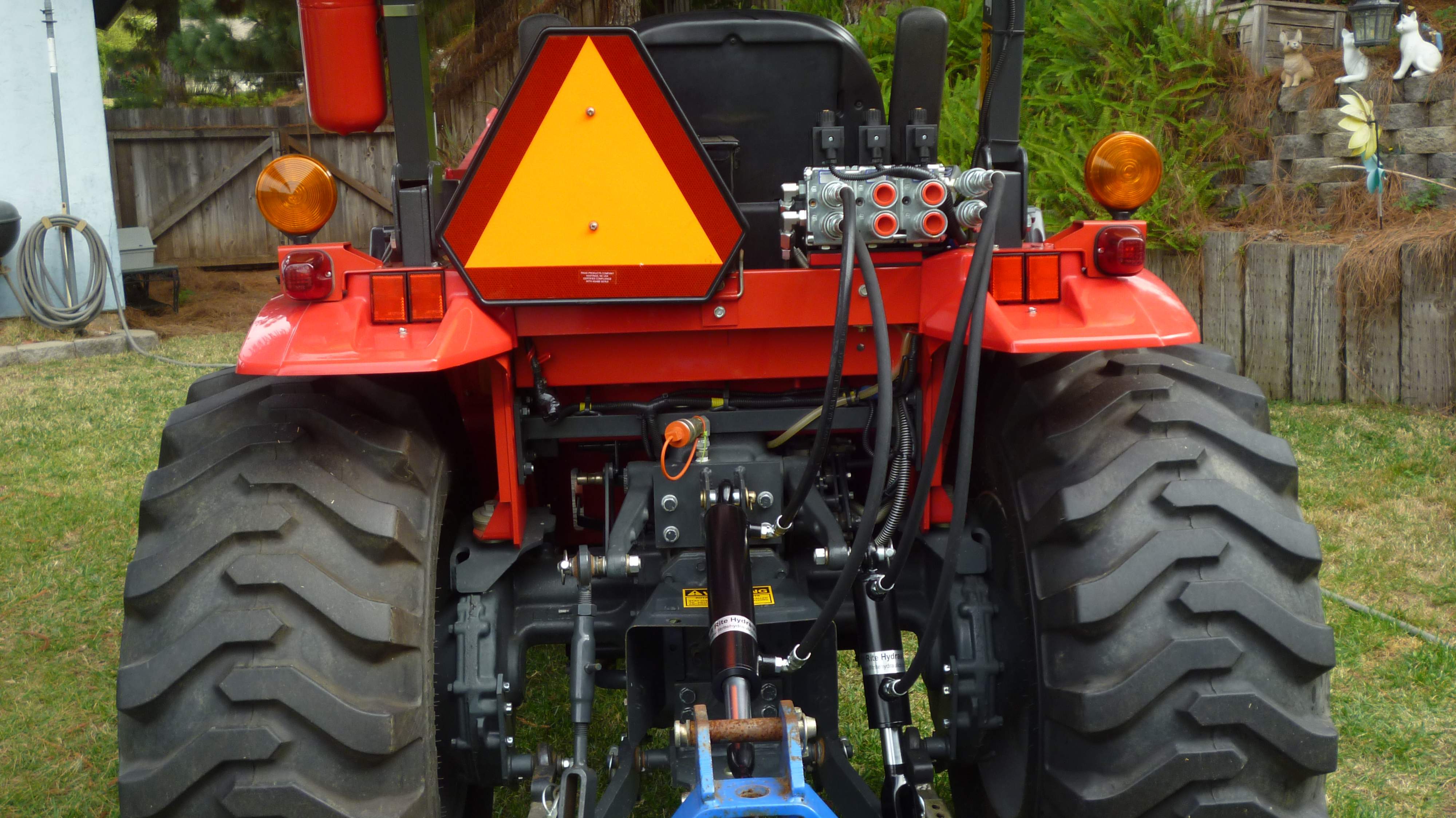

3) third function operation, what does that switch look like? I figure that I'll need one if I get a grapple, and that's one of the primary reasons for getting this tractor is the ability to get one. anybody have pictures that they'd care to share? factory versus aftermarket?

You must be referring to the bellhousing drain pin.. You push it to let out moisture once in a while.. Very few have ever ripped one off. Not much of a problem.. You get up from the seat and then pull it up further within 2 seconds , that is how the standard L's work anyway to keep the PTO turning. The 3rd function will have two buttons or a rocker switch on the loader control. If you want to though you can just use a rear remote to run a grapple. some guys like it about as well, some don't.
Here is one type.
The picture is the same type used for rear remote diverters. :cool:
