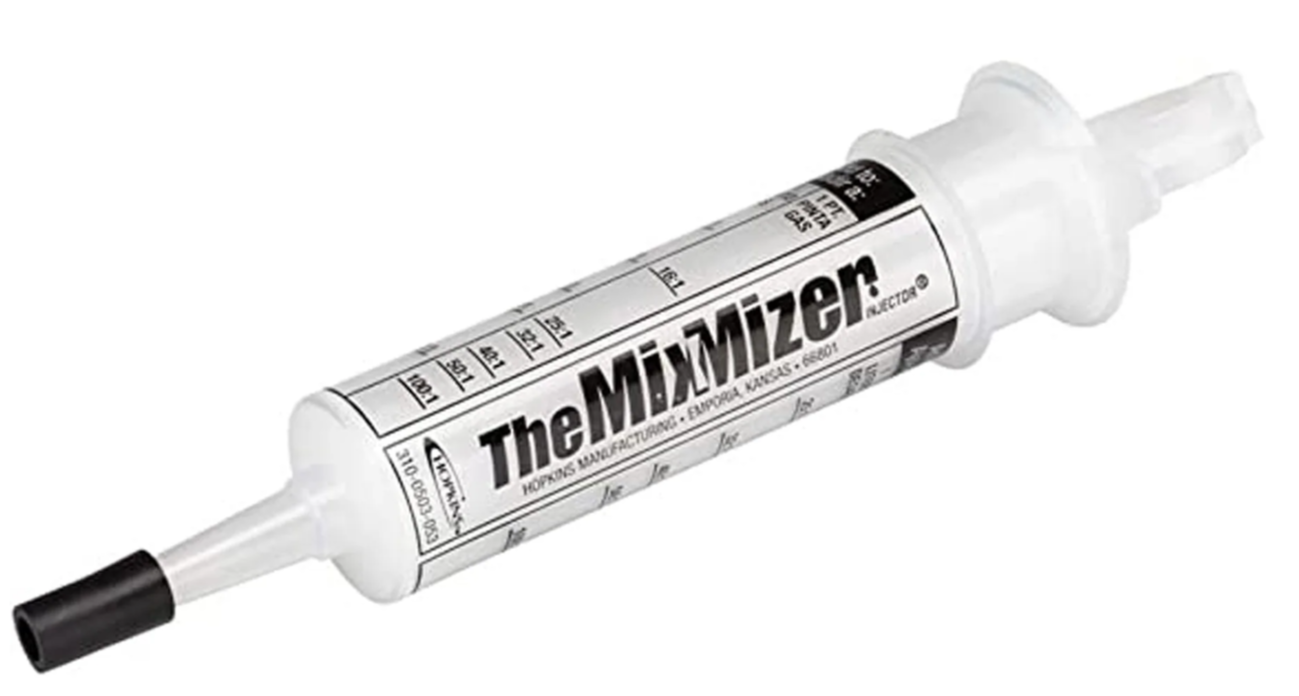

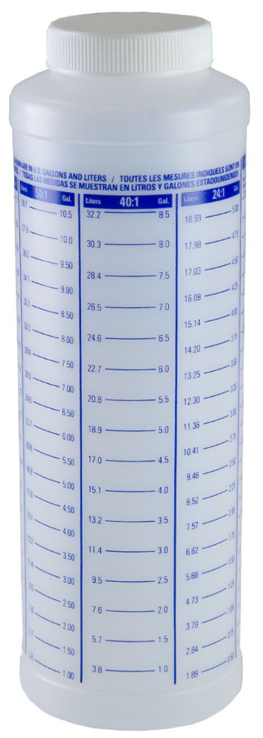

As I buy my 2 stroke oil in "bulk" (relatively speaking, as I buy it in 1 quart containers) and need to measure it out to mix with gas, I'm trying, with not a lot of luck, to find the ideal tool to suit my needs.
Typically I mix my 2 stroke fuel in 5 liter (approx. 1.3 gal) jugs as I find this the ideal deal size for lugging around with the chainsaw, etc. and also for not having it go stale over periods of low use. I may mix a few at a time if I'm expecting to use a lot between the chainsaws, backpack blowers, various Stihl Kombi powerhead attachments, etc.. Invariably, I stick with 50:1 and have had little to no fuel related problems over the years of fairly heavy duty use in a wide range of temperature extremes. I do the occasional 40:1 mix for one the the kids small dirt bikes. I've tried a few types of high end synthetics over the years and right now I've been sticking with Amsoil Sabre.
Years ago I use to buy the small bottles sized perfectly for my gas can (Stihl or Husky) but figured it wasn't that cost effective and don't believe the OEM oils are all that great anyway. I bought them the few times I bought a new Stihl tool for the warranty extension they offered for doing so. Full synthetic OEM oil doesn't seem that easy to come by in that format locally, if they even offer it (Don't think Husky has a full synthetic?). I don't see a time where I'll ever make the switch to pre-mixed fuel, although the ethanol mandates here in Canada may make that a consideration in the future.
For the last few years, I've been re-using a Motul motocross oil container that has a built-in measurer, but that's less than ideal.
I'm looking for something that is precise, suitable for smaller quantities (i.e. 5 liters) and has graduations for liters, ideally even ones. Many of the bottles etc. that I've found are geared more to gallons or quarts so the liter graduations are not even, and I'm trying to avoid math during the process. I also want something that is purpose built, and not just a generic measuring device. I don't consider myself a lazy person, just looking for an efficient and fool-proof solution that will avoid any mistakes.
I see plenty of this type out there, but they're oversized for my application and don't have even liter markings.
I thought something like this would be good, but it's actually a bit small, as it is meant to measure out for a liter/quart at a time.
Somebody must make the ultimate tool for my application? I'm not coming up with much on Google that fits all my criteria.

I appreciate the suggestions thus far.
The Ratio-Rite jug seems good, however they don't seem to make one for metric, and I've only seen one buying option that comes with a lid/cover.
Yes, I can use a high-quality measuring cup, however I'm trying to find the perfect product that does the math for me. Of course I'm capable of doing it myself, but again, I'm looking for the ideal, time-saving, precision tool for the job, because, why not?
