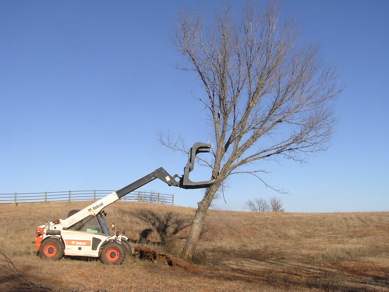

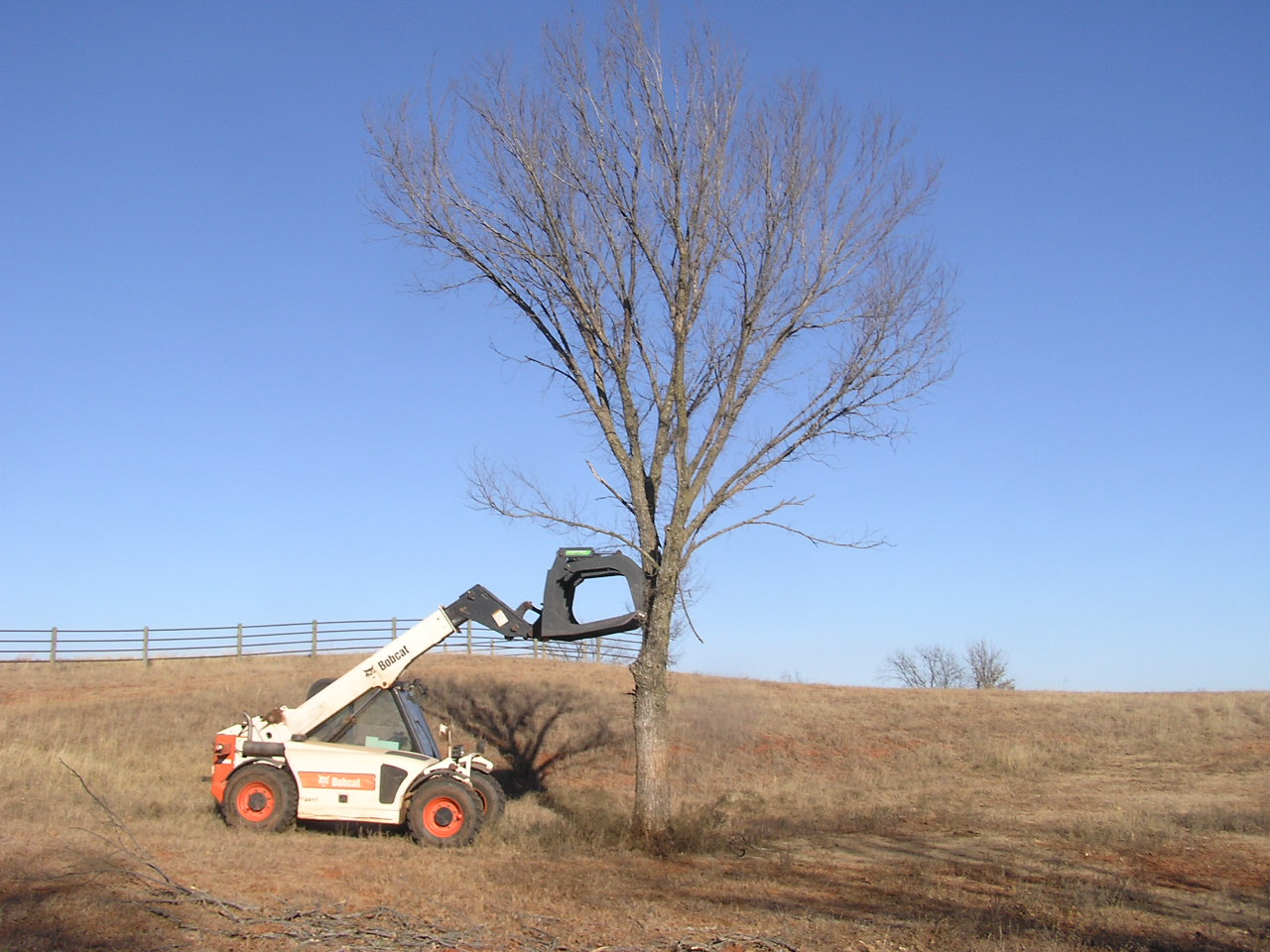

Here is a big dead tree in red clay that the V417 pushed over by extending the boom at idle (1200RPM):
Standing next to the door I reached in and extended the boom:

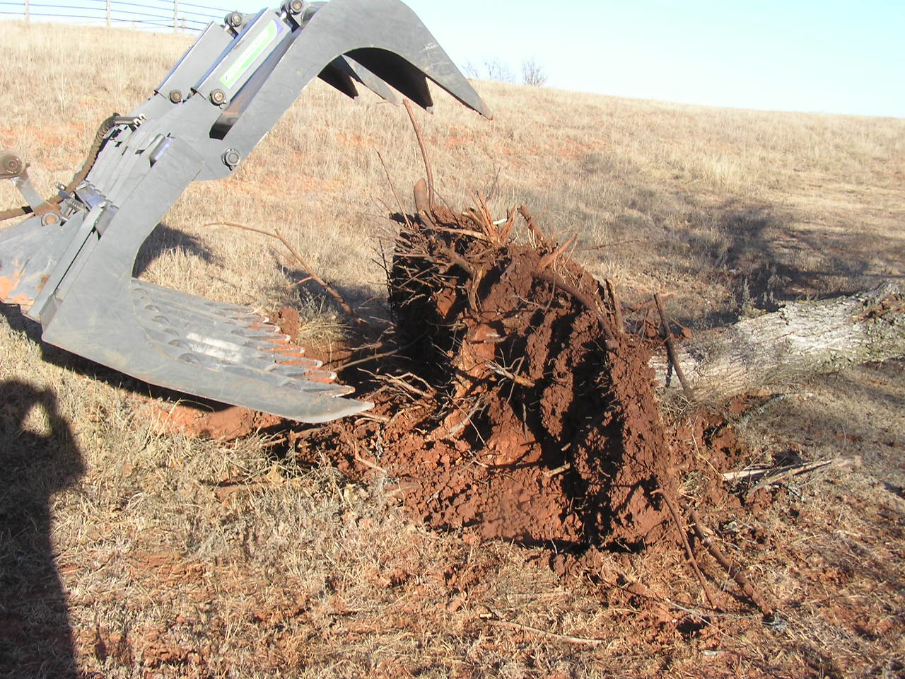

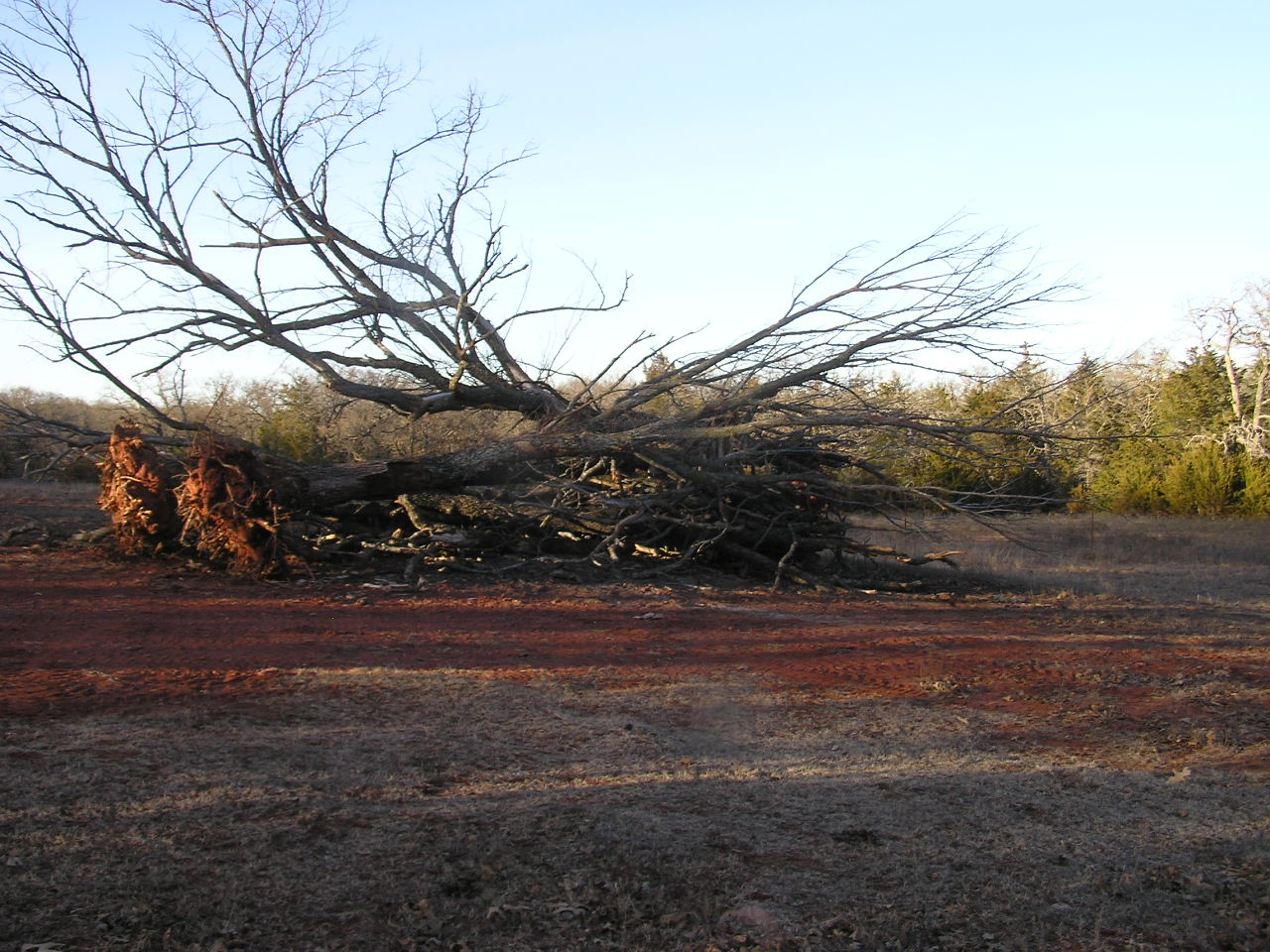

You can see the red clay:

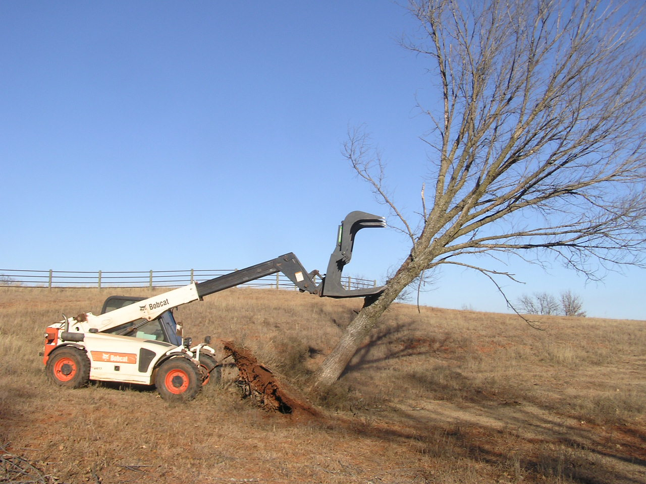

Retracted the boom, lowered the grapple and extended again:

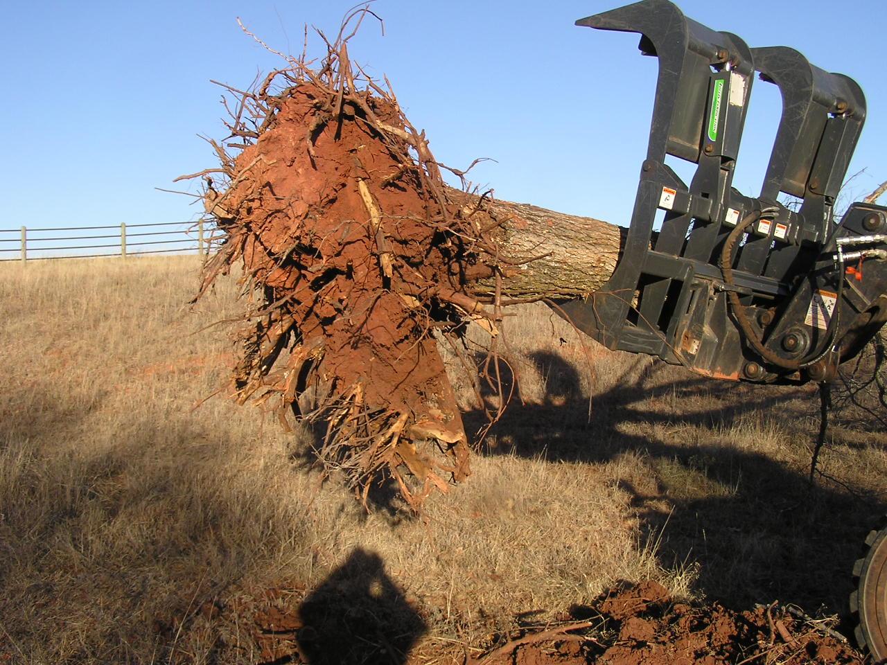

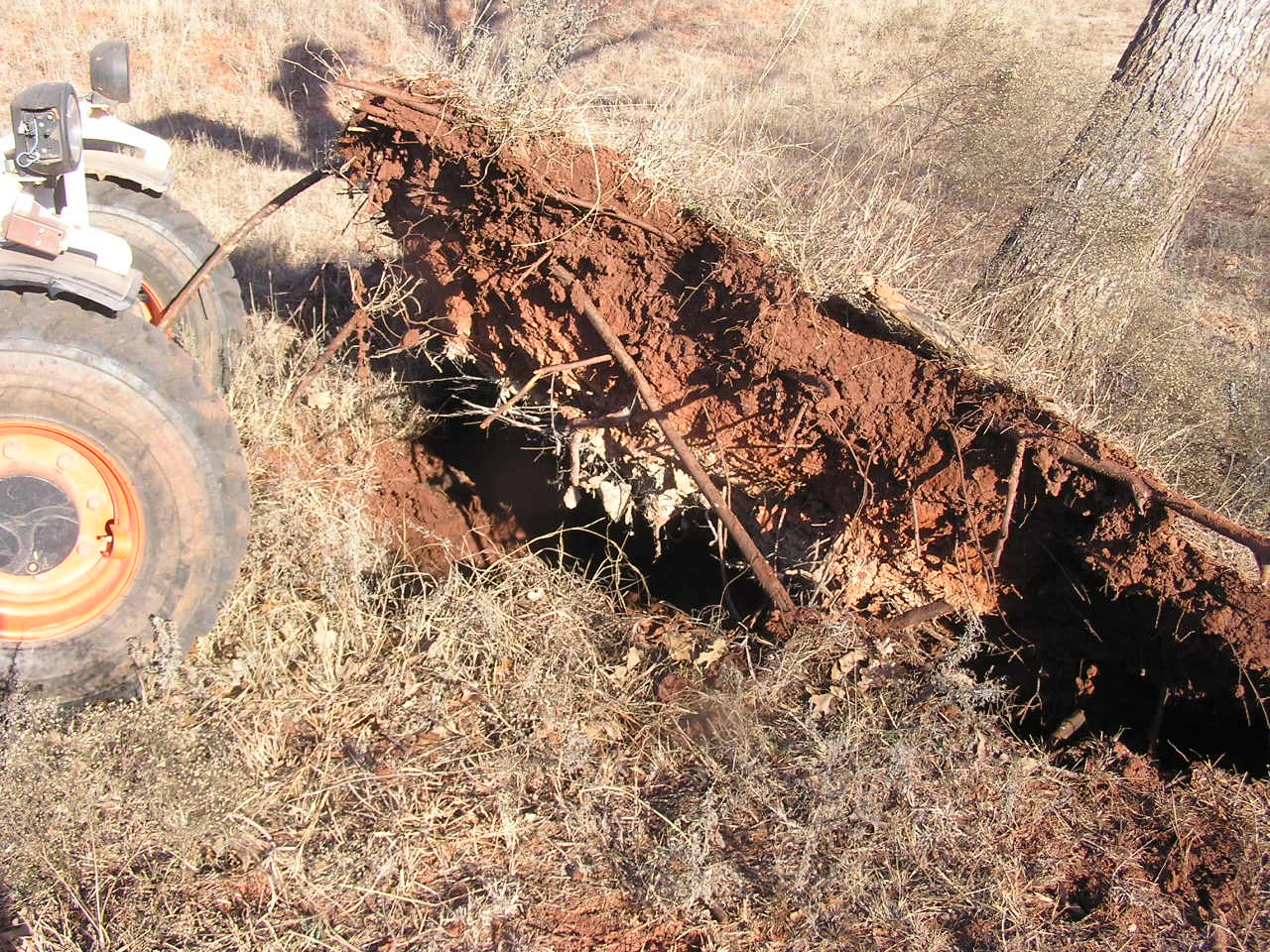

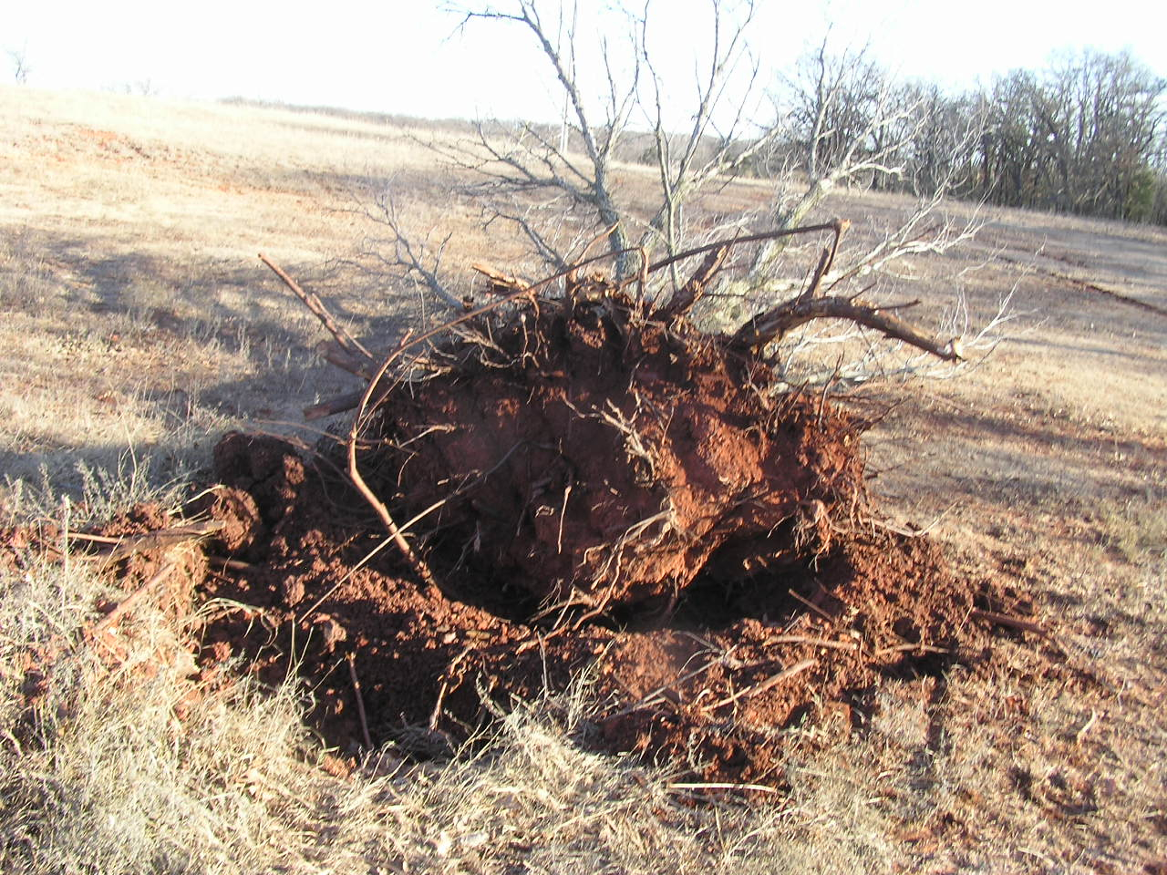

The red root ball:
Knocked some of the red clay off:

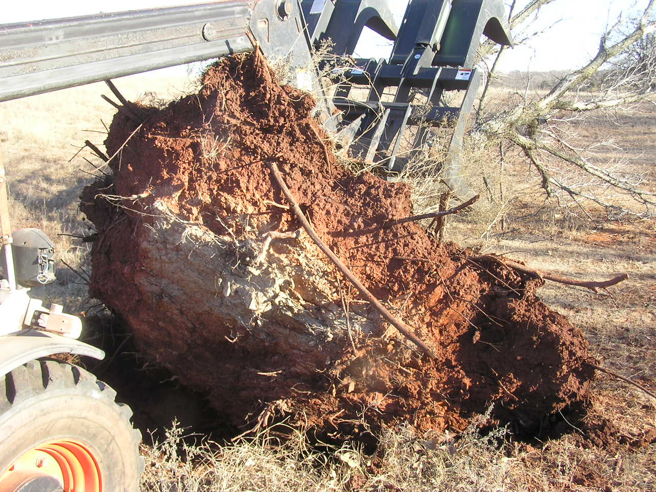

Picked it up:

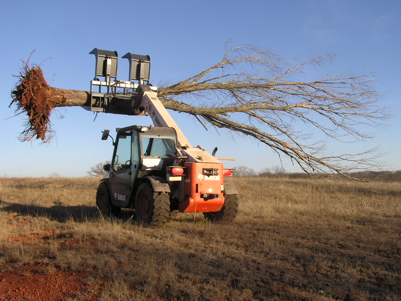

Took it to the burn pile:
