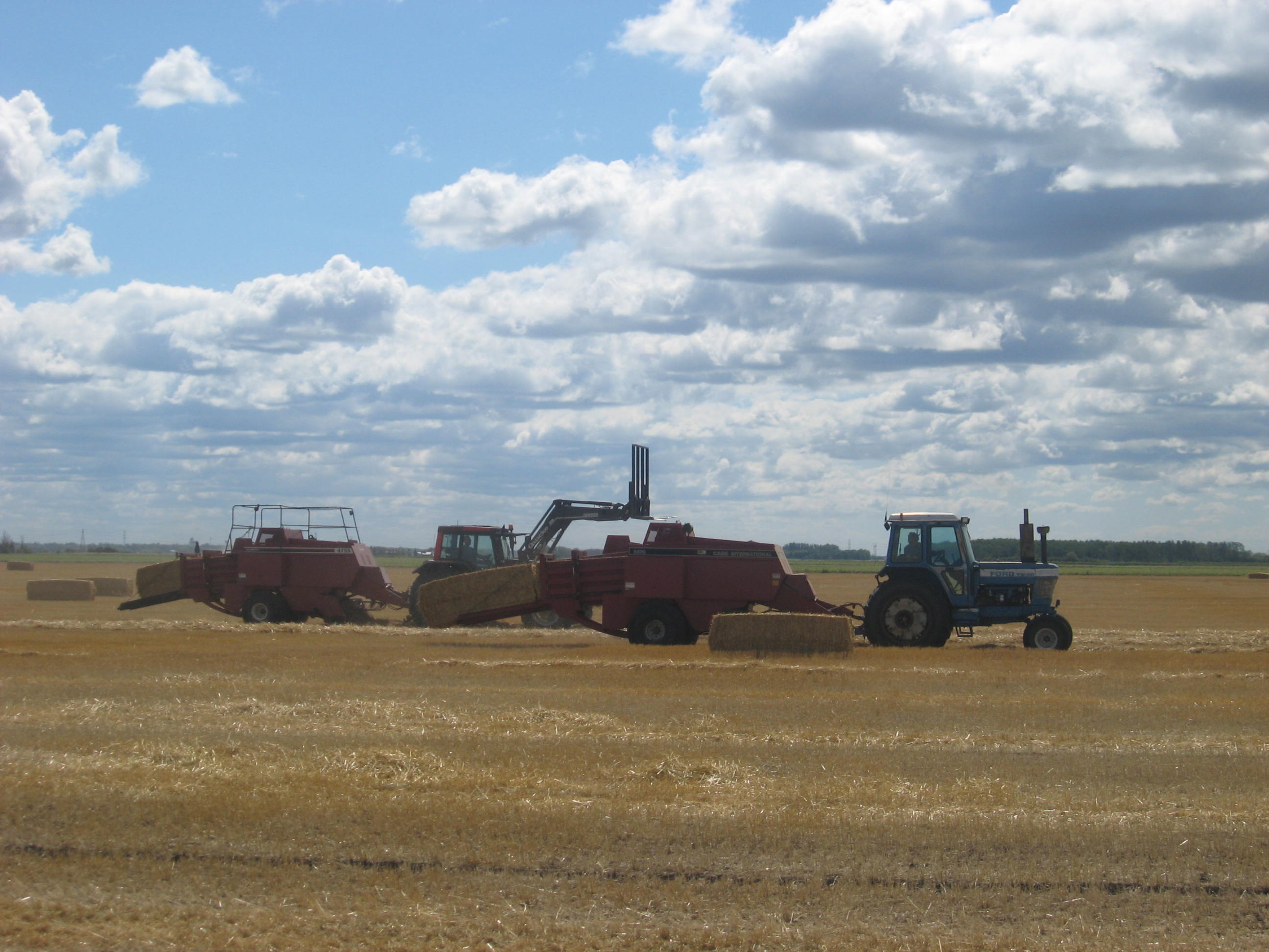

Straw here is worth about $10 a round bale and being in the baling business I charge $7 a bale to custom bale :( . We farm 1700 acres of grain and usually give the straw away or burn it to retrieve some nutrient value if weather permits . We run as most do these days for capacity and reliability rotary combines and baling behind them is a touchy business , if it is dry a rotary combine will smash the straw making it hard for some balers to process , some guys disregard rotary straw as winter bedding because it is crushed and holds less thermal value , yet certain people look for it for young stock , calves,lambs dairy cows because it is softer .
With straw being so worthless for us normally it is not worth the loss of nutrients or the compaction that the land gets from all the equipment harvesting the straw . With recent years of wet weather windows are small to get crop off and get land worked before winter so waiting for "balers" who have been given the straw but tend to be weekend warriors who have a week job tends to end in bad relations . I have burned a field with 300 round bales on it that I waited 2 months for the guy to get the bales off !
Rotary combines are very adjustable depending on brand but you can change gears to slow chopper speed / retract stationary knives and even if conditions allow slow rotor speed but if it's dry they will crush it , Best rotary combine I've ever baled behind is NH TR series because they have twin smaller rotors unlike IH or gleaner with single rotor and leave a wider swath .
baling case IH rotary wheat straw , as you see the swaths are crushed very small !

IMO, Small squares behind a modern combine isn't going to work well. The windrow of straw laid down by a 35' header is huge! A friend bought the largest NH square baler (BigBaler 340) just for that reason.
I think you would have to let the farmer spread the straw and then rake it into smaller windrows, unless you found someone running an older smaller machine.
Buying the straw "in the field" is common around here, several dairy farms do it. They also use large square balers (3'x3'x8'). Some will cut the wheat lower also, increasing the "yield" of straw.
