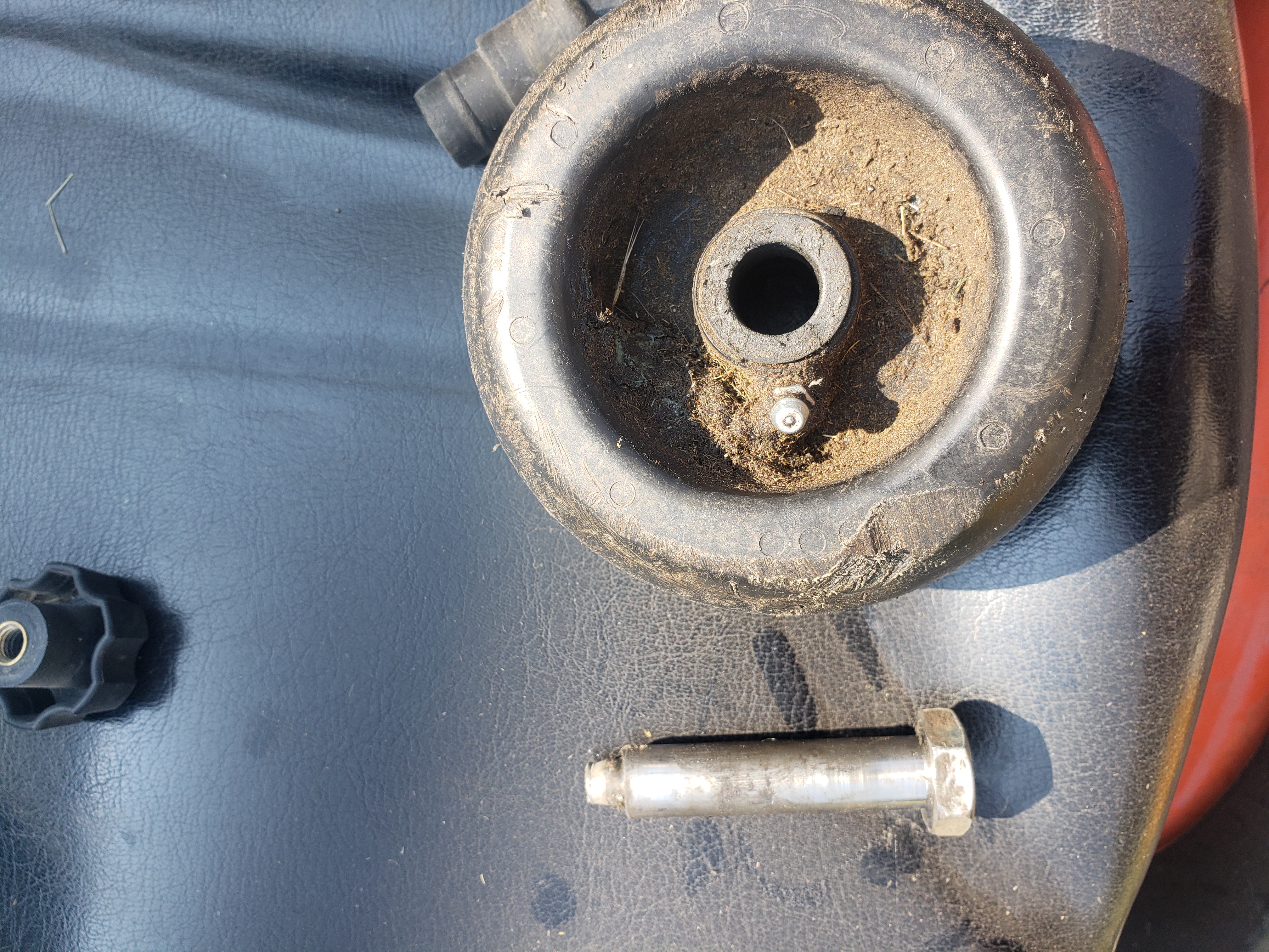

I use a Mowing deck Rck54p23bx with my Kubota BX2360. I found one of the mowing deck wheels laying on the ground. The pin or bolt that goes through its center had sheered off and I need a new one. I'm not finding it on the parts diagrams, tho it must be an often used part. Can anyone help me locate this? Also, do prices vary on these things? I appreciate your time. See pic. Kubota wheel bolt for mower.jpg

I believe that is called a shoulder bolt. Should be available at any lawn and garden shop or hardware store.

Thank you for the tip. The right phrase means everything. Found it right away. PS ACE Hardware did not have it, other places might. But I found it on line at both Messicks and Coleman Equip/ I appreciate the courtesy.

Your dealer should stock them. I have replaced many on my 2002 mower deck. It is the weak link when you strike something with the wheel. Make sure to use nylon bolts to hold it on or you will be hunting your wheel later!

I think you refer to NYLOCK NUTS or any other self locking style of nuts (not bolt).

I just found the picture of the shoulder bolt used on your mower deck,I must say that it looks like the weak link. Also that bolt is used in 19 other decks.
Guess that's why they keep 200 in stock, you might consider ordering a few spares.::D

Good advice, if you broke one you WILL break more, get some spares
