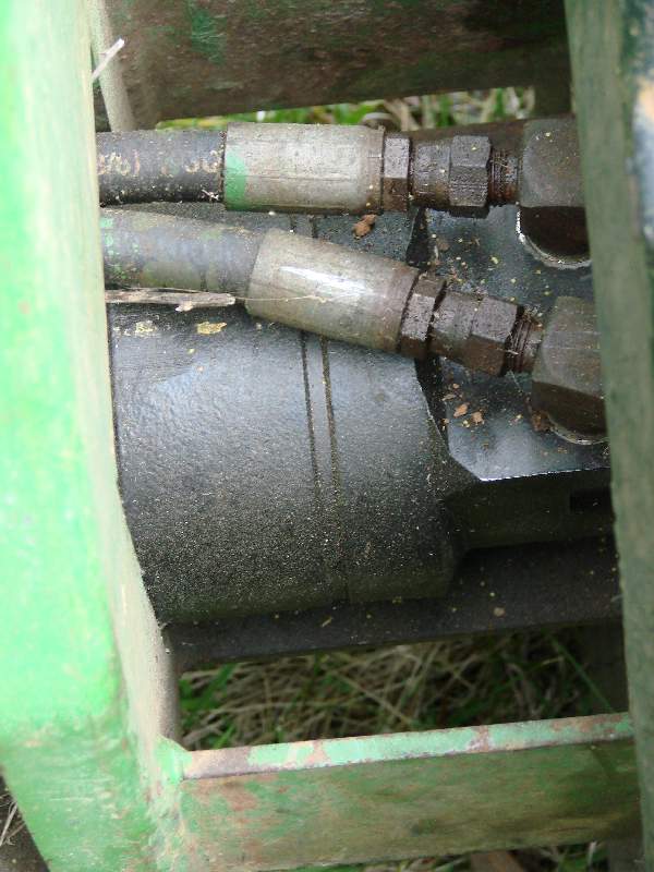

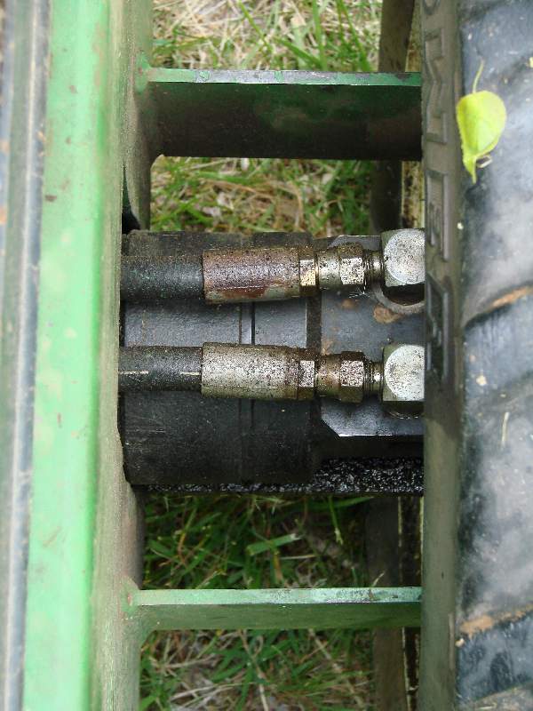

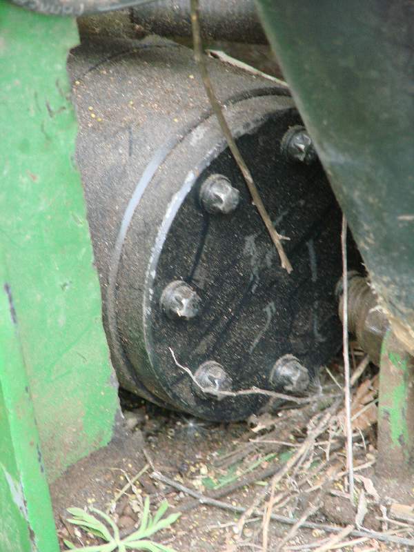

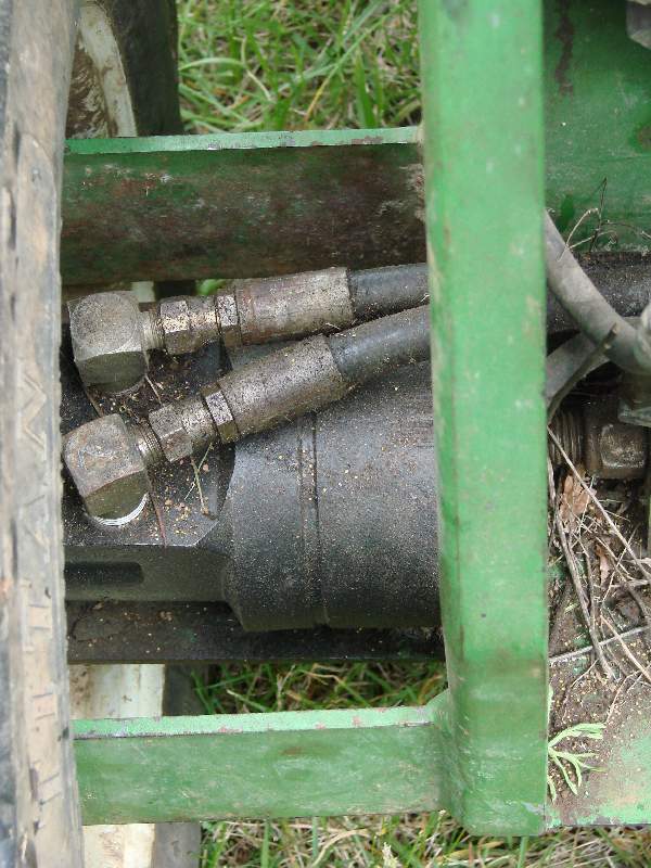

I just returned from TN, and wanted to report on my initial impressions of the new wheel motors. I won't use hyperbole, but just say that the only limitation this PT-425 has now is traction, and that is with four loaded bar (ag-type) tires... it will climb anywhere that I'd even consider taking it.
Here's a few pics of the motors installed. They're about the same length of the original White RS motors, but their diameter is about 3/8" more than the width of the rectangular White motors. You can see the trimming of the openings in the tub to get them in. The flat braces on the bottom of the wheel motor box on this older model (December 2000) 425 didn't interfere with the motors at all. Similarly, they clear the spring-loaded parking brake just fine...

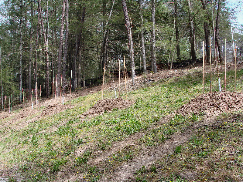

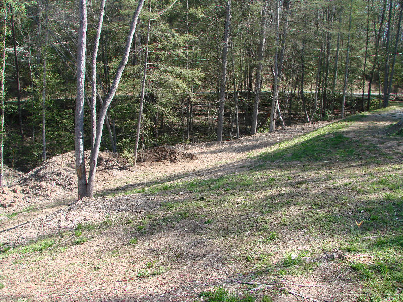

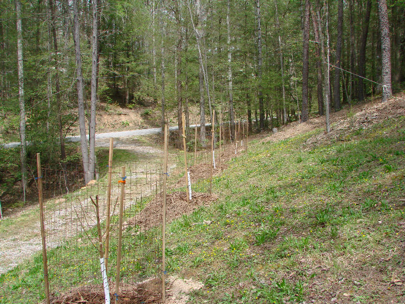

Pretty much -- I didn't get any action shots. But, I could take it anywhere I wanted to go on my property. Above the driveway, where the PT struggled to climb the slopes at an angle in the previous videos, I mowed going straight up the hill with no problems. I even sat on that that slope and dug large holes to plant fruit trees (see the 1st pic below), then hauled topsoil to fill the holes and finally mulch to spread around them. The PT wouldn't sit on that slope with the parking brake -- the front wheels would slide down (see the skid marks!) -- but the wheel motors would hold it up there so I could work.
On the steepest area down front near the trees, it wouldn't climb the slope without spinning when pushing the brush-cutter, so I'd climb straight up it with the mower lifted, then mow while backing down it. I used the same technique to mow the bank below my driveway -- I cut the use of the string-trimmer down dramatically! :eek: :)
