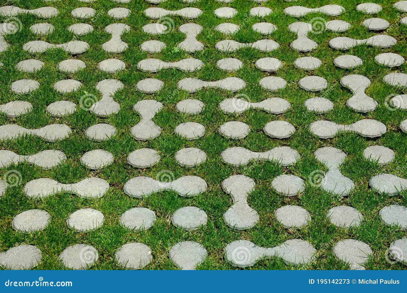

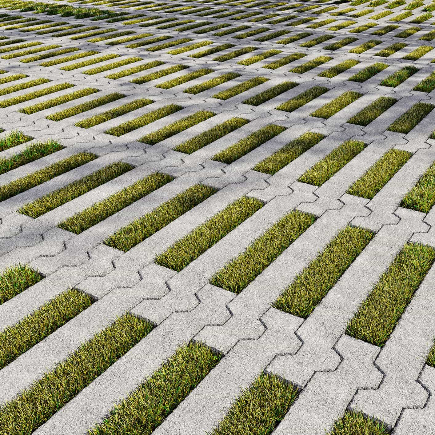

My thinking is to pick up some 8' long concrete lintels or parking stops, and set them into the ground across this path, maybe 4" lintels on 8" spacings or 6" parking stops on 10" spacings. This will still allow me to grow grass here, like some of those concrete grid areas you see used in high traffic lawn areas:

I found a photo of close to what I'm thinking, minus the fancy interlocking 2D array, I'd be doing just be a single row of "ribs":

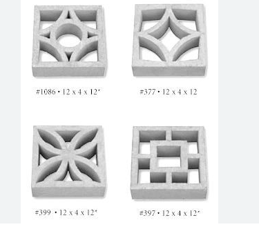

Do what they do around here for the roundabouts that they don't make big enough for the tractor trailers, bury fancy cinder blocks. That way when they drive over the island they don't screw up the grass nor do they screw up their tires and wheels.

The grids posted by mrmikey are along the lines of what I'm planning, but with 8' long sections. I suspect the smaller grids would have a tendency to sink in the narrow wheel tracks, versus a longer continuous concrete lintel or parking stop, which should spread the load better.

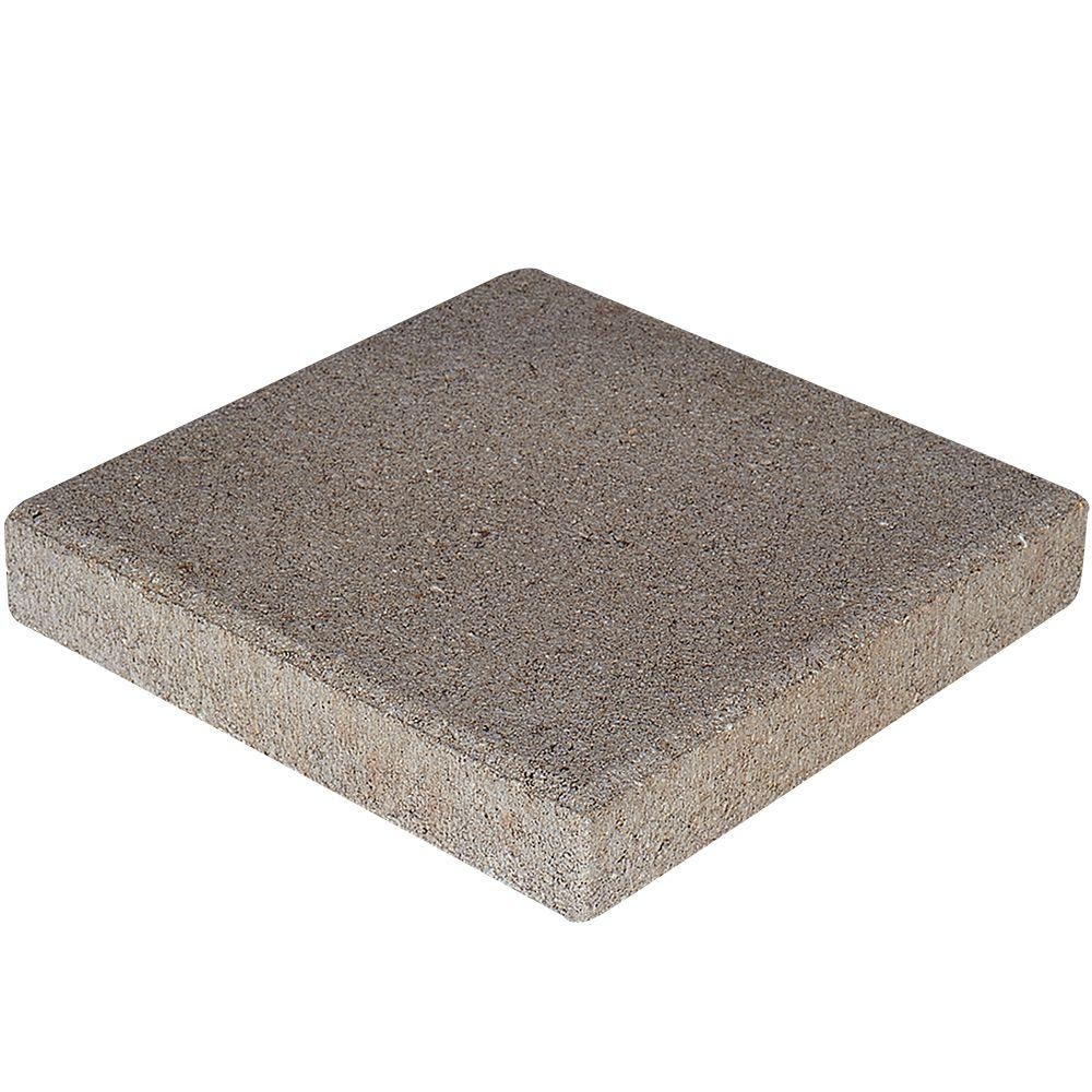

Gravel (to fill in the ruts only) will squash down and not really be an issue to mow over, unless you put too much down. You could also dig a bit and put these (12x12 pavers) in.
