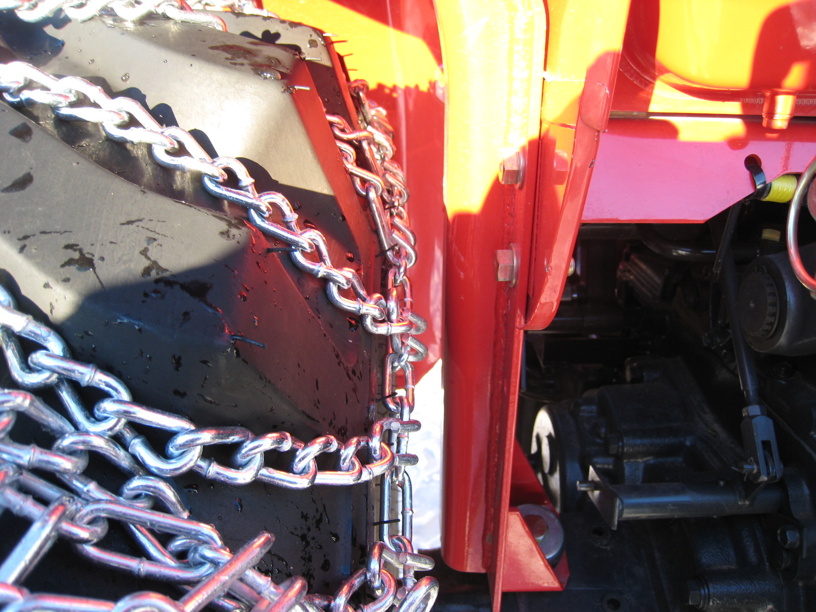

My chains are going to be fine. The chains that came in are not the logging chain style like Wyld's. They maybe won't last as long, but, I won't need spacers. I got the front chained up and the same chain (only wider/longer) will come in for the backs on Monday. Used the FEL to raise the front end to install the fronts. I will use a jack to life the backs off the ground to install the chains. They are not real 'friendly' to install, but, they will stay on until spring.

You have the newer style rim, allowing enough space. The older style rim had maybe 1/2" clearance. Looks good.
Ditto,...was it a different rim or just a narrower tire??
