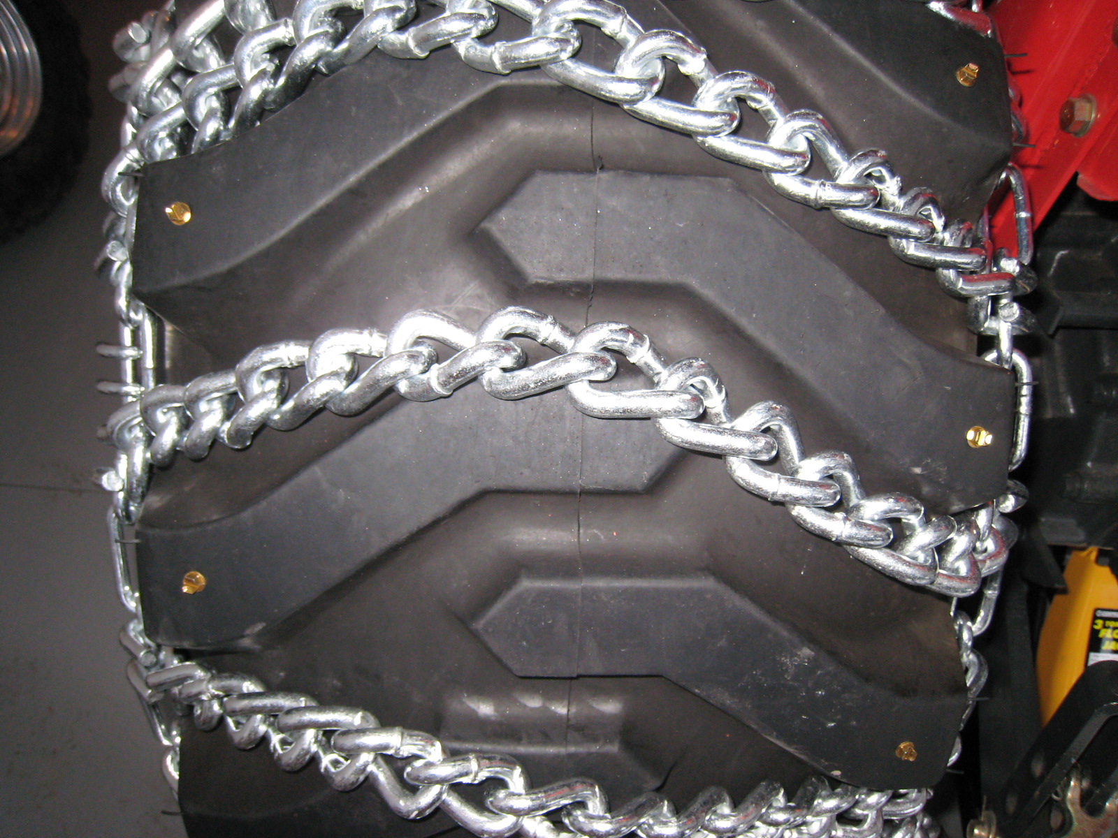

   / Wheel spacers for Mahindra 2615, 2815, 3015 #28
My rear chains when on just fine with plenty of clearence. Screwed in ice studs on each lug as well.

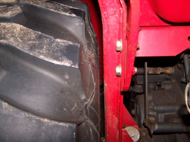

   / Wheel spacers for Mahindra 2615, 2815, 3015 #29
You definetly have more space than I do for chains. I can't even get my smallest finger between the tire and frame. If I opt for rear chains I'll have to space out the wheels but in 4 years I haven't needed them yet.
#30
Yeah I wouldn't worry about it George. I haven't needed any all winter so far. THe only reason I'm getting the spacers & everything is because I already have the tire chains so I figured what the heck. I have a 1000' long steep driveway & haven't really needed any chains yet though:rolleyes:
