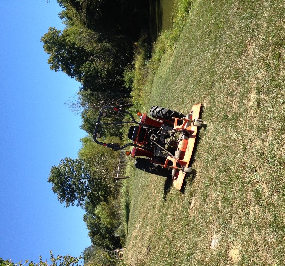

Yes I do have a FEL - and no, it is not on the tractor when I mow - tried that once, NO WAY does it help. It reduces the level of slope I can cross drastically. Up and down, it's a must - sideways, no way.
I do have a QH and it stays on the tractor all the time, so yea it is adding to the leverage that the rotary cutter or finish mower act on the tractor.
I did kinda do the fishing line thing once a long time ago but used a motorcycle tie-down hung from the ROPS. I don't think this is very accurate (I'd say it's close and worth being able to see) as the area the tractor is sitting on gets crossed every time I mow with no problem or pucker factor. It's the area just to the uphill side in the pic from the rear that is the area that rolls up to about 25*. There is a tree just out of the edge of the picture. I've only drove across that next tractor width between where it is now and the tree twice.
It would help your control on sideslopes if the QH was removed during the mowing. It would not be huge, but should be easily noted in comparison. Combined with the extra width you plan, yould probably be comfortable -- perhaps to the point of doing it all sideslope. You might want to explore this setup before buying weight.
The up and downslope mowing options will always be under some handicap since the tractor does not carry any of the mower weight, but must have enuf traction to control its motion with no slip. Adding weight to the tractor is about the only way to help under that circumstance. The wheel weights or extra tire ballast are best options. 300 more pounds at the rear might be enuf.

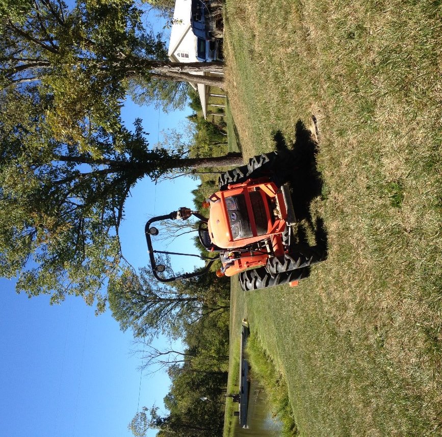

9L, those last pictures, I mow like that with my Ford 1600. Which is 2WD, with R-3 tires and wheel weights. It is close in size Id say to the L3800.

Gary, I do have the tires filled (all 4) and currently have 3" rear wheel spacers.
I don't have any problem going up & down the slopes as far as the tractors ability, BUT when I do, the tires pull the grass lose from the ground or just tear it out if they spin and that leads to erosion and ruts. Mowing side slope doesn't result in that, which is why I prefer to mow that way.
