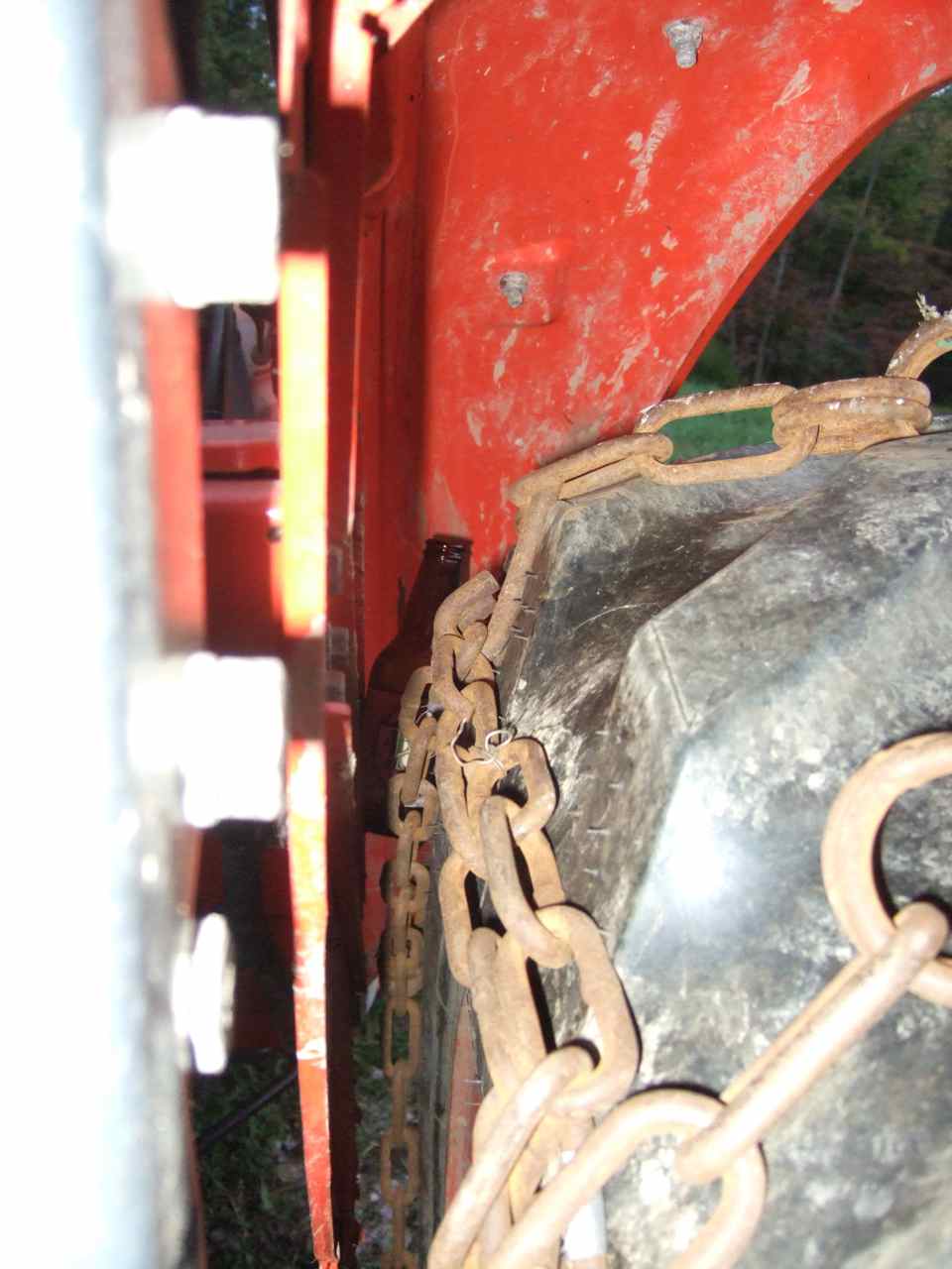

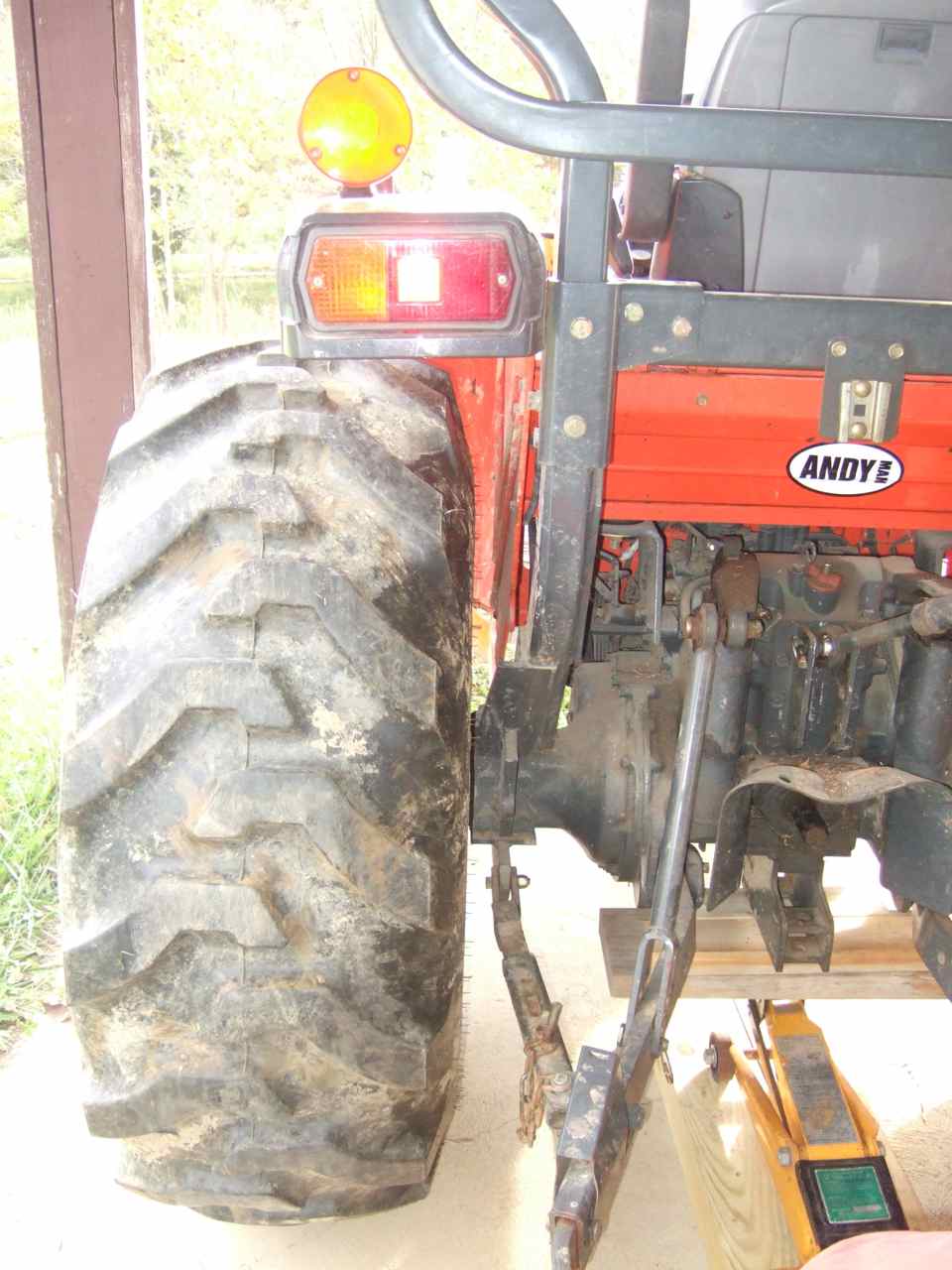

I had same issue. Here are pix of wheels mounted "in" and "out". Did not need to use spacers. The first pic with chains shows the lack of clearance. Have not remounted the chains since moving wheels out so I don't have an pic of that.
