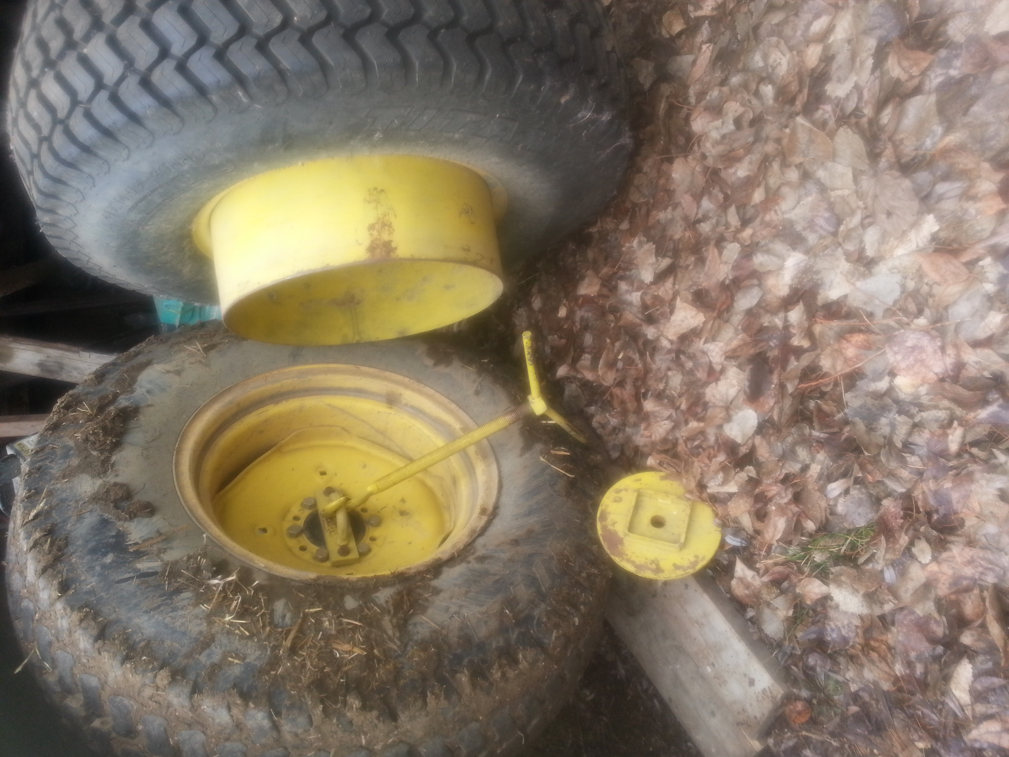

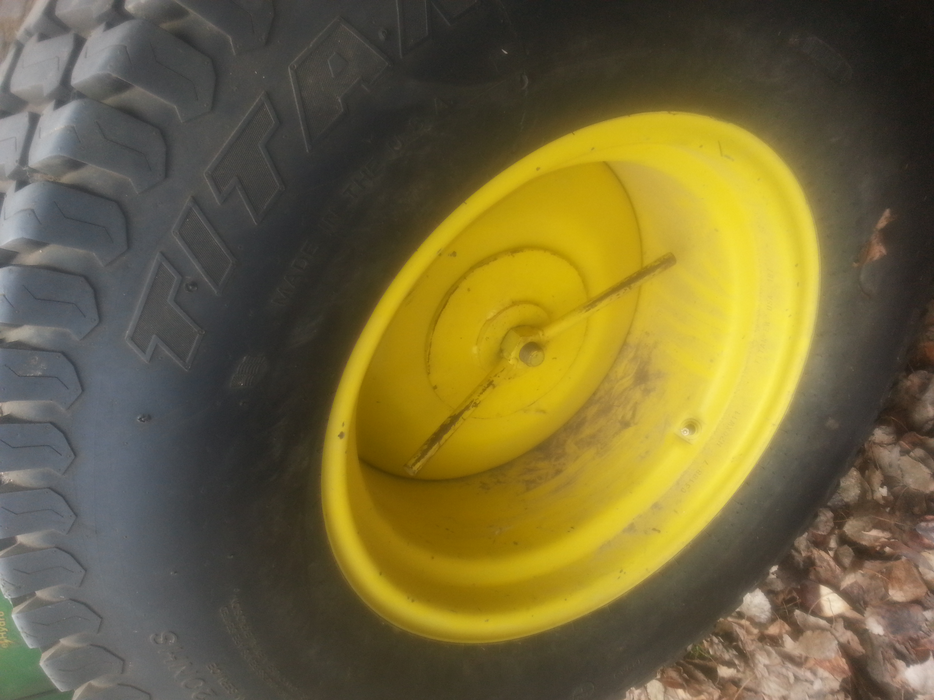

In the back of my mind is this promise that I made....so here we go.
So this picture pretty well shows everything. I just had 4" wide steel rolled to the diameter I wanted at my steel supplier's. The hook is off of a logging type chain. I welded it to some 1" all thread. I welded some 5/8th's rod to the nuts so I could tighten the bolts with a hammer instead of having to carry a wrench around. At first both the all thread bolts were regular thread but the one wheel kept loosening off so I made the one bolt with reverse thread. Now both wheels are self tightening which works a lot better. Once the bolts are tight I don't have any trouble with the wheels spinning if an outside wheel gets all the power put to it.
I decided to attach the duals to the tractor by attaching then to the center hub with the bracket I made. I've lost a wheel before because of the bolts coming loose and I just figures it would be stronger if I attached the bracket to the center flange. All I did was drill through the flange and attach the brackets with some 1/2" grade 8 bolts. I didn't want to depend on the six bolts holding the wheel on to also support the dual. Especially with the kind of work I do with it.
The wheels and rims came off of eBay. They were about $600 with freight. Tires are $300+ each up here so I felt I did ok. The big center washer should be self explanatory.

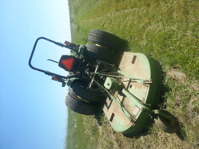

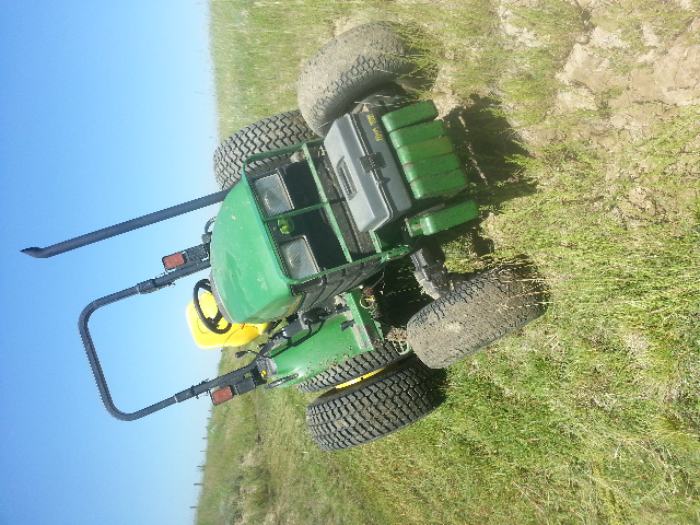

And this is what I built the duals for. I don't know how to rotate the picture so my apology's. It doesn't look that steep in the pictures but look at how much the front wheels are cranked just to stay straight.
   / Wheel Spacers #39
According to the level on my phone app
2nd pic = 68 degree slope
3rd pic = 110 degree slope
Man I need some duals:thumbsup: As well as whatever anti-gravity device you are using in the third pic:D
