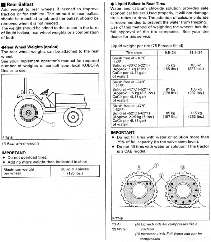

Although skimpy in many areas, it treats wheel weights and liquid ballast separately (see attachment).
Also, the workshop manual says specifically to not fill the front tires. Not that I was ever planning on doing that, but what do you suppose that is all about?

Harv, that's a very similar page to my manual, but you've got 24" tires and I've only got 16" ones, so mine makes no mention of wheel weights. And a year or so ago, I wondered about the admonition against putting ballast in the front tires; right after I had filled mine with water and anti-freeze, and if I remember right (which you wouldn't want to bet on) someone on the forum (one of the Kubota dealers or mechanics) said something about binding gears if you operated it in 4WD on a hard surface, so I didn't worry about it. However, when I ripped a valve stem out of the right front wheel, pushing a brush pile, and lost all the liquid ballast out of that front tire, I took it out of the other one also.

I saw your attachment and looked up the same section in the Grand L owners' manual. Guess what? Same spec. 185 lbs per wheel maximum. I am guessing, but it must have something to do with the strength of the steel wheel itself or the torque loading on the bearings. The liquid ballast in the tires can go up to 585 lbs per tire, so it's not the raw weight!
Hmmm I wonder what the real story is...
