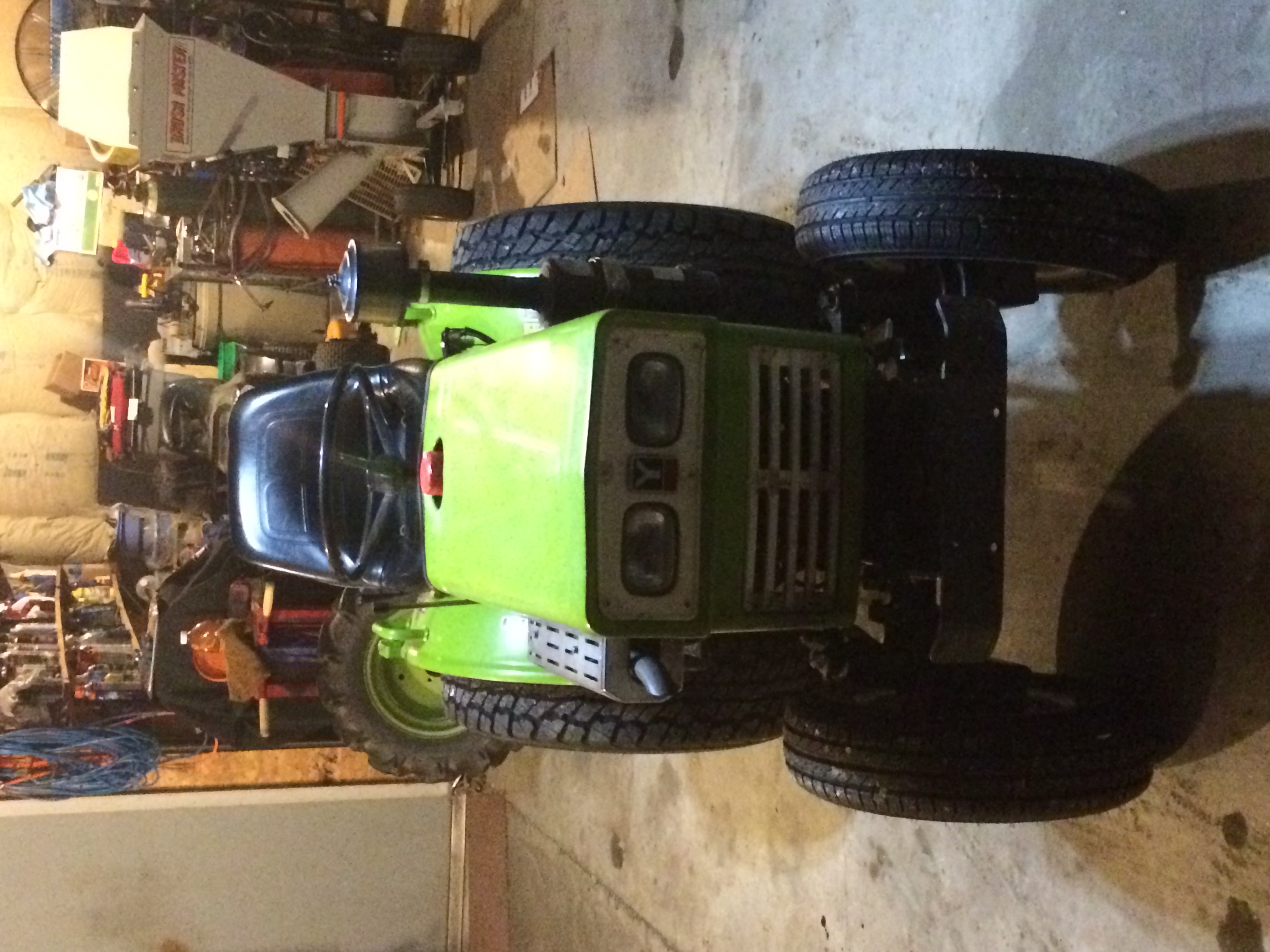

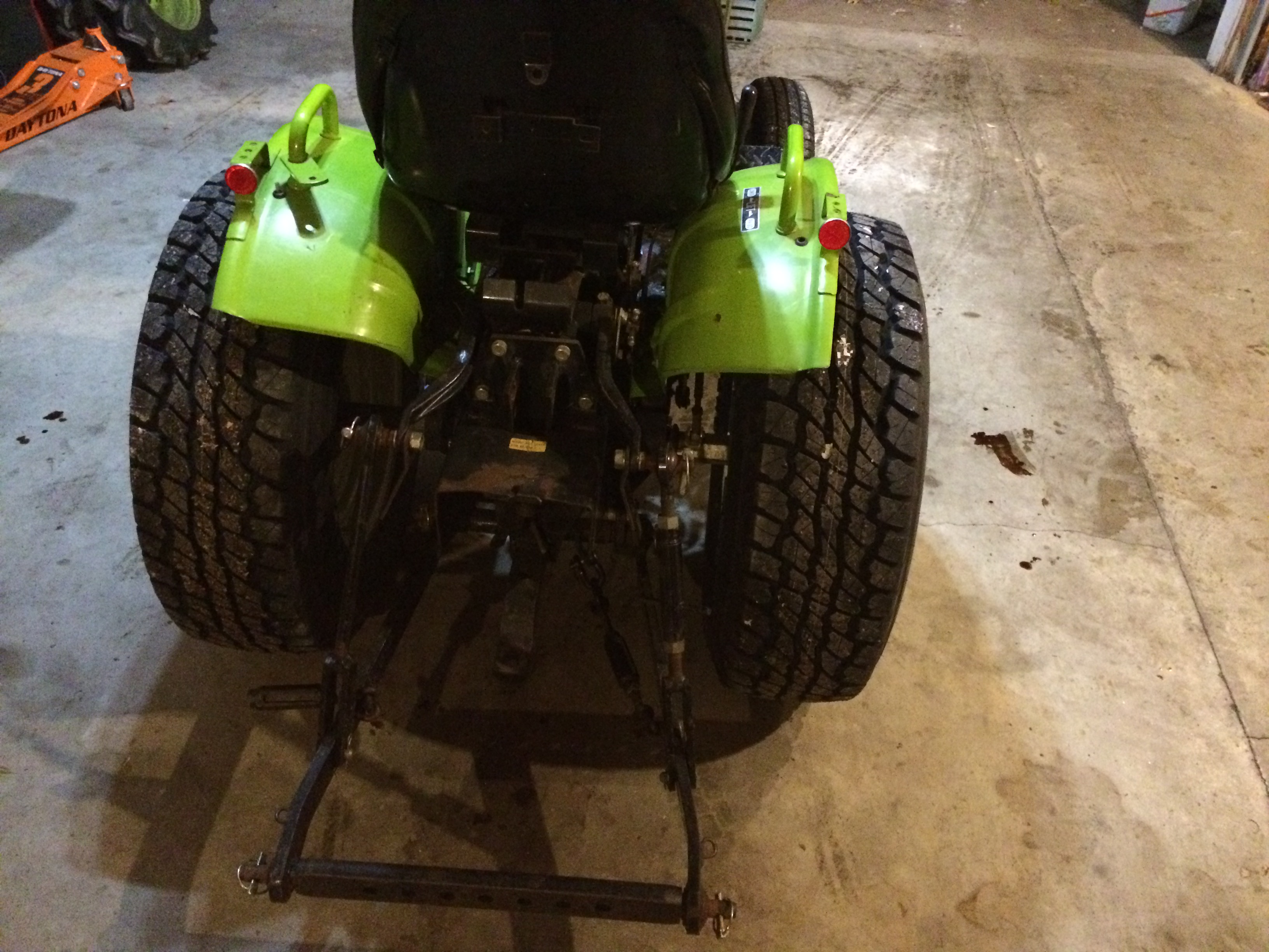

Truck tires seem to be a common replacement for "turfs".
A side benefit is that chain sets are readily available in those sizes - assuming you have clearance for them.
Even if you aren't in the snow belt, chains on turfs (or truck tires) can be used for field work - better than Ags or R4s in SOME instances.
