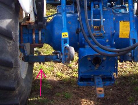

/ When do you let the 3ph stabilizers float? #24
charlesw said:
Arrow pointing to mine...
Uh huh. Your question made me think of vertical stabilizers. I never heard of floating the horizontal stabilizers. Interesting, but dangerous. I've got quite a few TPH implements, and I'd be worried about each and every one of them causing the lower lift amrs to strike the inside of my rear tire lugs.
//greg//

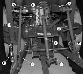

/ When do you let the 3ph stabilizers float? #28
shaley said:
I don't think my hitch has all the features or parts you are talking about and
I think the 3PH in this photo is from a 8N or something old and may not reflect what we have today but I hope it can help clear up terminology.
I don't see from the photo the option of floating?
Bob
