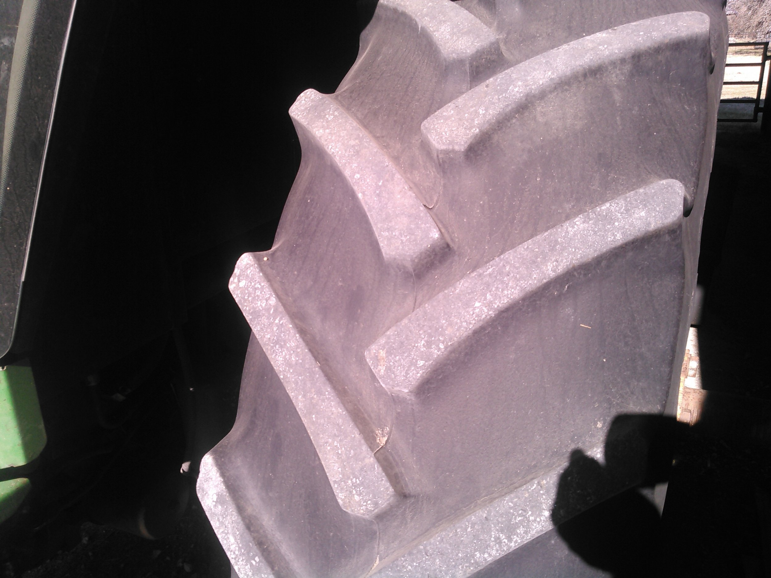

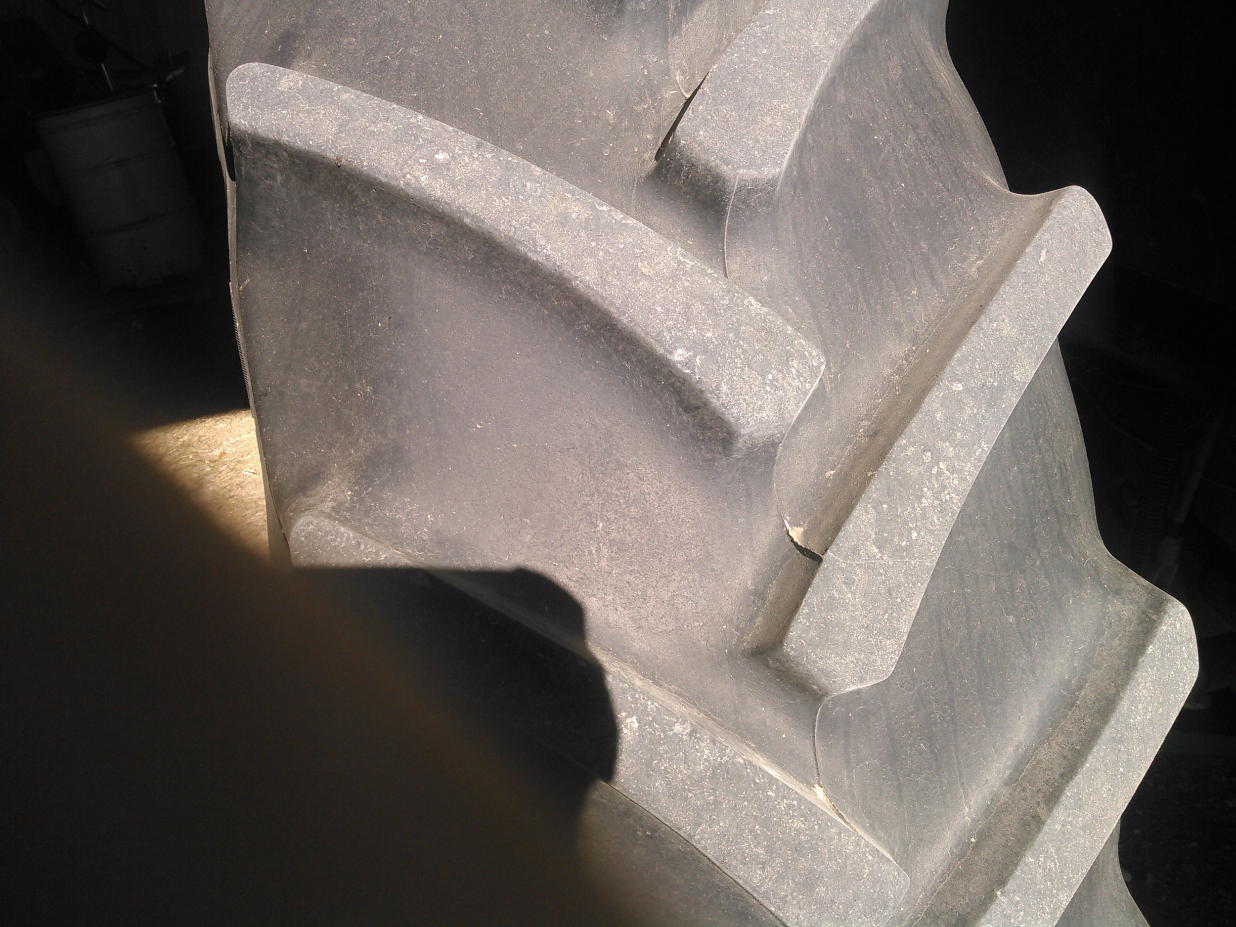

I've been custom farming/hay baling since 1987. I've utilized one tractor with very worn/cracked rear tires strictly for pulling a 14 wheel rake for many yrs. The cleats were worn almost smooth/cracked sidewalls & one could almost see the air in the tubes!!:) I found a set of used 18.4X34 R1 tires with good cleats for $400 installed for the pair or those cracked tires would still be utilized raking hay. My rd hay baler pulling tractor Continental brand rear tires are over 20 yrs old with unknown miles of highway travel shown in photos below.
I replaced the frt tires on my Kubota M7040 MFWD at about 400 hrs just to get tubeless tires to get rid of tubes. This tractor now has 1600 hrs showing on it's speed/hour meter. Mesquite thorns & tire tubes don't get along very well!!!
I personally see no reason to replace ""good rear tires when only frt tires are needed"" on a MFWD tractor.
