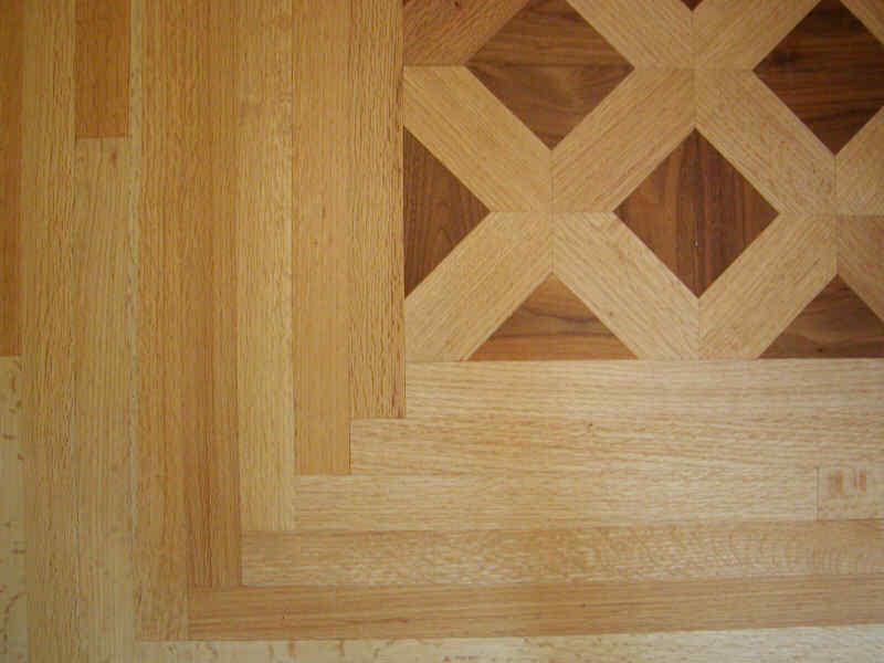

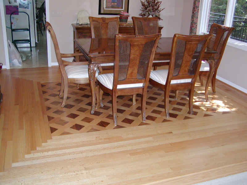

In the dining room I put a center of parquet floor made of Black Walnut & Oak, and surrounded it with quartersawn oak in a log-cabin pattern. When I get home I'll post a picture. We did that so that it gave the appearance of a rug under the table, without the difficulty of sliding chairs across a rug. Since I did this they have come out with many types of easy-to-install, <A target="_blank" HREF=http://www.goldenstateflooring.com/Flooring/product.cfm/KEN/-/kencustomaccents>premanufactured inlays</A> that can really make your project shine.

As threatened, attached is the picture of the <A target="_blank" HREF=http://www.goldenstateflooring.com/Flooring/imageview.cfm/KEN/-/kencustomclassics?Image=ccmonticello_large.jpg&Location=Samples>Kentucky Floors, Monticello Pattern</A> in the dining room.

Finally, a close-up of the log-cabin, quartersawn oak around the central parquet. This floor has been in for eight years, and is still pretty tight with minimal cracks between the boards.
