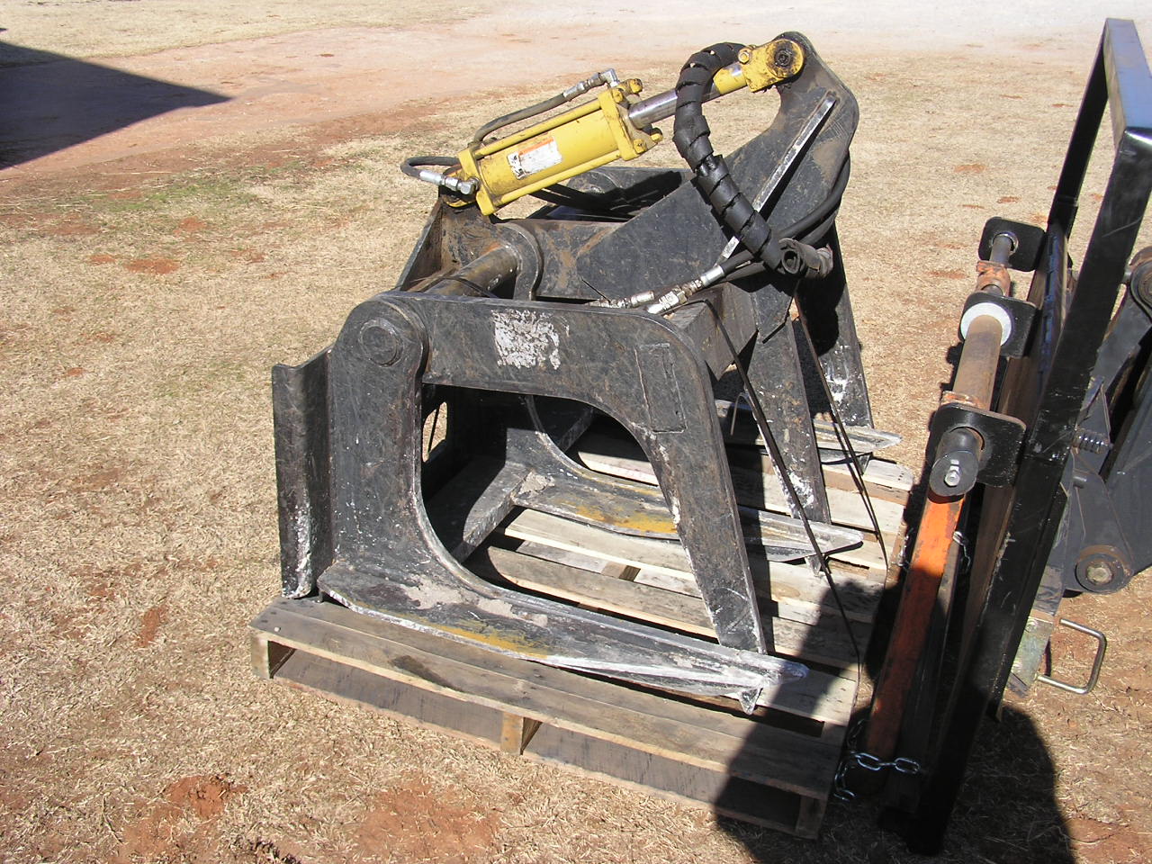

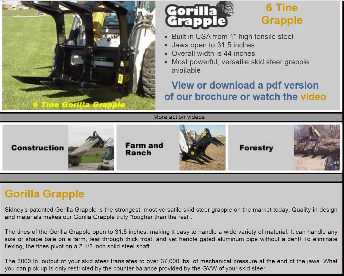

What is the travel distance of the gorilla grapple tine tips full open to full closed? What is the length of the cylinder that moves them? Just wondering how you got the very impressive 37,000 pounds of force at the tips! I know some on here doubt that claim. You can easily verify by answering these two questions. We already know it's a 4" cylinder at 3000 psi.

What is the travel distance of the gorilla grapple tine tips full open to full closed ? It would be hard to measure the arc of travel. Full open is 31.5 above the lower tines. Full closed is 3 or 4 inches below the lower tines.
What is the length of the cylinder that moves them? 8" stroke. Here is a picture from the day it was delivered, 1-26-2011, that shows the geometry involved:
Just wondering how you got the very impressive 37,000 pounds of force at the tips! From the manufactures Website that I posted the link to in post# 30, that the naysayers didn't click.
Here is the link:
Heavy Duty Grapples - 6 tine, 10 tine and 10 tine wide attachments for skid steers - Sidney Manufacturing

Here is a snip from the Website for those that don't know how to click a link:
   / When is a Grapple a Tree Shear? #94
I clicked on the link, and I still don't believe it. My shopvac is rated at 6.5 hp, but I don't believe that either.

The marketers for the gorilla grapple pulled a fast one. They used the number for cylinder force for a 4" cylinder at 3000 pounds and indicated that this is the force at the ends of the tines. However, based on the dimensions you shared, the force at the end of the tines is on average about 1/5th of the cylinder force, or about 7500 pounds. The force would vary through the the arc as the cylinder angle changes.
