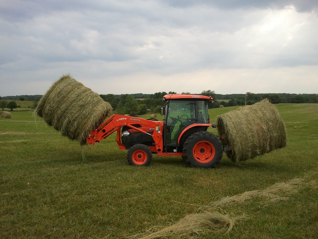

My L5740 Grand doesn't have any problems. These were supposed to be 5x6 bales might only be 5x5 though in is pic.
   / when is is big enough to handle a 1200 lb. round bale #7
The Kubota L4600 is a very nice 'basic' tractor. I personally like 'basic'. It would have no problem with 1200 lb bales. L3800 is a touch too small.
