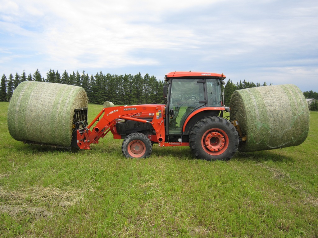

Here is my L5740 with 2 x 1200 pound bales. I previously had an L3710 which could do okay with the bale on the rear but did not feel comfortable with the additional bale on the front. This tractor is out of your price target range but I don't know what it would be without the cab. Also, I don't know what the front wheel bearing capacity is. Sure, it can handle what the loader will lift for general loader work, but will they stand up to load and carry. That would be a concern of buying a small tractor. By the way, the standard loader with my pallet forks is marginal on loader curl. On the heaviest bales the angle shown in the picture is the limit. Beyond that mechanical advantage of the curl linkage drops so it goes over relief. I imagine it would have the same problem with a spear on front instead of the forks although I don't find it a disadvantage. I don't need to tilt the bale any more than shown and the loader has plenty of lift capacity to raise the bales to the second tier on a trailer. Third tier requires one of our larger tractors.

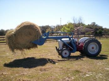

here's a pic i like posting. this is my 1955 ford 850,, it has a single boom loader ( 1-arm, ford 722 model ).. that bale is a large tifton.. dry but medium heavy at about 100#.. rolled off wagon accidentally when parking the trailer in the pasture.. split the wrapping too. it is ratchet strapped into the bucket to hold together. right up within a few pounds of the operational max of that old setup.. but works.. back before i had a heavier 2 post loader, that 850 fed out about 15 rounds a year
