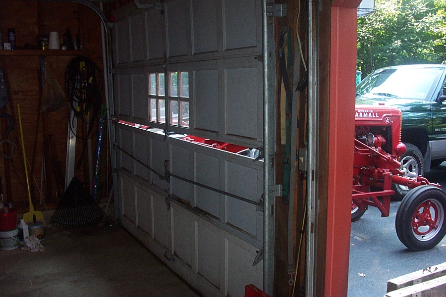

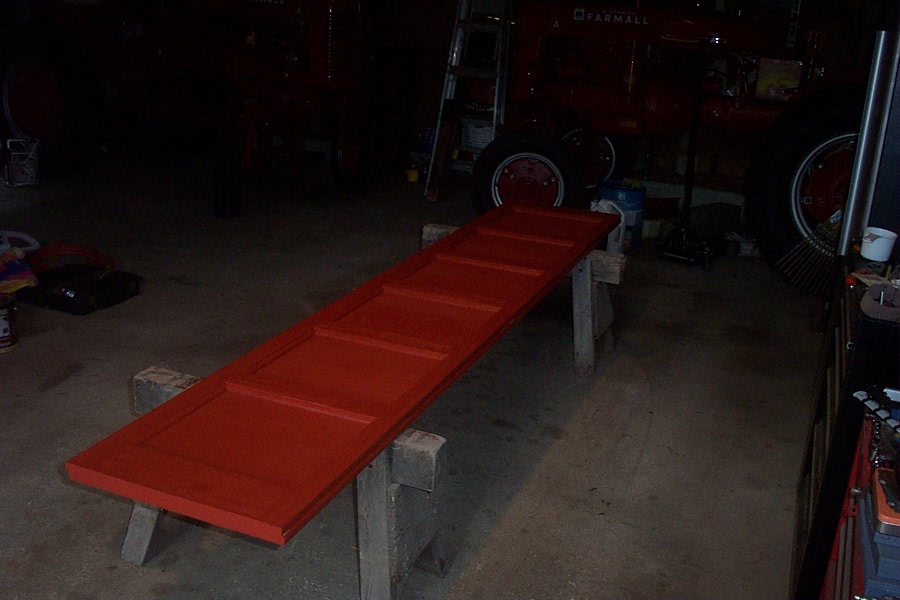

Well, we got er done ! ;)

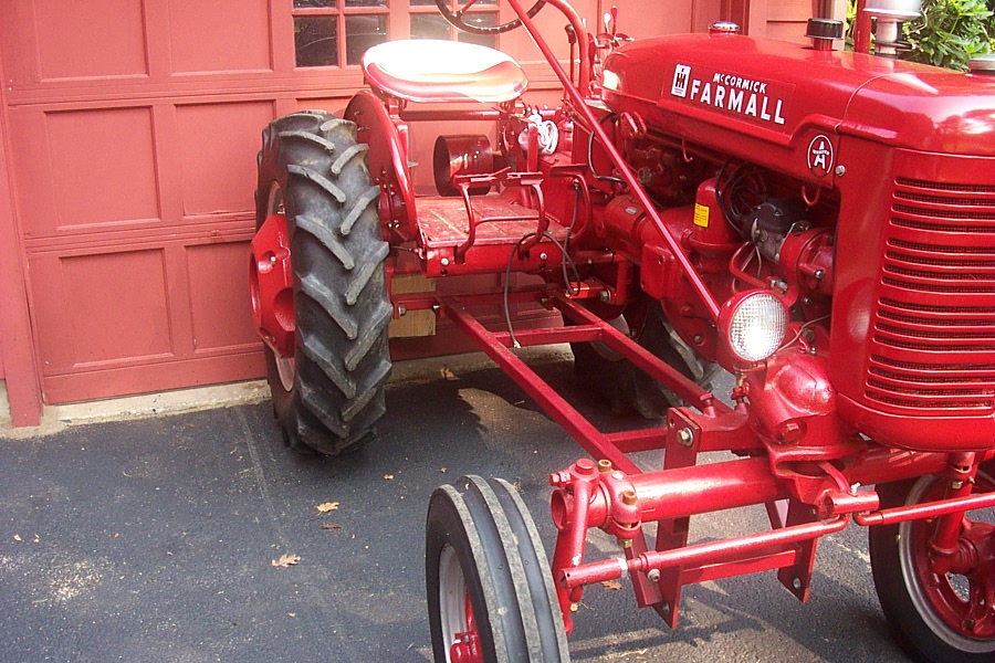

I had the get one tractor in the story, so we used the 49 Super A this mornin to keep the bottom panel held down while I replaced the bad panel.
I just backed the tractor up next to the door and fit a scrap piece of 2x8 between the drawbar and the handle on the bottom of the door ! :) Then I disconnected the bad section and lifted the two upper sections just up far enough to get the bad panel out of the opening.
Now I have to stain the whole front of the garage to match the new panel ! :( And the whole front of the house also ! :rolleyes:
The good news is that this is the year that the front gets done anyway ! :)
Thanks for the headsup on the torsion spring ! ;)

Scotty, great job. That section is a perfect fit. I see what you're talking about with the fading color difference. I like your way of keeping the bottom sections down! Nice tractor by the way!:D
