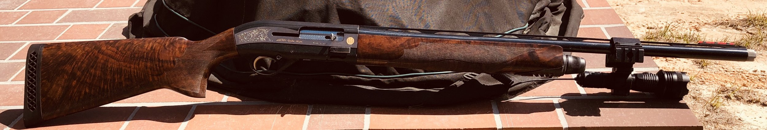

George, you never dress green wood. It should be air dried to at least 20% before the wood is kiln dried.
If the air drying is on slats, stacked for suppert, the wood should stay straight. It may take months to dry in an enclosure.
Now if you are going to put wood in an AC or heat environment, stack it inside for at least 30 days first, it is going to shrink. I do not care what the moisture meter says, it will shrink. Then at 10% or less, plane it and cut and sand it.
If you want to kiln dry it, it should be 10% or less, before you saw, sand and finish it. That is the parameter for a gun stock.
A moisture meter should have settings for different species, if you get one, do use the white oak setting.
I buy furniture grade at 10% or less moisture and store it in a temp controlled environment, on racks.
This is my 391 Beretta Silver side Sporting 20” with my stock wood, it is a fair piece of wood.
WOW!! That is more than beautiful!! I am VERY jealous.
Gorgeous wood on that Beretta.
