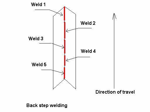

What's that? Is that staggering the stitches side to side like this? _ッ_ッ_ッ_
Back stepping is one of the most important techniques you need to know to be a top notch weldor. You have to plan out your welding before you ever start, you can't just drop your hood, and start pouring wire / rod. Or you'll end up with a big mess!
This is back stepping and skipping around. Two very important things to do, to counter warping.

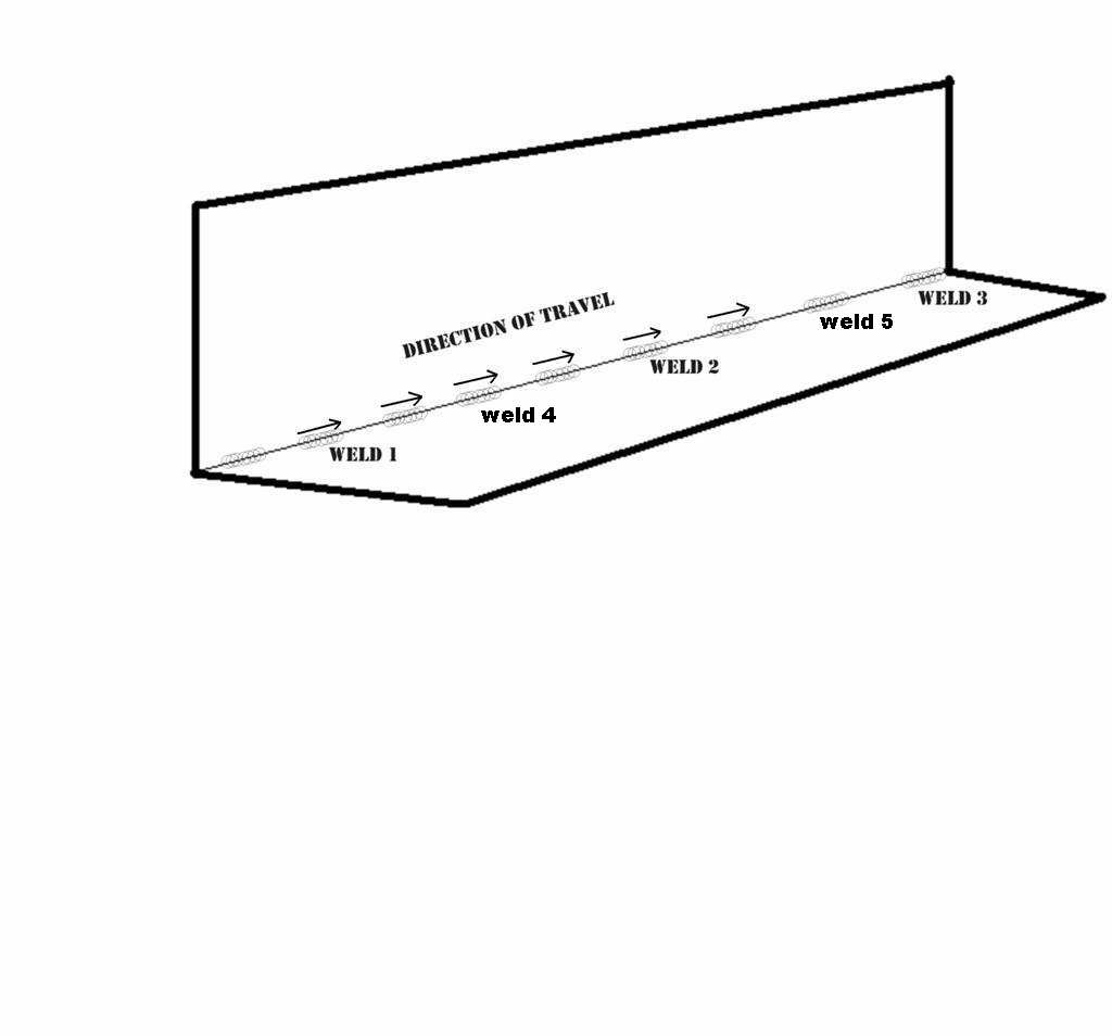

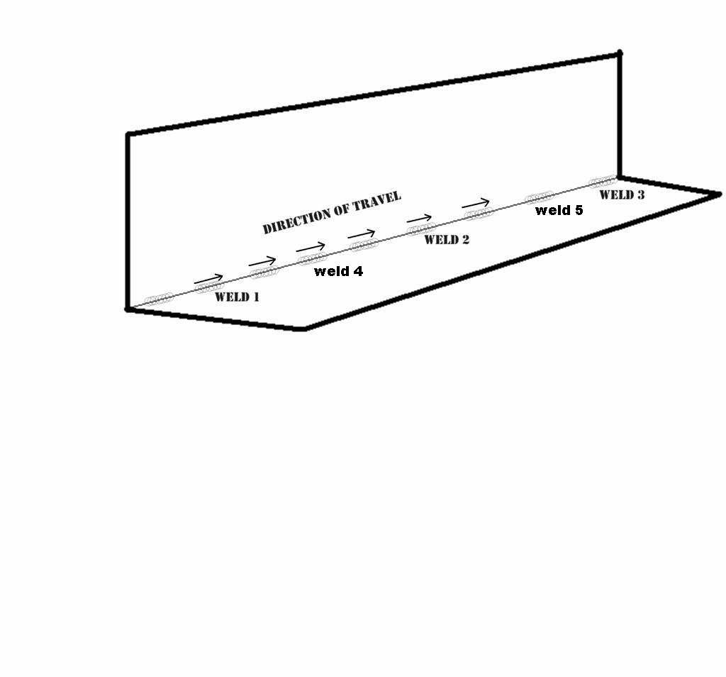

Maybe this is a better illustration of what I'm trying to say. I left a little gap between welds on purpose.
Welding vertical up will really get hot at the top of the plate if you start at the bottom and weld all the way to the top. Back stepping breaks up the heat line. I back step everything I weld, but I also try to skip around a lot too!

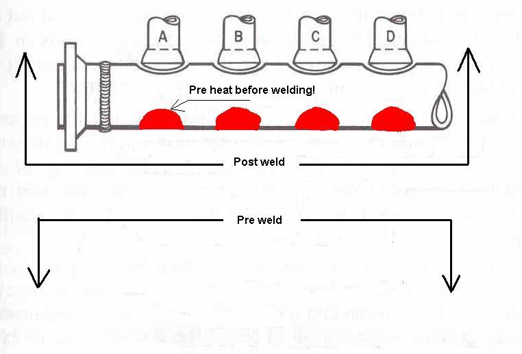

You're welcome Mercmaniac! Remember there is more to this puzzle.
In most cases you're better off to heat shrink before welding. Say you wanted to weld these 4 risers to this pipe. If you make even one of these welds much less all four, the pipe is going to curl upwards big time! So you want to heat shrink on the opposite side of the weld zone before welding. ;)

/ When to stitch weld vs solid bead? #12
Hi, we sometimes weld a bead inside the bottom of the pipe through the cut out opening BEFORE welding the outlet pipe or thread-o-let on depending on size.
/ When to stitch weld vs solid bead? #13
Wouldn't that cause turbulence in the flow?

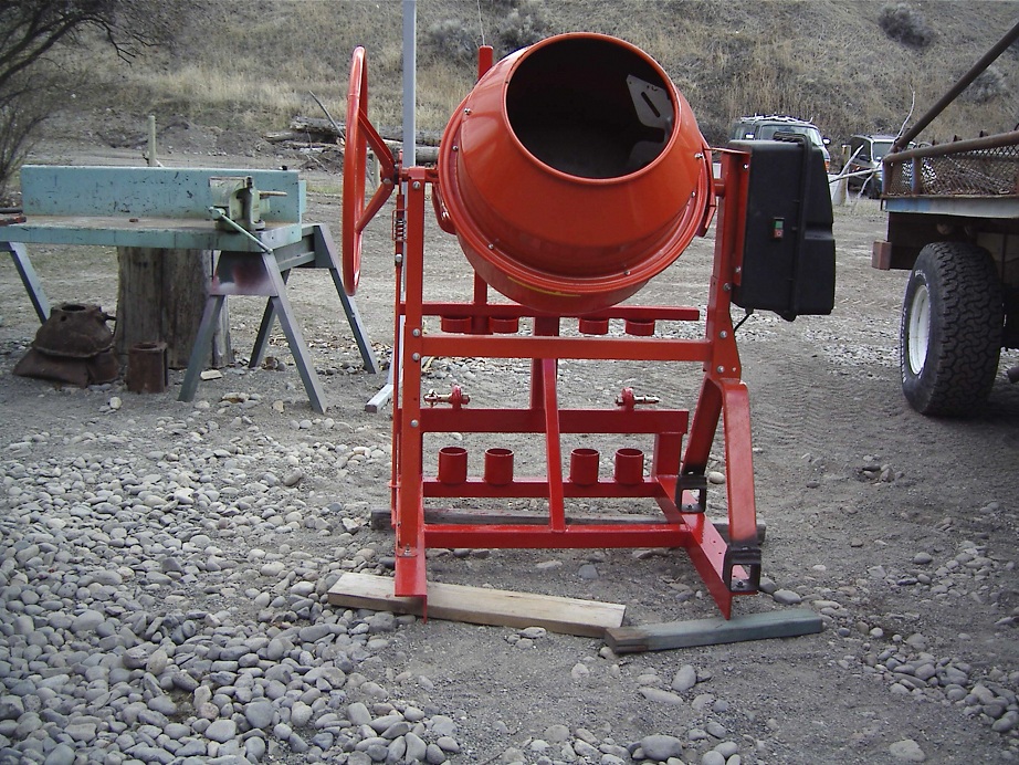

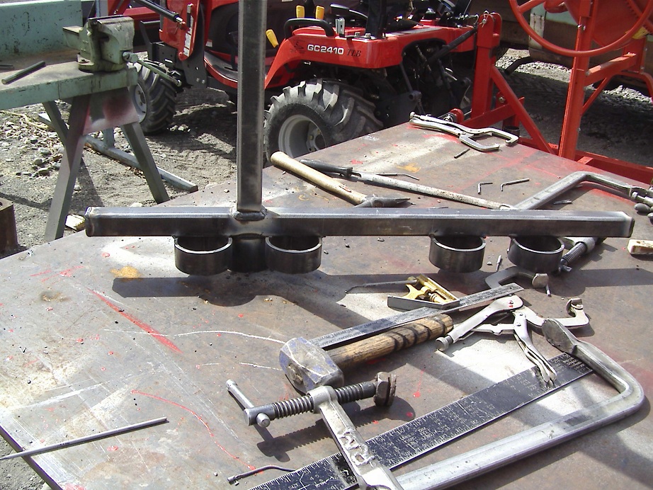

All done, I bet it's warped to beat the band, but hopefully the stitching kept it to a minimum. I was welding 2x24 strips of 1/2" plate in a T orientation to the bottom of my welding table top. They connect the two halves of the table top, leaving a 1 5/8" gap down the middle to allow clamping in the middle of the table. Got that idea here someplace.
Ian
Shield,
One of the tricks we used to do was tack a piece of channel on edge on the under side, then drive a wedge in the center of the branches with 1/2" gap to put reverse tension in the cold side. On pipe we did that after cutting the holes. WE did a lot of step welding to keep the heat down. Usually required a lot less spot heating to get it back straight.
Ron
/ When to stitch weld vs solid bead? #16
Wouldn't that cause turbulence in the flow?[/QUOTE
Don't think turbulence is a issue. Run Hot no real weld build up. This was only on chilled and hot water piping , not critical ASME code work. Actually some of the s$%ty pipe we got there was more restriction from the seam ! Most cases we use tees, does a professional job although some engineers would allow you to saddle up to half the diameter. Hard to make it look good.
