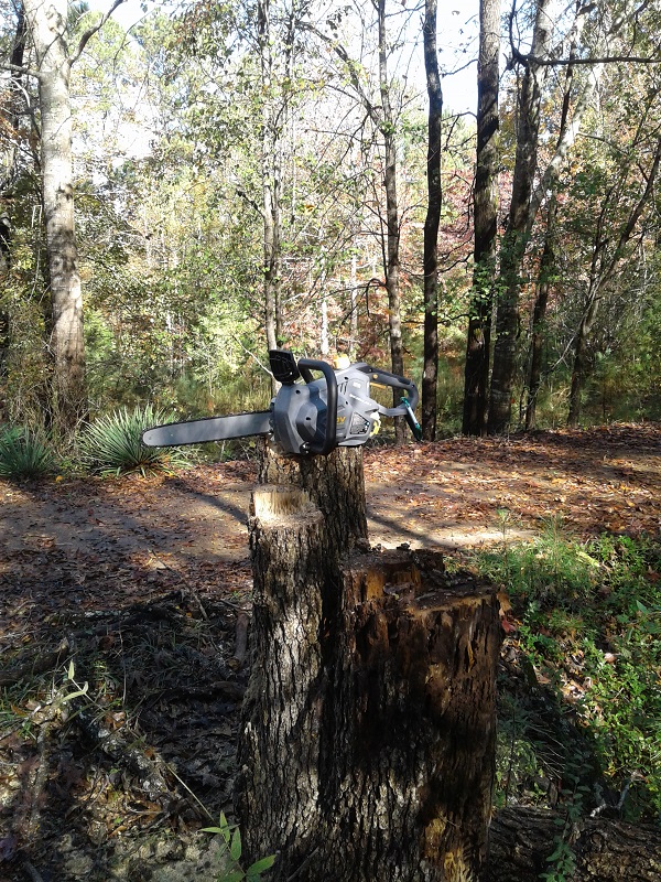

Including "chainsaws on a stick" I've got about a dozen chainsaws, from 120CC down to 35CC. About 3 of them are on long term loan to my children. Three of my saws are electric 40V.
My most recent, a Lynxx 14" is just slightly less powerful than my Stihl 021.
Yesterday I cut a few trees down with it.
This morning I started bucking them up before the rain came. Probably worked about 20 minutes with it, battery only went down 1 LED. It's a great substitute for my Stihl 021.
