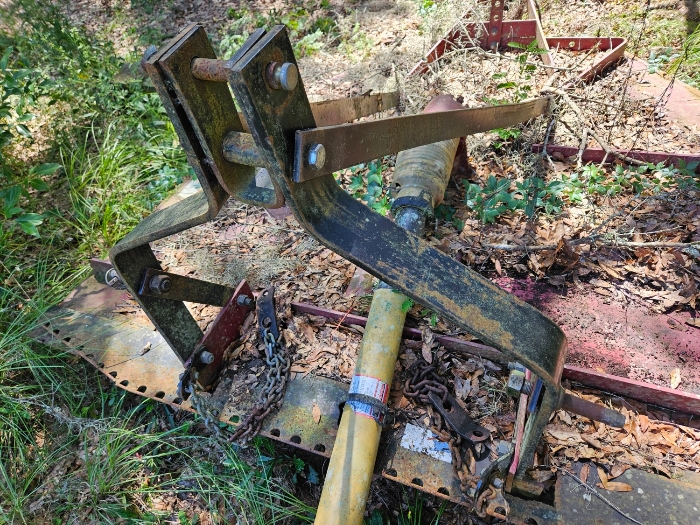

I have neglected my old King Kutter bush hog, and now I want to hitch it up.
This bush hog has two mysterious chains up by the front. They have bent bars on the ends of them, and the bars have holes for pins or bolts. They don't fit the pins the tractor attaches to. They're too small. I can't find anything else on the tractor or attachment to attach them to.
Anyone know what they are and where they go?

My guess would be check chains for a machine that didn't have a conventional check chain system.

Normally, the chains are used instead of the top link. This allows the tractor and mower to not get into binding situations (mow across ditches).
Would mount high on the back of the tractor... Rops or by the top link.
google "mower check chains" then look at images...

Is it likely the former owner put the chains on the tractor to keep the cutter from dropping? YES.
Often the check chains are suspended from divers types of fittings attached to the ROPS pivot/fold pin.
The big name brand is ZERCO.
The chains substitute for Three Point Hitch POSITION CONTROL.

Those are limiter chains. They would mount on the top link pin at the tractor.
They do not replace the top link.
Use to see these in use a lot on the older ford 8 and 9 n’s
They limit how low the implement will go down.
/ Where do These Chains on my Bush Hog go? #10
Bingo, you need a longer top link pin on the tractor end. Slide on of the tabs on the pin put the pin in the tractor attaching the top link and then the last tab on the end . Adjust the links so the front of the mower doesn't go too low, or if your tractor has position control toss them in the corner of the shop.

There is a U-shaped part that attaches to the top link. As you can see in my photo, this part is held in place rigidly on my attachment. Whoever assembled the cutter ran two bolts through it. This is wrong.
The U-shaped part is supposed to swing. It allows the bush hog to lift when the tractor hits a low place or the bush hog hits an obstacle. Yesterday I kept digging trenches with the rear wheel of the attachment because this part was not free to move.
If the part is in there wrong, the bush hog will dig into the ground, and the long support bars on top will bend, as mine have. It can cause the rear wheel to be torn off.
I'm going to remove it and put it back the way it should be. I don't think there will be any need for chains once the cutter is assembled the correct way.
