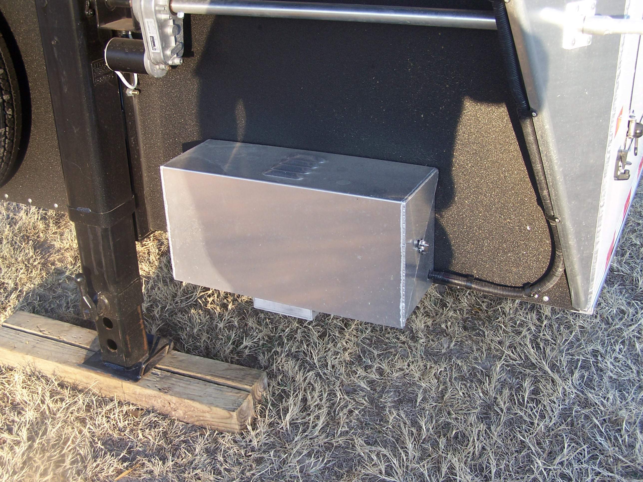

If I had the authority to stop and inspect every pulled trailer on any highway, I would venture a guess that 95% of the emergency brakes didn't even work and therefore it didn't make any difference where the break-away cable was attached. Might as well cut it off and throw it away. Why? Because I'd bet that 95% of the batteries on the trailer don't even exist, or the battery is old and has defective cells or the auto-wiring is such that the battery never receives a charge from the vehicle pulling the trailer. I've seen many an empty battery box. I've seen batteries that were probably at least 10-years old with both terminals fully corroded over. I've seen wiring installed for the vehicle that probably incapable of carrying enough current to light a small bulb, fully incapable of charging the battery. And, I doubt in 1 in 1,000 of those stopped trailers have ever had their break-away cable pulled out to verify that the brakes worked.
   / Where do you attach the break away cable? #13
One in a thousand ?
OK, I've been called FAR worse things than that (-:
On my gooseneck trailer I pull the pin every time I do brake adjustments.
The battery gets an implicit check as I actuate the brakes with it using 40 ft or so of bell wire - so I can stay squatted at the wheel arch.
Typically a couple of times a year.
The 2 horse trailer, not so much now that I have put self adjusting backing plates on it.
If you are in a State where trailer inspections are required it is little/no problem to pull the pin and test drag the trailer a couple of feet down the driveway the day you take it for inspection - BEFORE you hook up the trailer plug, so you can verify that the battery has held a charge.
BTW, the Union Connecticut weigh station will check all that for you.
I have heard that they will even time it out to the full 15 minute requirement.
They have a reputation for chasing down EVERYTHING that doesn't stop there, even little pop-up campers; a trailer is a trailer, is a trailer, etc.
