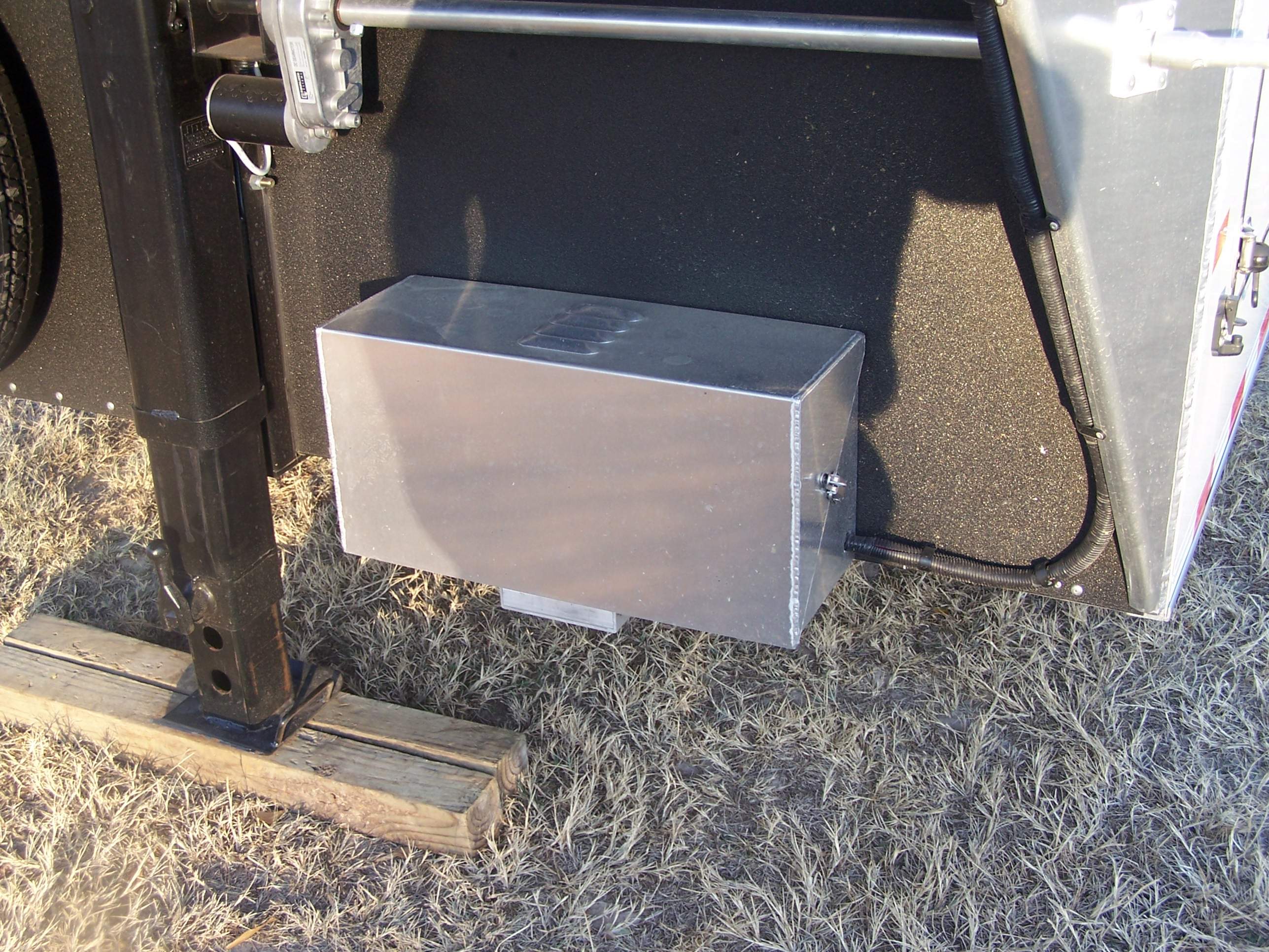

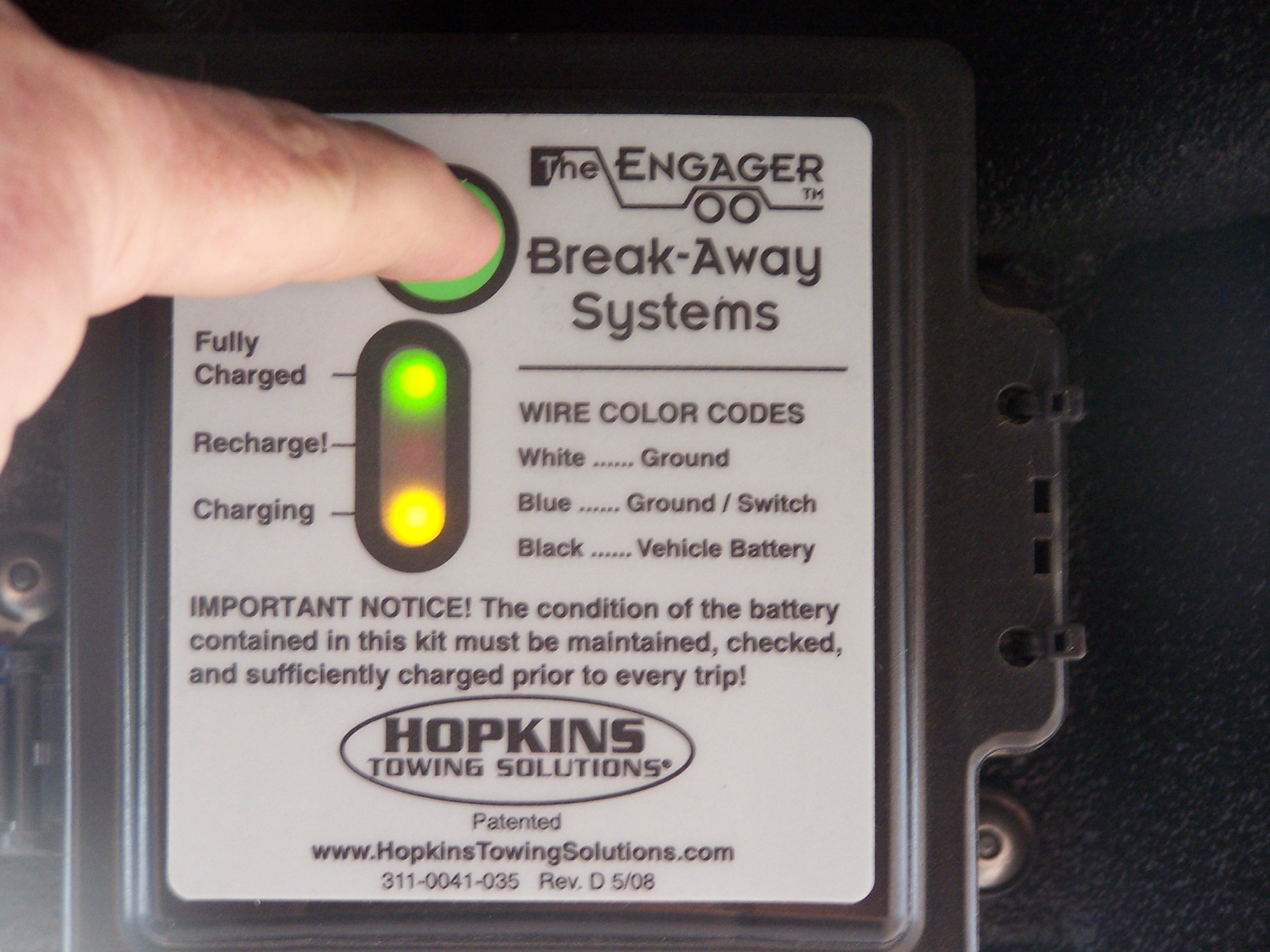

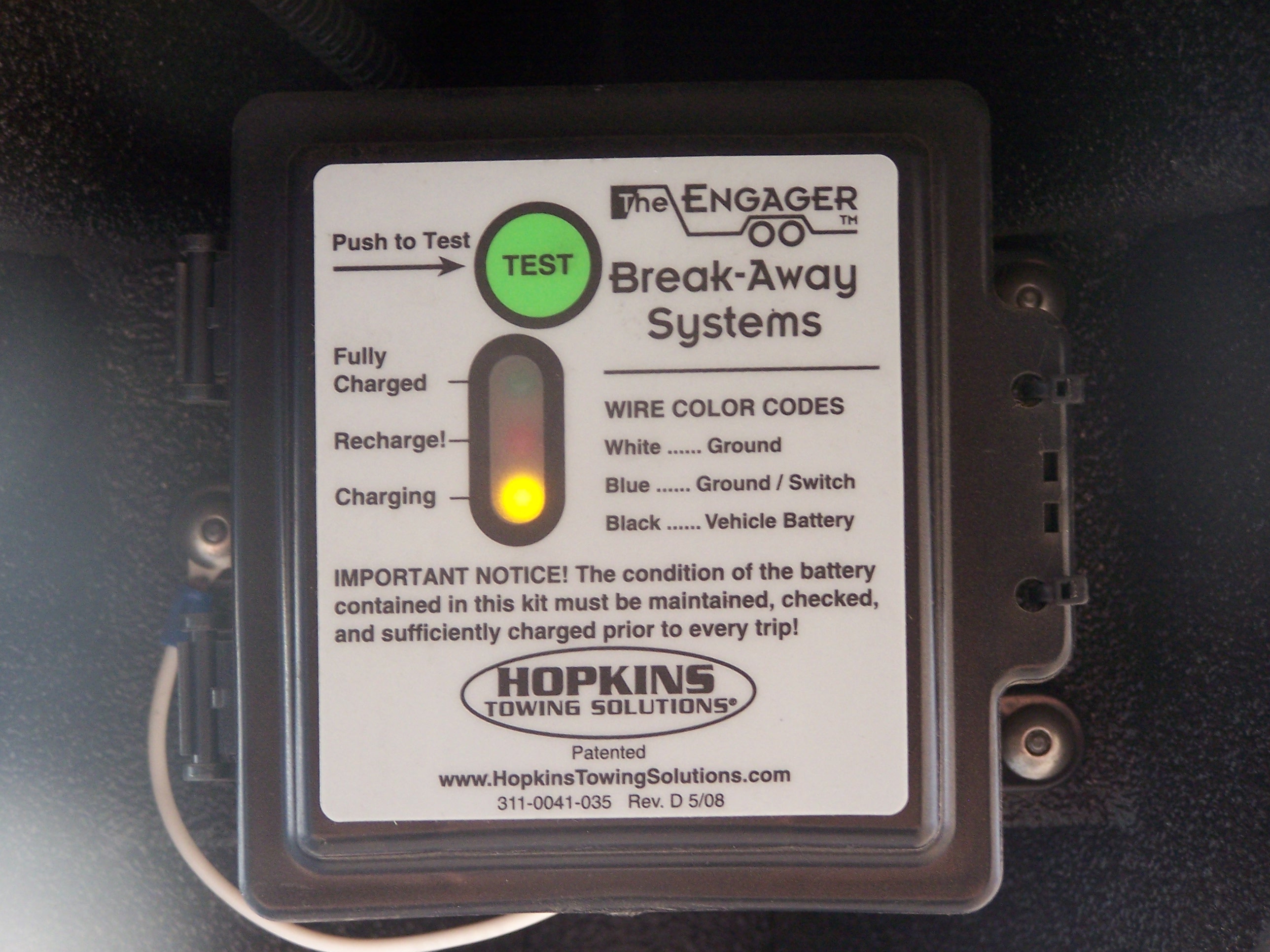

   / Where do you attach the break away cable? #23
Here is break away system on my new Sundowner horse trailer. It is connected to the batteries on the trailer. It is attached to the gooseneck so you see it when you hook up.
