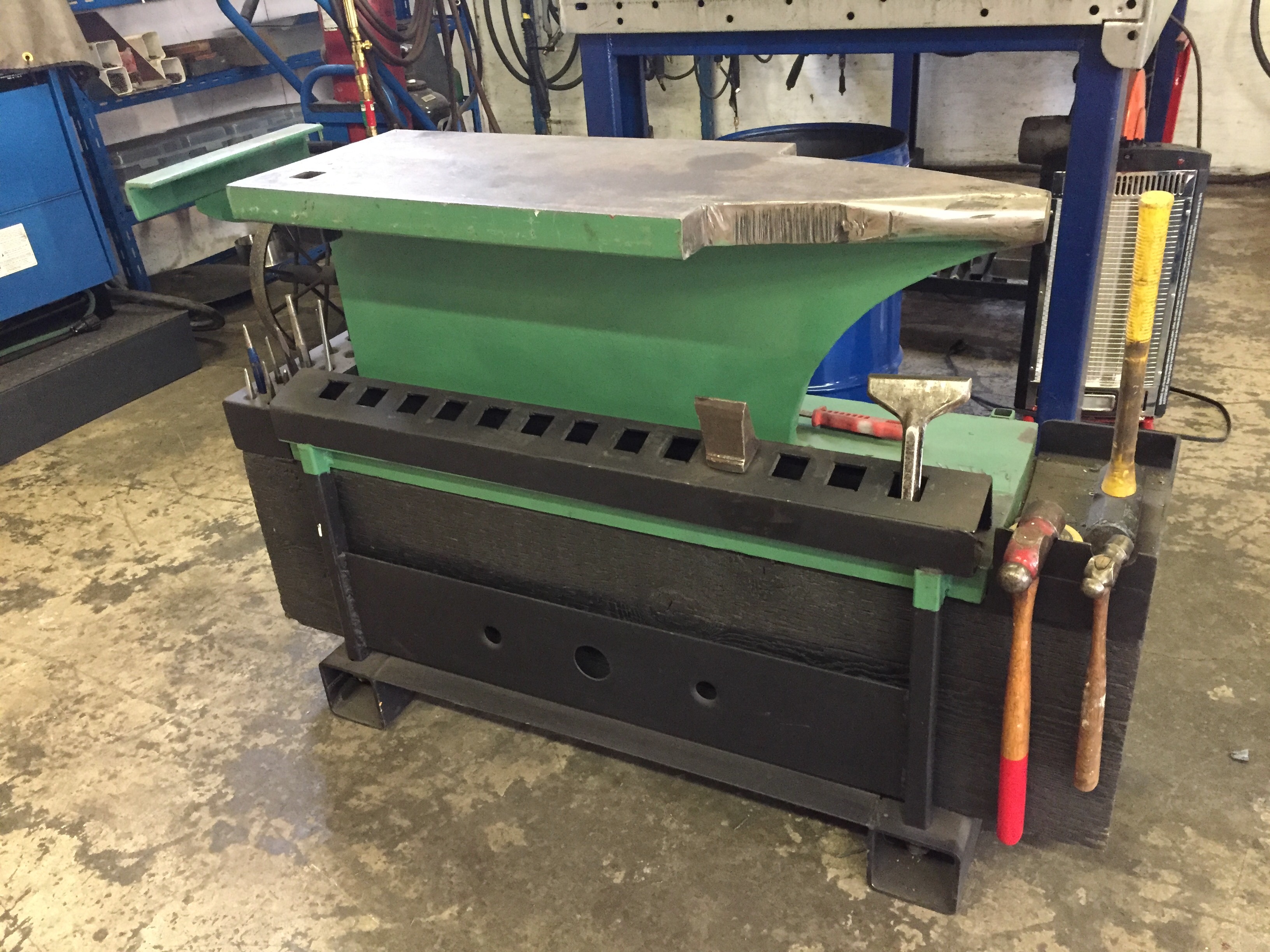

Back to rails. If you'd like to build a anvil with it, I'd getting the heaviest you can find. I'd say 90 would be minim.
   / Where do you buy your metal stock? #114
I apologize as this is still slightly off topic but for a decent ASO (anvil shaped object) keep your eyes open for heavy I-beam.
I don’t use mine for forging but I find I use this for all “ cold” work such as straightening and a surface for center punching.
