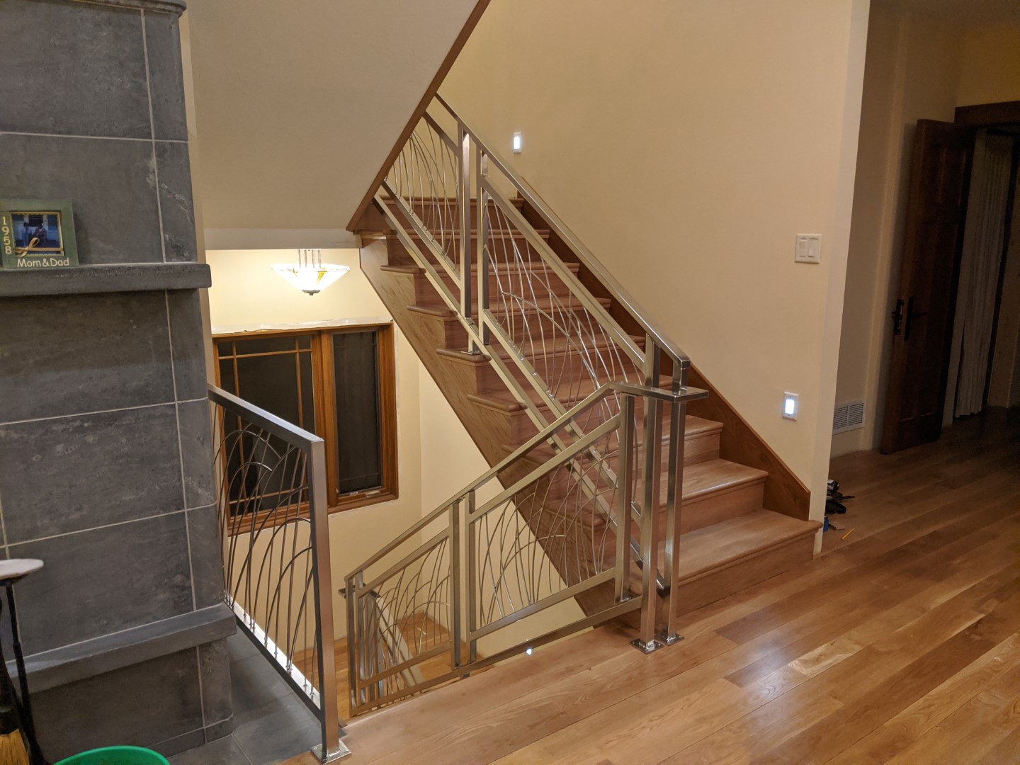

But for me, the best place has become Steel Towne as I am just over the border, behind the Cheddar Curtain. They have a main facility near Eau Claire and a branch close by in River Falls that I use. The RF location has expanded a lot over the past several years. Their prices are WAAAAY better than the other 2 I listed and they are great at dealing with small users. You say I want 2' of this angle, they fire up the plasma and hack it off for you. If you want an exact cut, they can put it on the bandsaw too, but they charge for that. They can do some forming and welding too. If you call ahead, they can get basically anything you want in a couple days. I used them for the 304 SS for all my railings here as they were almost half the price I was quoted from Discount/Coremark. Yes, that much lower. And they are great at customer service. Here is a shot of the railing project from that load of steel. Now this was a sizeable order, so I did send around for quotes from a few shops, and these guys always win. Yes I love working with these guys!
Edit: And yes I have bought from menards/HD/etc for small stuff, which is fine for very small orders, if they have what you need, and especially if you need it quick.
Very nice stair railings, did you freehand all of the interior radius materials, and are they sq. bar stock or round rod.
