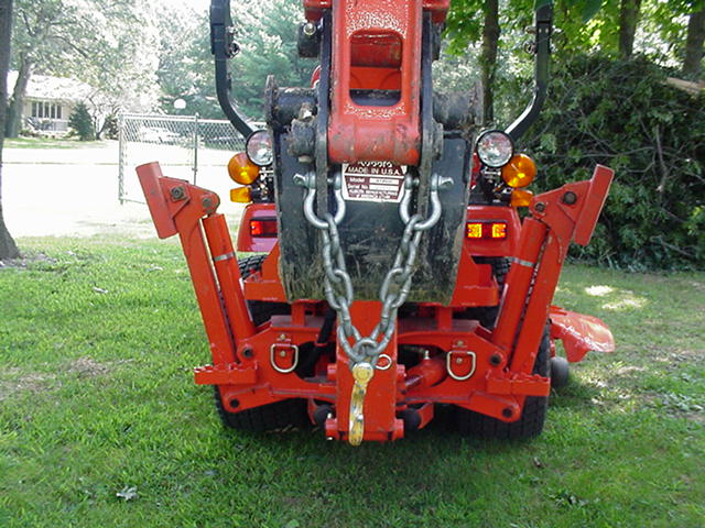

Is this the correct place to connect the chain?

Looks OK to me, but I think I would be afraid the chain would get pinched in that linkage. The construction guys usually have a hook on the back of the bucket that they attach chains and cables to. I think if I had a BH thats where I'd want it so I could use the bucket curl with the chain.
   / Where do you hook your chain on a backhoe? #3
I agree with Micro.. that said, I don't have a hook on mine /forums/images/graemlins/frown.gif
Depending on what I'm doing.... no in fact MOST of the time, I'll take my chain and either wrap it through the bucket teeth so that I can use the bucket cylinder to help raise/lower, or I'll wrap it around the bucket. Usually, it's through the teeth. This way (like your pic) in what appears to be a pulling situation, the overall forces are on the leading edge of bucket.
I've hooked onto that piece you show in your pic a couple of times and I can't get rid of MY fear/feeling that I'm risking bending it.
My thought is, by utilizing the bucket itself, I'm spreading the load out to the bucket attachment points, rather than possibly just that one piece.
I also like that by wrapping in/through the teeth, when I'm done I can just wiggle the bucket back/forth and remove the chain from the bucket without having to dismount machine.

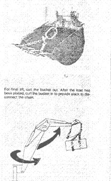

The Kubota manual for my 4560 backhoe (predecessor to BH90 for the larger L10 tractors) has an entire section with photos and diagrams showing factory-recommended chaining technique for what they call "craning" with the BH.
Don't know if that carried over into the BH90, but they describe wrapping a double loop of chain around the back of the bucket and the teeth, as one of the other folks here suggests. The idea would be to disperse the load.
Also lots of well-founded warnings about the danger. Particularly with off-center lifts, there is a major instability risk.

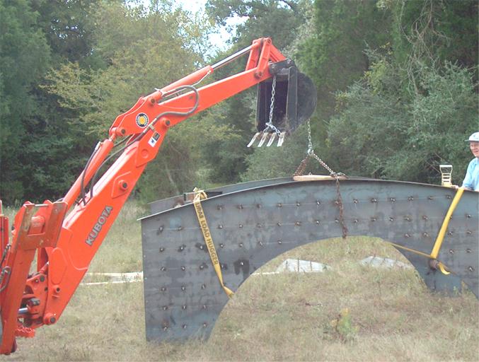

Granddad, any chance of a scan of the diagram. If not, I think I will go with the double loop around the bucket. I don't feel comfortable with the chain like it is in the attachment. If the bucket is tilted, while placing Harv's bridge, the chain could bind or break or something could bend. Since someone else will be at the controls I need to make it idiot proof. Thanks all.

Grandad, Thanks, got the e-mail. Attached is the photo.

Grandad, as you can see in the attachment I actually followed instructions. It worked great. I was able to raise the bridge up and down by moving the bucket. The boom and dipper stick were also used to lower the bridge down and out.
Thanks for the scan! /forums/images/graemlins/smile.gif
