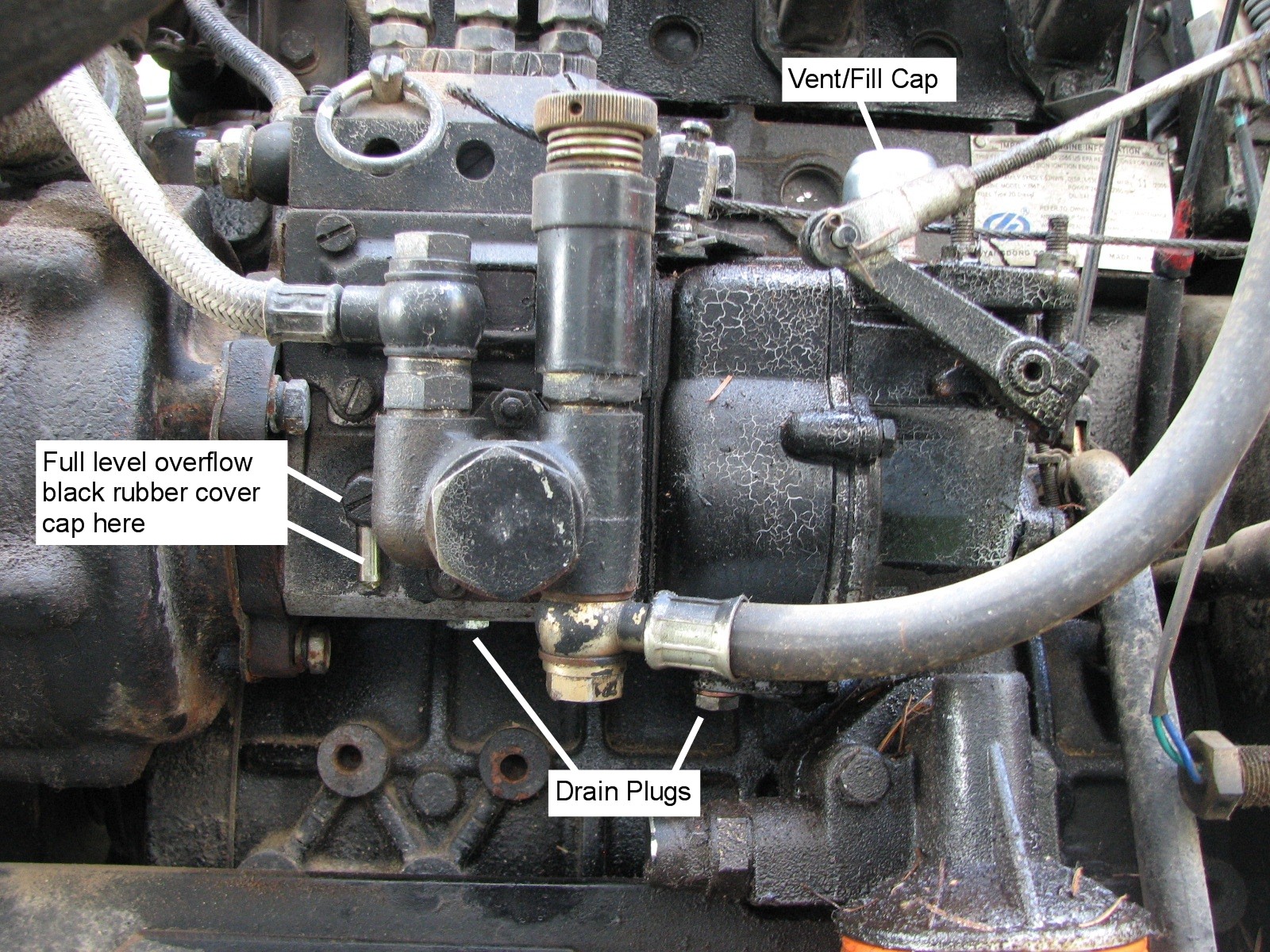

Don't know if it will help you, but here is a labelled pic of the injector pump on my Jinma 284. It does not have a dipstick. After draining the fluid from the 2 drain plugs, fluid is then added through the vent/fill cap. When the unit is full, it begins seeping out of the full level overflow if the black rubber cap is removed.

On my Foton with a Laidong KM385 engine, the pump is very similar like in the photo above. The difference is, I have one drain bolt on the lower part and a dip stick near the pivot of the lever below the fill/vent plug. I change the oil (15W40 diesel oil) twice a year due to fuel dilution and level increase.
Arecibo, your pump should be like mine. Also, the first time I pull the little dip stick, it is always dry, after the engine run and cooled down. Then I put it back and pull it again out, then the level shows.
Check often levels, the engine for oil becoming thinner if the fuel pump seal is leaking as you say.
No oil in the pump and too diluted engine oil is harmful obviously.
Good luck.
Jacques
