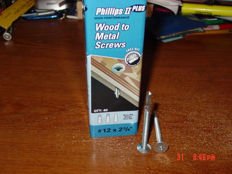

Here are the screws that I used at first. They are a self-drilling & self-tapping #12 x 2 3/4" screw, really too small but it was the largest diameter (and longest) they had at Lowes.
My advice - DON'T USE THEM! They worked ok but I don't trust them. They drilled through the angle iron supports (joists) ok, but what I found was that I had to apply some pressure on the drill but when the screw broke through most of the time I was pushing the screw all the way through before I could let off pressure and give the screw a chance to cut the new threads.

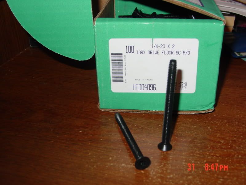

These are self-tapping 1/4" x 20 x 3" screw with Torx heads, and require a 13/64" pilot hole. So, when I get some time I'm going to back out the #12 screws in it now, drill a pilot hole, and then run these in. Hopefully they will do better and cut threads like they are supposed to. Also, these are 3" long, the others were 2 3/4" and just a bit too short really. I recommend you get at least a 3" screw, assuming you are going to use 2x lumber on the deck. Unfortunately, I don't have any pic's of my trailer with the new deck lumber on it saved on my camera or the PC, and the trailer is at my folks place about 60 miles from me now.
I saw those at Lowes and bought 1 box to see how they work in the middle of the boards. I'm going to use stainless bolts on the ends. If those will just keep the boards from flopping, they should be okay...I hope.

I have done 3 different trailers. I always had to drill a pilot hole. It really is not that hard to drill. I bought a couple of Vermont American bits from Menards. Not very expensive but seemed to hold their sharpness well. Drilling from the top down lets me place my weight over the drill. Don't have to push too hard and doesn't take long to drill a hole. Just be careful because it will grab hard just as the bit finishes the hole. IMHO, it would be harder to get beneath the floor and drill up the old holes. The channel iron of most decks won't let you drill straight up. It is dirty from below, awkward to push ect.

i'm not sure if you want self drilling, or self tapping. i have never had any luck with the self drilling ones on anything even close to 1/8". i've used these self tapping ones on a few trailers now, and i love them. i've used them on 1/4"+ steel and they work well. you have to drill a 13/64" (i think - working from memory) hole, but they cut their own threads after that. they are very hard and i've never had one strip.
1/4 x 2 1/2" Plain Finish Flat Head TORX Flooring Screw | Fastenal
