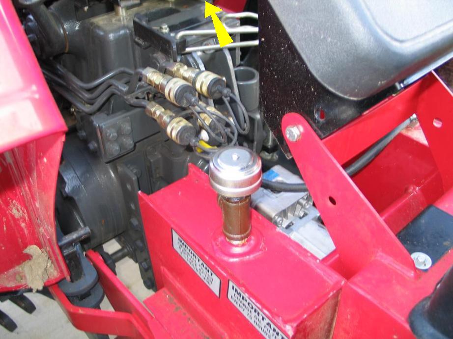

Actually, that's the way it is on the 6000 as well. The pull out (with the O-ring) is to check the transmission gear oil. The hyd check on the '00 series and possibly the 4530, is the plug to the right and under the rear of the seat (I think its a 4 sided about 1/2 inch open end job)....BobG in VA
   / Where is the hydralic fluid level check? #8
This is where the level and fill is on the 00 series as Bob is describing. Sorry, you can tell I didn't take this picture for this purpose but it should give you an idea.
