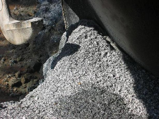

   / Where should we locate the well? #14
Spiker,
You're right about finding the "spot" but this part is not, according to my hard rock well driller. </font><font color="blue" class="small">( if it IS solid granet then you will not get much water below it unless it has fractures for the water to penetrate it. not to mention getting the drill through it)</font>
He told me that is the best place for hard rock wells. You just need to locate a fissure in it. Their drills are like a hammer drill with carbide knpbs on them. The cay cut through granite like you can't believe. If you're lucky enough to hit quartzite (sp) that an even better sign. He said the canyons and ravines that carry water are the worst to drill because the rock in those places have been squeezed together so tight that there are very few fissures in those locations. Going up on a ridge is a much better alternative. Funny, I thought the same about drilling in the ravine until he explained it to me.
Here's a picture of when he started to hit the quartzite rock.

</font><font color="blue" class="small">( He said the canyons and ravines that carry water are the worst to drill because the rock in those places have been squeezed together so tight that there are very few fissures in those locations. )</font>
OK, call me slow, but this just doesn't make sense to me. Ravines and canyons are caused by erosion, not movement of the plats. What would cause them to be sqeezed together?
I'm of the opinion that those locations are where the magority of the underground water suplly comes from. Rain doesn't come down heavy enough saturate the land down hundreds of feet. It just travel down there along a path of some kind. I always though this happened in the mountains from the crackes in the rock, and the the vast majoritiy of it came from lakes and rivers.
Could it also just be a story that well drillers tell to avoid having to deal with the absolute most dificult location for the to get their drilling rigs to???

I have the same curiosity as EddieWalker. What the well driller told 3RRL is in direct conflict with what I read on geologist/hydrolygist's paper indicate (published by pennsylvania water resource board). For my specific location, the ravine is a the creek. I can see the granite exposed and surface fractures everywhere. If it were less likely to have fracture below (water flow) because the rocks compress tightly together, then why is all the springs are located in the lower part of the ravine. The springs run year around to feed the lower parts of the creek which flows into the Chowchalla river. During the wet season, I can see water comes out of the rocks in the upper part too. This is weeks after it stops rainning.
I can undertand it's not practical to drill in the middle of a ravine becuase it's difficult to get the drilling rigs there. But how about just on the side of the ravine? Wouldn't it be more favorable than on top of a ridge? or a hilltop? I'm just curious.
