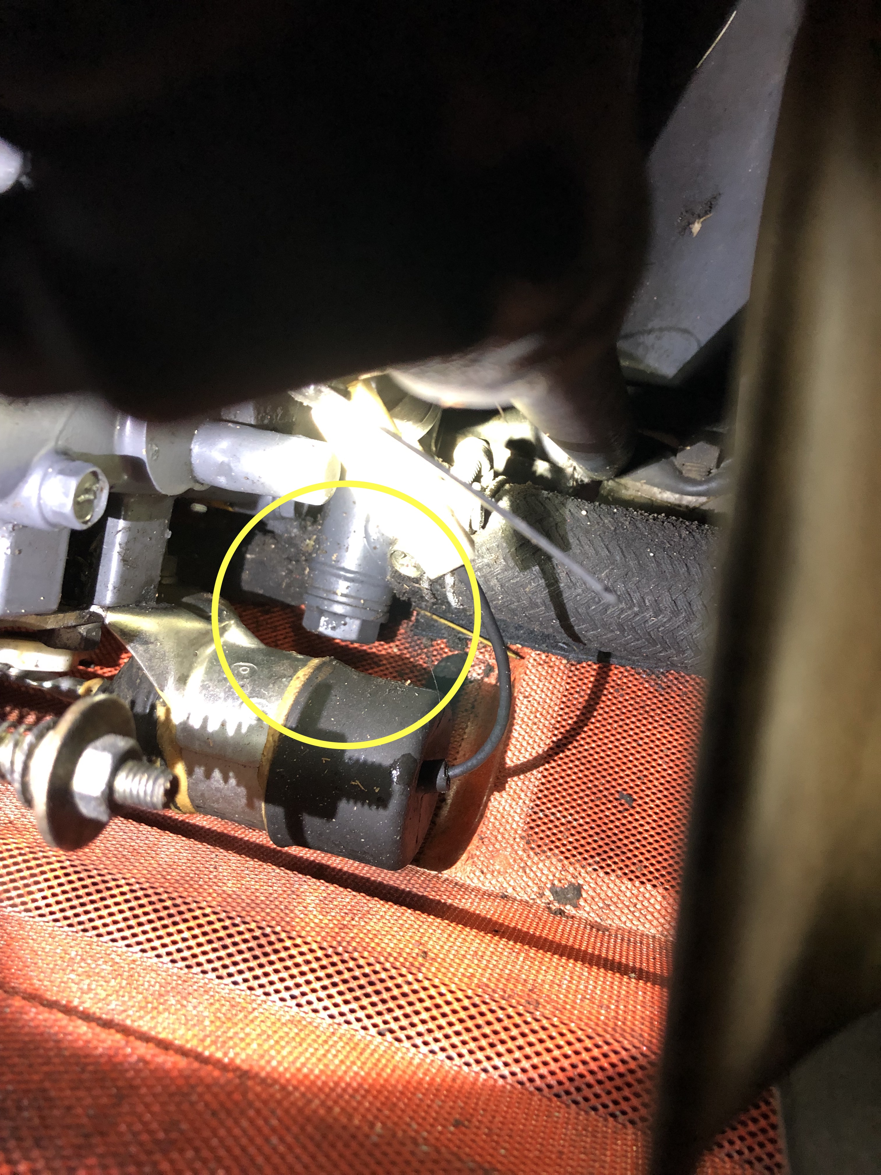

I'm trying to figure out the easiest way to add a block heater to a B2150. One side of the engine has a couple of freeze plugs, which I am hesitant to remove. I've seen mention of a plug which screws out using a 17 mm hex wrench, but can't find one. I did however find a plug with a raised hex head at the junction of where lower radiator hoses are attached, behind the radiator. Does anyone know if this is the correct (or reasonable) place to add a block heater? Hope the photo makes sense. Thanks. plug for heater?.jpeg

I think that picture is showing your coolant drain. I like block heaters and always use them below 20F or so. My 1999 TC33D and RTV had them and never had a problem or leaked. This video might help you find the 17mm plug.

Thanks. I have very limited knowledge about tractors, and I don't know what that hose is that they are permanently plugging, but it doesn't seem quite right to me. I'll check with my Kubota dealer. In the meantime, I think I'll experiment with a heat bulb.

Thank, all! After I spoke to my dealer, I've decided against a block heater. He said that my tractor is actually pretty good at starting at low temps. I'm using it primarily to blow snow so it it's really cold, I'll try a light bulb/blanket. If that's not sufficient, I'll go with a hose heater.
