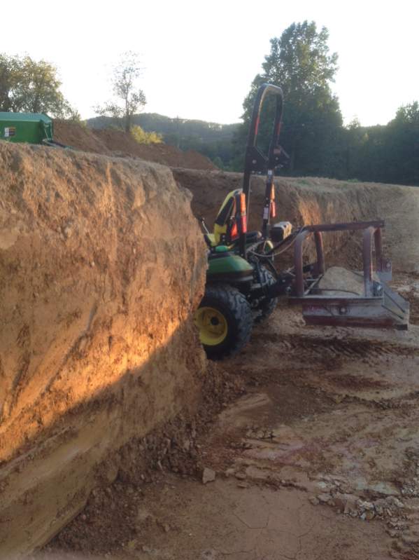

Thanks N2. I'm anxiously awaiting the ups truck. I'll be looking for something to dig or clear right away to test. Hoping I can widen the hay field Along the edges and other brush the bush hog can't get. Always needing to dig something too

I wasn't going to be using for any of those jobs. Just digging out in hard clay and sandstone.

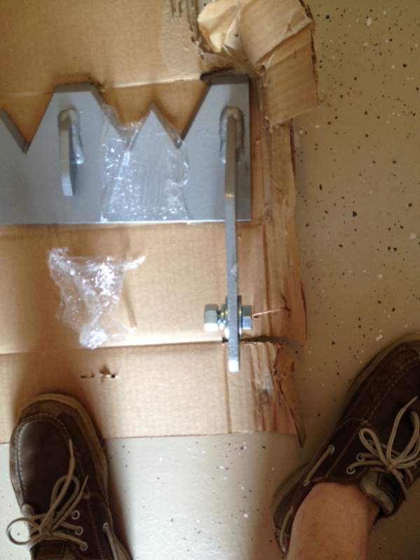

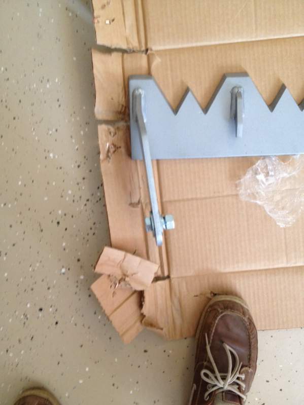

I'm looking at it and one side of the bracket looks bent? Not sure the bolt would pull it back in or be long enough.
Here's the bent side
   / where to buy a piranha bar? #29
Straight side
   / where to buy a piranha bar? #30
I don't think you'll have a problem with the bend in that attach ear. Your bolt will suck that in easily. Steel is remarkably forgiving stuff & the mechanical advantage on even a coarse thread nut/bolt is pretty awesome.
If you need to, give it a whack with a soft hammer (or a hard hammer with a hunk of 2X4 against the part) to get it close enough to get the nut well started on the bolt.
It will probably end up with a bit of a "wiggle" in the bar, but it shouldn't have any negative effect.
