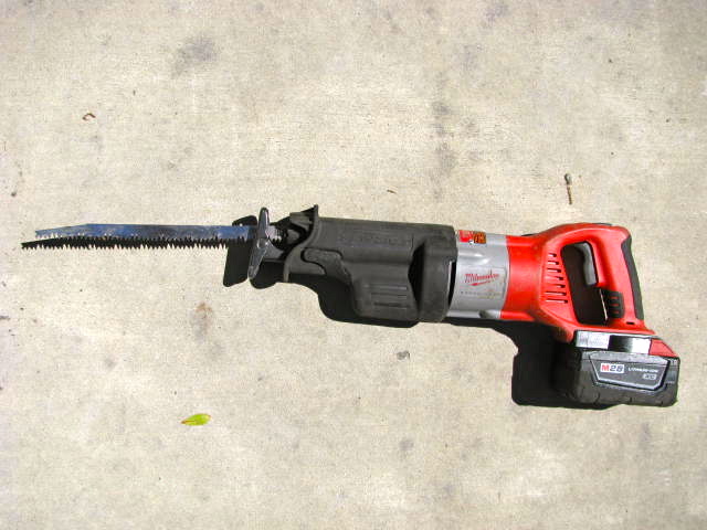

An altogether handy tool in the woods is a battery powered Milwaukee Sawzall.
Great for doing limbing. Much safer than a chainsaw.
Removes chipper chute plugs in seconds.
I bought mine on amazon.com.

An altogether handy tool in the woods is a battery powered Milwaukee Sawzall. Great for doing limbing. Much safer than a chainsaw. Removes chipper chute plugs in seconds. I bought mine on amazon.com.
Good call! I have a corded DeWalt sawzall, but a cordless would really come in handy!
