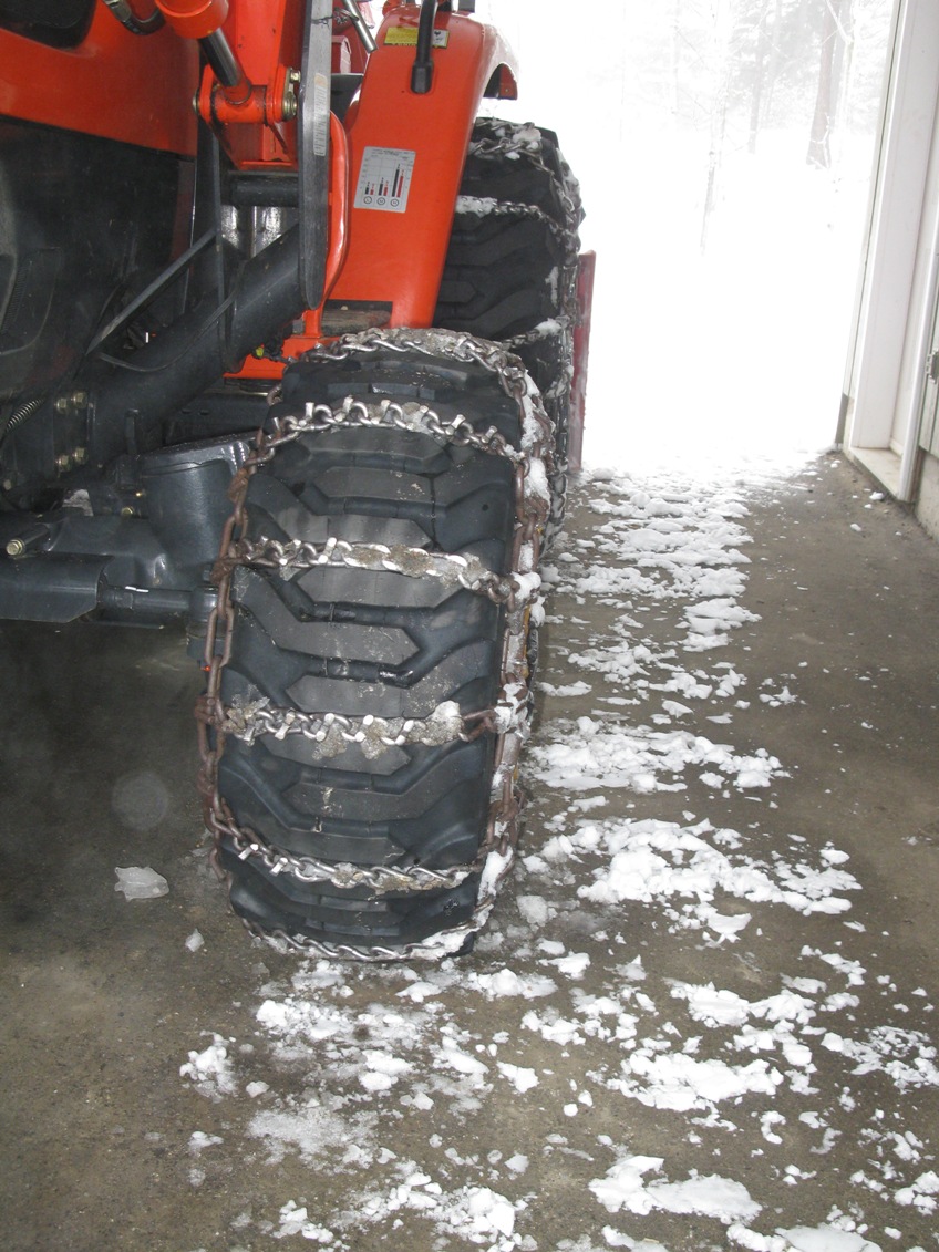

I run DUO's on my DK35's rear 43x16-20 tires with 2-link ladders on the fronts.
My fronts are 27x10-15 compared to your 25x8.50-15. I think the DUO's might be hard to fit and very rough for such small tires. However, there may be some less heavy-duty DUO's available(my rear chains are 9mm) for smaller tires.
I use smaller diameter regular 2-link ladder chains which work well and are cheaper. They also are less aggressive and don't put as much strain on the front end.
I modified an old set of chains as shown in this thread:
http://www.tractorbynet.com/forums/...nly-front-chains-post3135822.html#post3135822
Here's a photo of the fronts:
My fronts are 27x10-15 compared to your 25x8.50-14. I think the DUO's might be hard to fit and very rough for such small tires. However, there may be some less heavy-duty DUO's available(my rear chains are 9mm) for smaller tires.

Is there a local supplier you can contact? I had a heck of a time getting chains for my DK35 with R4's due to tight clearance and non-adjustable rims. Luckily, I got my first set of DUO's locally. They were FAR too large and I returned them for no charge or shipping. We then worked to get the ones I have now. I was not happy with them so tightened the pattern as shown in this thread:
http://www.tractorbynet.com/forums/attachments/268885-duo-chains-planned-modifications.html
That worked out well again with the local supplier. I was able to get the additional patterns for half the cost of ordering them online. That was a couple of years ago and I just picked up two more patterns yesterday to more completely close the end gap. I'll do that this spring. My local supplier does not actually have the chains, but we get them from another branch who does all their chain work. So I work through that branch and get free shipping as long as I wait a few days so it goes with their normal inter-branch shipments.
You may also have luck looking for skid steer chains. For my front chains, I was going to order square link, 2-link ladders as specified by CanadianChains.Com in their skid steer section. Luckily, I looked up the pattern in the Quality Chain catalogue and found the recommended chains would never have fit on my tractor. The cross chains were too long and would have interfered with the tractor frame. That's when I got the old chains that a friend had given me and modified them for the fronts. They were actually much too wide, 4-link ladders which fit on the rear but got lost in the lugs and were ineffective(so I bought the DUO's). I was able to shorten the cross chains and there were enough of them to fill in for 2-link ladders for the smaller front tires. My front chains are very worn from who ever originally had them, but they work fine for the fronts and make a huge difference.
I think the truck chains will work well for your fronts and it may be a good idea to have something not too aggressive on the fronts. The ones I modified for front chains are much thinner chains(5/16"?) than my rear DUO's (which I think are 10mm ~= 3/8").
Again, if you have a local supplier who provides rigging, chains, etc for trucking, logging, industrial users, they may be able to help. My supplier buys drums of bulk chain and makes them to order.
