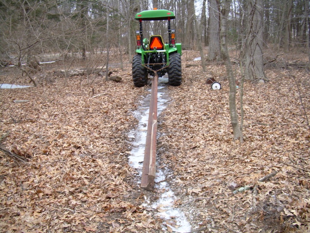

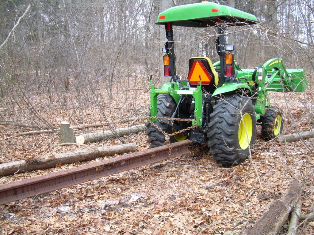

IMO, I think it's more important to follow the below the axle attachment point when pulling a fixed object like a stump or a fence post, something your trying to yank out of the ground, and is probably not gonna move on your first attempt. But if your pulling a felled log, you want to lift the front off the ground, less friction, not digging in. I suppose you could catch it on something fixed, but having the front of what ever you are pulling off the ground makes it less likely that it would hang up.

   / Where to connect a chain to pull trees/brush #23
David Cockey said:
I can't see any difference between pulling hooked to a the low, fixed hitch, and pulling hooked to drawbar between the lower arms of a 3PH IF the 3PH drawbar is at the same height as the fixed hitch. I'm assuming the pull is horizontal. Pulling from the upper link is very different situation.
I also did a quick analysis. With sufficient traction a tractor can be flipped even with the pull below the axle center if the load and torque to the rear axle is large enough. In reality if the pull is low enough there generally won't be sufficient traction, the tires will slip.
David:
You are correct that a tractor can be flipped even with a pull below the axle center.
You are not correct that there is no difference between a fixed drawbar and a 3PH drawbar.
The difference is that the fixed drawbar sold for a particular make & model of tractor has been carefully engineered so that it will hit the ground well before the tractor can flip over backwards.
There is no downward force on the 3PH -- the drawbar can hit the ground as the tractor rears up and it will just move the 3PH upwards, allowing the tractor to keep on rearing up and eventually overturn. This can happen in the blink of an eye. If fact, this is a very dangerous situation because as the 3PH raises up, the pull comes from a point higher and higher on the tractor.
I can't emphasize this enough. The 3PH drawbar and the fixed drawbar look and act exactly the same right up until the moment when things start to go south. At that instant, the fixed drawbar stops the rollover while the 3PH drawbar not only doesn't stop it, it makes the geometry even worse, encouraging a rollover.

I sure wish I had pictures of an Allis-Chalmers C I owned back in the 1960s that I used for logging. We used it to pull log sleds long distances after we pulled huge loads of logs out of the woods with our two Belgian horses.
The closest I have is this:
This is a small 17 hp tractor I owned several years ago. If you look closely, you will see a piece of chain hanging from the front "bumper" I made for this tractor. I also welded a loop under the fixed drawbar hitch at the back of the tractor. I used this little tractor to pull some huge loads of logs on 'sleds', much like I did as a teenager with our team of horses.
The chain hooked to the front bumper. It passed through a loop (clevis) at the back of the tractor. The front would dig down before the back. It was very safe.
